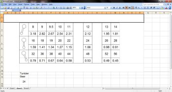

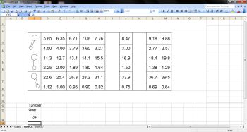

John Stevenson03/12/2012 23:16:56
avatar
5068 forum posts
3 photos
OK lads I'll show you my spreadsheet for the Myford but if it gets all over the net I'll have to kill someone.
Copy of the Myford chart, large box gives TPI, small box underneath gives mm pitch.
Only variable is the box below it with the tumbler gear.
Change the tumbler gear and all the other ratios change to suit.
John S.

Apologies to Harold for making a blind assumption on how he worked. Clearly the exact Myford gears and quadrant are needed for precise work and gears. I am intrigued by the open thinking behind imperial pitch threads on metric dimensioned items. It is that quality that creates new ideas but I guess it should cause puzzlement for a future engineer who measures a piece of his machinery and studies all the thread charts looking for the right one!
Thanks also to John (who I guess is credited with the tumbler gear change idea?) for leading me to the simple solution I sought. I have myself drawn up a spreadsheet calculating all the metric pitches to be obtained from the Myford gearbox using tumblers from 20 to 35. One error I avoided was not assuming that the Fine Feed numbers printed on the case are accurate: e.g the first and last, 0.0139 and 0.0020, are actually 0.013889 and 0.001984 respectively (shown to 6 DP).
Picking all the best fits from the table, but trying to restrict the number of tumbler alternatives, I drew up a table of tumbler gears and box settings. What interested me was the errors resulting. I reproduce the table and leave others to debate which errors are acceptable and for which tasks.
