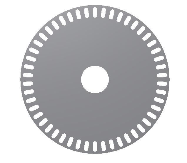

1. If I can make a 50 slot encoder disc (to keep the diameter a reasonable size).
2. Then have 2 photo electric switches to give phase A and phase B inputs.
3. Then arrange these switches so that one is set to switch at the leading edge of a slot (Phase A) and, at exactly the same time, the other set to switch at the trailing edge of a slot. (phase B) (I am very unclear on this point an how this gives the "quadrature".
4. So with 50 slots and quadrature I get 200 impulses per rev of the gear hob?
5. So to get 2000 impulses I need to gear up the encoder disc by 10 x the gear hob speed?

I am thinking of making the encoder disc with 3mm slots and using the photo switches specified by John S in the thread previously referenced. With 3mm between slots the disc come out at 107mm. I think this is manageable, 2mm slots would be better, I presume it depends upon the switches. I would rather play it safe and not get to fiddley.

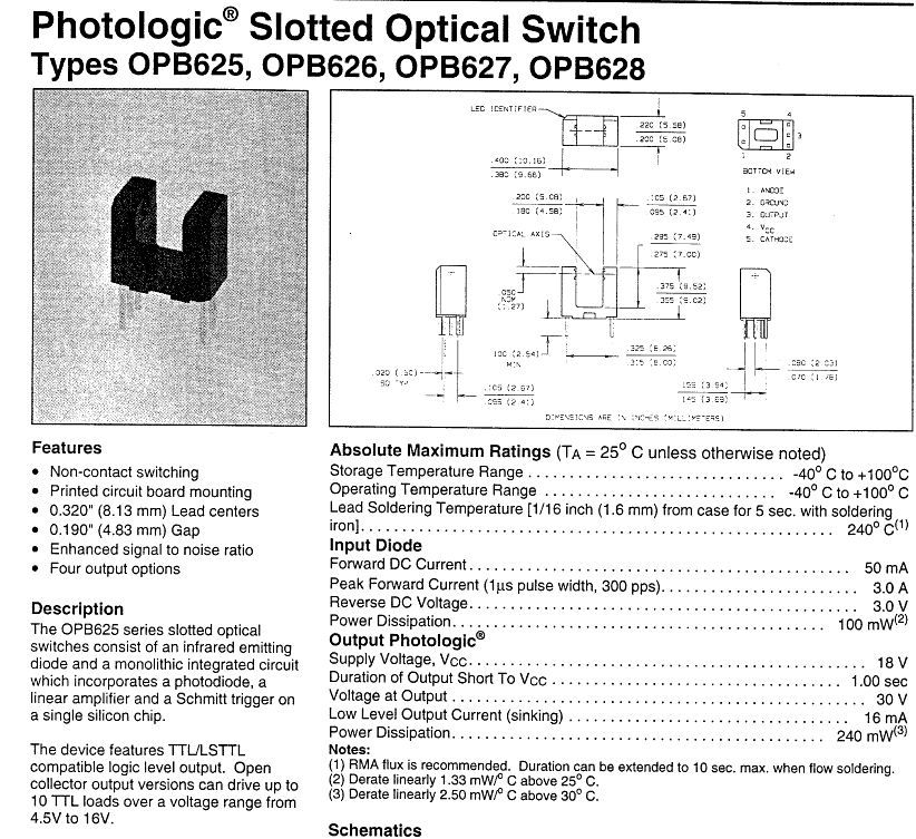

I would recomend photo interuptors with scmitt detector outputs.. (..) all the lowlevel signals are internal to the device and noise just goes away smiley
BUT IF DOING SO OBSERVE POLARITY they don't like it up 'em

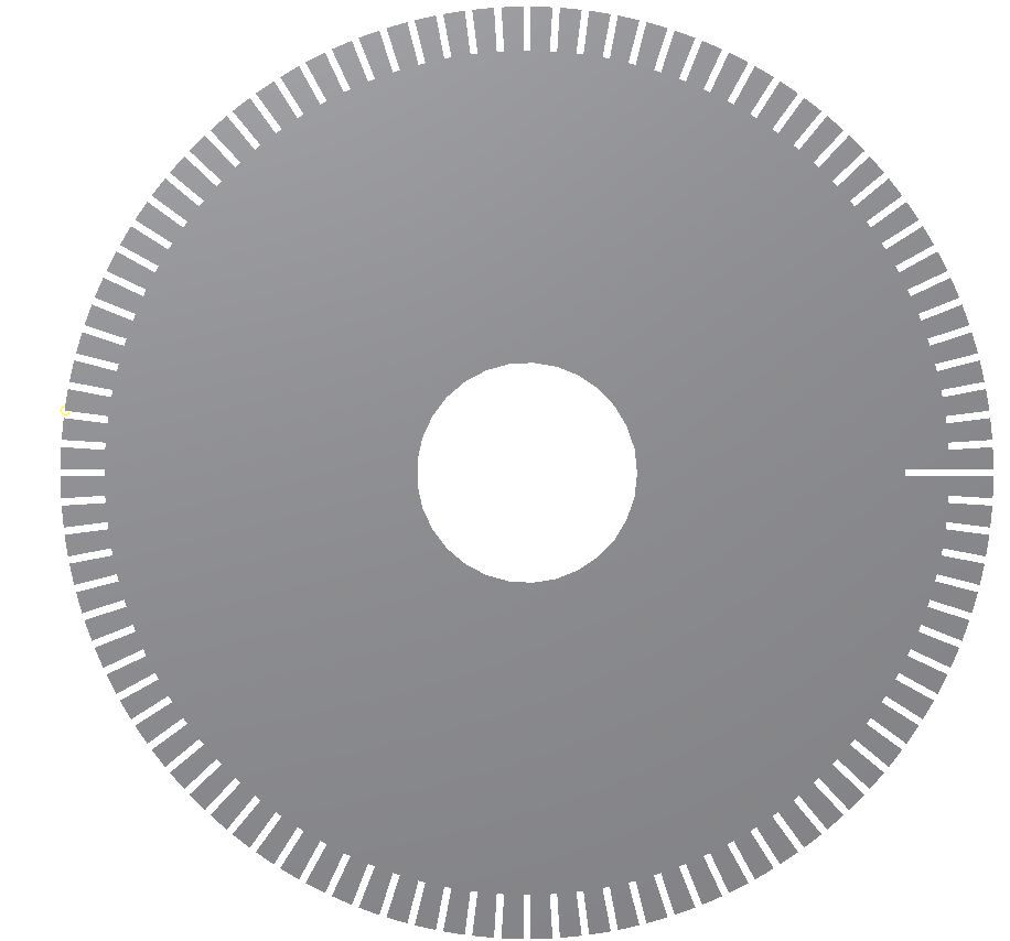

This is my latest encoder disc now at 63.5mm dia. with 100 - 0.5mm slots. Material between slots is nominally 1.5mm wide. So to get 2000 pulses I would have to gear it up 5:1.
Am I correct in thinking that so long as I place one photo switch in the centre of a slot and the other in the centre of the material between the slot I will be OK?

I thought this photo switch might be OK.

jason udall05/11/2012 15:06:42
2032 forum posts
41 photos
the 2400 ( and more ) pulse/rev. encoders use one ( or more ) of two ways .. either VERY fine (etched on glass) lines or an array of photo interuptors to give multiple pulses for each " slit" ( think vernier )
say 8 pairs in one slot spacing like A B A B A B A B A B A B A B A B.. the A outputs are combined as are the B outputs giving 8 times the resolution... this combined with etched scales leads to encoders capabile of 25 000 pulses per rev. ( eg :OHE 25 K ET which is only 3" out side the case )
other encoders use phase and quad outputs of two analogue sine waves..
any way this doesn't move you any futher forward..
50 slots is 7.2 degrees can you alighn the A B opto accurately enough to interpolate to the half slot? At say 3.6 not 3.9 degrees ?..
gears have back lash .. but an encoder on the input of a worm ( a la rotary table ) attains resolution and some how accuracy ( not thoughly convinced there) of the "gear" ratio

You need one to read the beginning of a slot and one to read the end of a slot, doesn't have to be the same slot.
Third one gives index.
This is a shot of the same machine with single slot encoder but it shows better how the whole lot can be adjusted to get all the correct angles and clearances.
John S.
