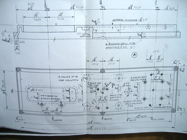

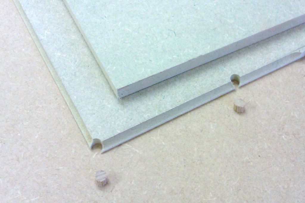

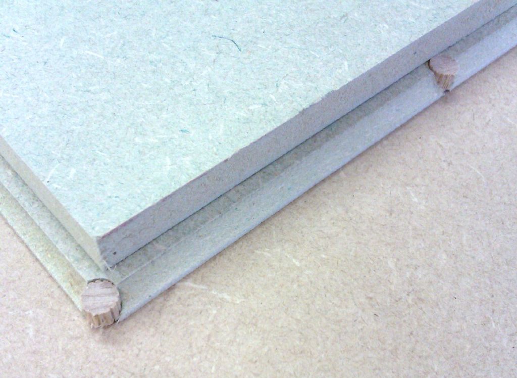

Having just had a look at the Mary drawings on Reeves site I would say making the base from two layers of material will be the best bet.
Cut the lower one to size and use a bull nose or home ground cutter to profile the 4 sides, drill say 6mm where the six bolting down holes go and JB weld in some short lengths of rod. The top layer can just be a smaller square edged plate fixed on top.

Just so we all know what Wolfie is making, here is a drawing of the baseplate found on the web

Had a suitable bit in the router this afternoon so ran this off from some scrap MDF to show what I was saying about making from two plates.
