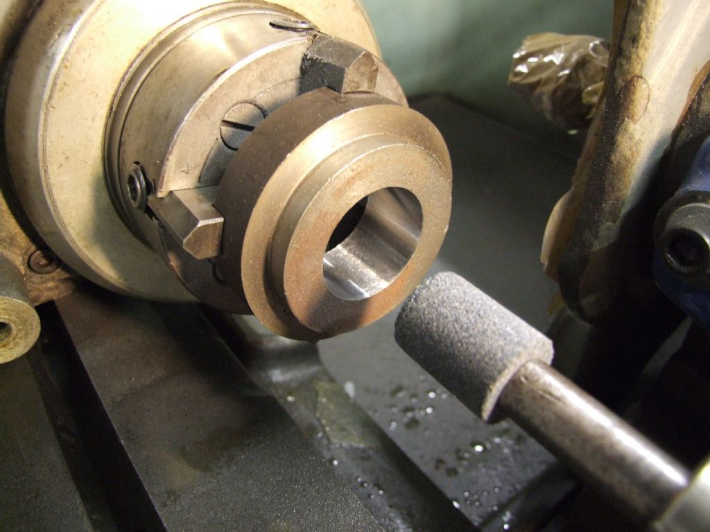

I've now got my internal grinding wheels and have had a go at internal grinding. This is the set up:
The wheel is a 60 grit regular aluminium oxide, specfied for soft steels. The test piece is EN1A from the scrap bin. Grinding was done dry.
First off I tried grinding by moving the wheel radially out, and then engaging with the hole. This resulted in a hole with a good finish at the back and awful at the front. I assume this is due to the wheel and quill flexing slightly as the wheel enters the work? I then tried grinding with the wheel starting inside the job and then moving outwards radially until it started grinding. I then oscillated the wheel back and forth, but without disengaging from the work, a bit like honing. This seemed to give a more uniform finish. Like this:
The finish looks, and feels, pretty smooth. It measures anything from 0.7µm to 1.6µm Ra. I reckon the 0.7 is about right for the grit size but the 1.6 is rather disappointing. I never quite achieved sparkout, despite many passes.
So, does anyone have any hints on internal cylindrical grinding regarding techniques, methods, expected finishes or anything else?

Ronan: Yes there should be a belt guard. I have a Myford original cast aluminium belt guard for external cylindrical grinding but nothing for the internal. It's on the list of things to make. I don't think that the internal grinding setup was original to the machine, as I had to bore out the drive pulley to get it to fit the motor shaft. How tight is too tight for the belt? Following Clive's advice there is about ±1/2" play on the belt. The belt doesn't slip on start up, so I haven't added any dressing.
Jason: Errr, not sure I follow the comment about lathe beds? My lathe is in the same room, but it's about 12 feet away. The grinder does have full flood coolant, it's just that the nozzle is fixed for external grinding, and isn't adjustable for internal grinding. I have a plan to throw the whole thing away and fit a LocLine arrangement so that I can have coolant for both external and internal grinding. I need to make a bigger splash guard too.
MIchael: Thanks for the link. As a first off I'm quite pleased with the finish, but I'm sure my technique can be improved, which is why I'm looking for any hints.

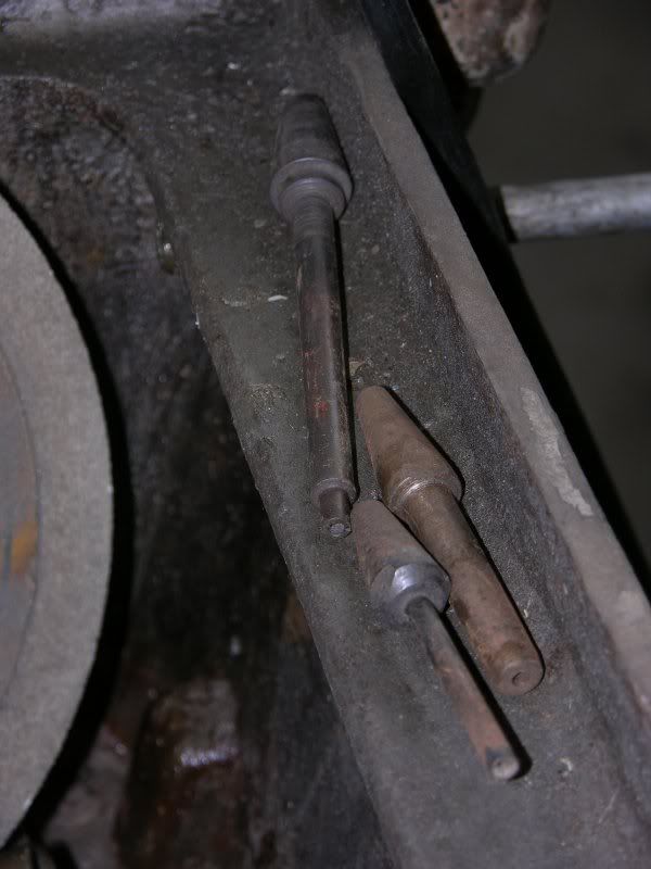

Here goes a pic of my Myford
And what I think are the internal grinding quills.
Which belts are you talking about?

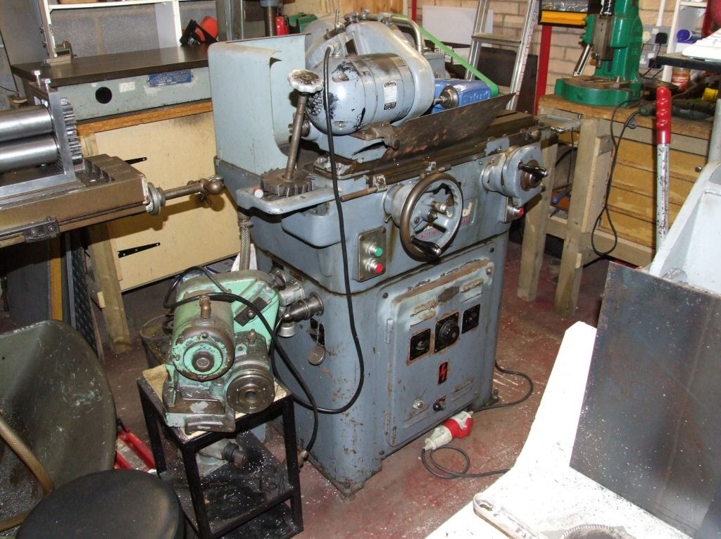

Here's a picture of my grinder, I run on 3-phase hence the red plug on the floor:

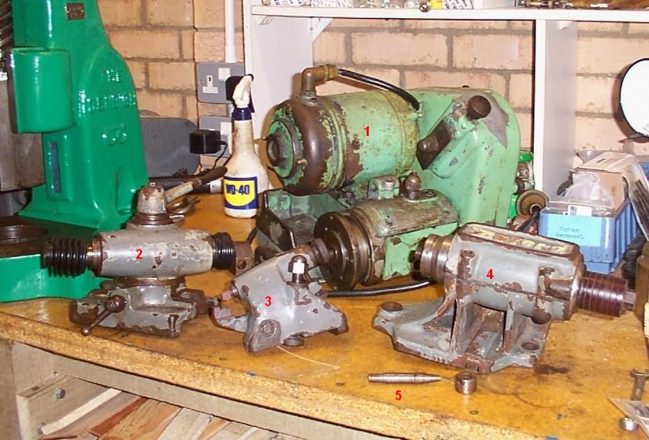

According to Myford my grinder was built in 1969; unusually I have the original manual for the machine. To the left of the machine is a small stand I welded up to hold the accessories. Here's a picture of some of the accessories that I sent to Myford to confirm what they were:
1. Swivelling workhead
2. Angled wheel dresser
3. Travelling steady
4. Internal grinding attachment
5. Internal quill and nut, which agrees with what you think are the internal grinding quills

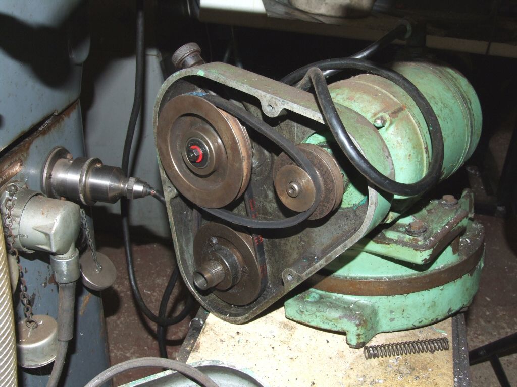

I need to move the motor position to adjust the tightness. Rather annoyingly the belt lengths are different again for the normal workhead.
