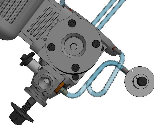

Just for a bit of fun have a play with this, hold your mouse button down on the drawing and then move it about to see the engine from any angle. Also in views, click transparent.

Terry where are you getting your 23.5 (or23.45) from? The top slope that the carb opening is in is 23.45 back from the front of the casting but the side slopes are not quite so long, I would guess at 22mm which would give 17deg near as dam it. Thats why I said we need the length or angle.

I see your point on the 23.45mm (sorry about the typo) dimension on the drawing on Alex' site but the 3d pdf you linked to appears to show the side and top slopes to end at the same dimension if you view it from above.
Firefly 3d
I have little experience of building i.c. engines and am not sure of the significance or importance of such a discrepancy,unlike that of the conflicting dimensions of the rear hole. I would be grateful for any light you can throw on this. I have a lot of respect for your experience and have been grateful for your observations on the portable engine.
