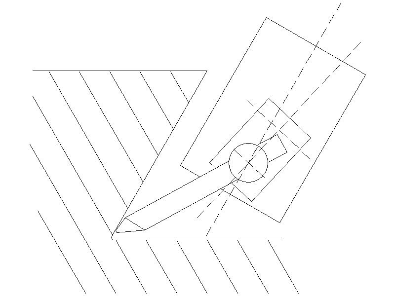

Posted by ALAN EARL on 17/03/2013 14:16:45:
is there any way to lock the clapper so that it dosnt flap on a 10" royal shaper alan
Why would you want to Alan? The clapper being free to lift is what keeps the tool clear of the workpiece on the return stroke

I've never had a shaper but I understand the clapper box lifting can be fatal if one is trying to machine a dovetail.

cheers for comments i have some dovetails & tee slots to do and have seen somewhere that you have to lock clapper i was just not sure how i will be taking tiny cuts regarde alan

In answer to Neil: Yes, if the clapper box is not rotated slightly relative to the angle of the rotatable topslide then the tool is liable to dig into the work on the return stroke. In my experience looking at the set up will tell you in which direction to advance the angle of the clapper box relative the angle of the topslide. This then results in the tool swinging away from the machined face.
Unless I am mistaken, it is exactly the same issue when machining a slot except that in that case the topslide is vertical. If in that case the clapper box is tilted in the wrong direction it wil cause the tool to dig into the side of the slot.

HI Clive,
I can imagine it may be possible, but is there still the risk of fouling teh bottom of the slot?

Hi Neil! Sorry for the late reply.
I don't think there is any risk of fouling the bottom of the dovertail so long as the angle of the clapper box relative to the angle of the dovertail is small to moderate - small enough to guarantee movement away from the angled face, but not so great that it interferes with the lifting action of the clapper box.
See schematic below (someone might prove me wrong, but my own experience seems to confirm this is correct).

Perhaps to state the blindingly obvious Alan - that to cut a dovetail the tool tip needs to be a sharper angle than the dovetail being cut e.g. a 60 degree dovetail needs a 55 degree tool tip. The recommended method seems to be to first rough out from the 'top' of the required dovetail using the shapers power feed (away from the top edge to give a 90 degree down cut). Then having set the vertical slide over (and starting at the bottom of the 90 deg edge just formed) wind up (sideways?) and in a bit before rough cutting the dovetail back 'down' using the vertical hand feed. This is repeated until the dovetail is "roughed out". The final finishing cut is made 'up' from the bottom of the dovetail and away from the bottom in the horizontal direction. So rough cuts in and finishing cuts away from the bottom of the dovetail. The clapper angle shown above is correct (and is free to move) - but obviously only the tool enters the dovetail. Cutting a slot, the clapper is either locked or a lifting device can be fitted - depends to some extent on whether the slot is closed or not (e.g. if the slot is being formed between two drilled holes you have to lock the clapper - or if the ends are 'open' a lifter can be employed). Generally the advice is to use a tool narrower than the required slot and rough out the slot first before finish upcutting the sides Hope this helps. Regs IanT PS Stll cannot use 'enter/CR' to make new lines/paragraphs - anyone know why??
