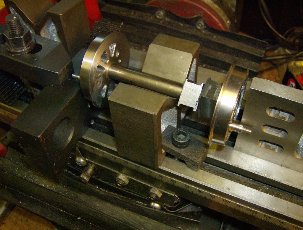

Stub Mandrel15/01/2012 20:30:53
avatar
4318 forum posts
291 photos
1 articles
Nice to see some pictures of your work Wolfie.
Here's some 'interesting' clamping - a temporary jig for quartering loco wheels I set up today:
You can see the HUGE size of a 'standard' clamping set with M10 studs at left - the clamp and three packing blocks fill about a third of the mill table! The wee clamp holding teh V-block in place has a single M8 screw holding it (my home made clamps aren't quite as pretty as yours - this was just a slice of a suitably shaped bit of scrap malleable cast iron with a hole drilled in it) and the angle plate is held by a single M6 screw.
