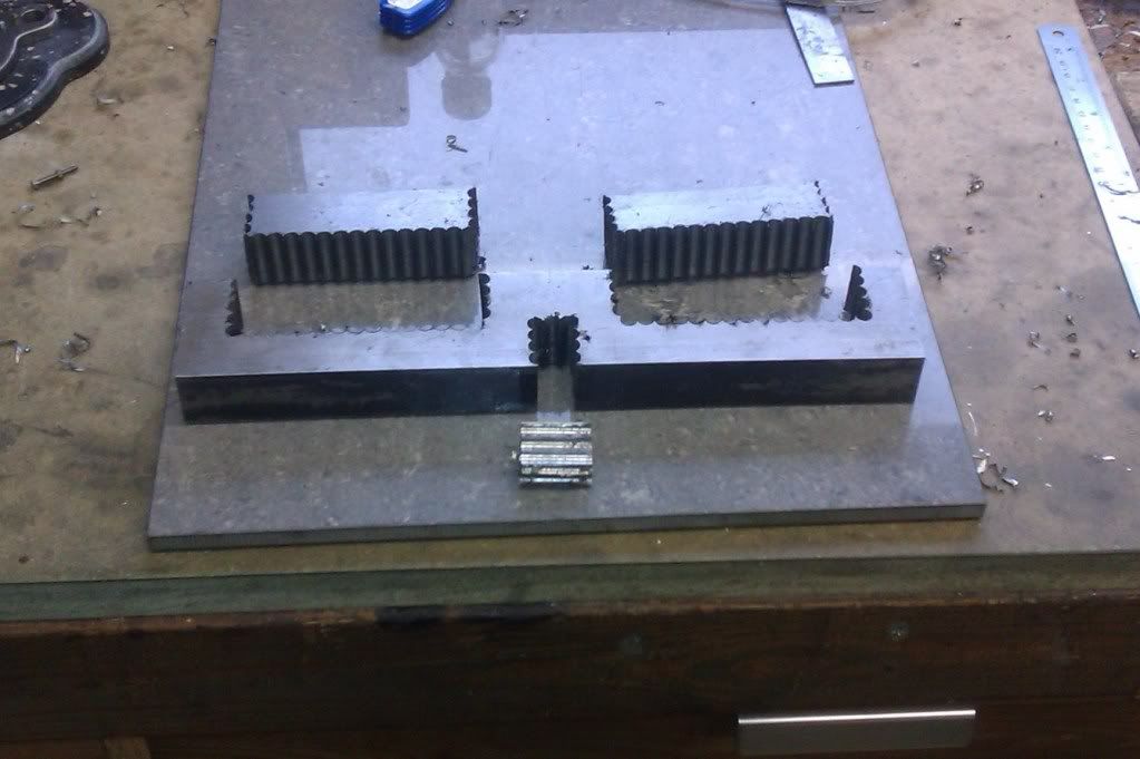

The problem with your bright imperial flat stock which I agree is readily available will be that it has a tendancy to move when the axle box cutouts are done. Thats why itys preferable to use black plate which is now only metric.

JasonB23/02/2012 17:33:00
avatar
25215 forum posts
3105 photos
1 articles
Thats it bright tends to move more than black. Holding at red heat for a few mins then allowing to cool as slowly as possible will help to stop it moving.
Bright does tend to be a bit easier to work and has nice square corners, rails sheared from sheet can have a bit of a rough edge.
Just as an example I cut this crank out of a bit of 1"x2" bright and it moved 0.040" once the waste had been stitch drilled out, I could actually see it curling apart as I drilled.There was enough to play with though so no problems.
J
