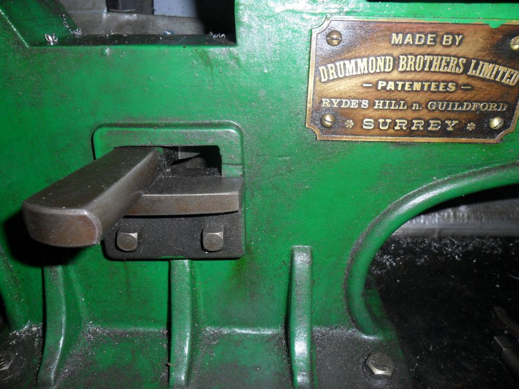

Hi Paul
Great photos . Has your lathe got a thread indicator ? Is it good for screw cutting ?

Hi Colin & Guys
I have a drummond flat bed lathe & having problems with split threads . there is only one lever to engage leadscrew . Nobby

Nobby,
I have a flat bed Drummond like yours. I have used it a lot for screw cutting with no problems. It is vital to keep the lead screw clutch ( as shown in your photo) engaged at all times and return the carriage to the start by reversing the lathe. Mine still has the treadle so this is a very quick and easy thing to do.
Hope this is of help.
Eric

Leaving everything engaged and putting the lathe into reverse is foolproof and the only way of cutting metric threads on the ML7 imperial version.

I have a S 7 Mk 1 and doing what Eric & Jon says works fine . so its worth a try . I do this using a mandrel
handle . or keep watching on Ebay
