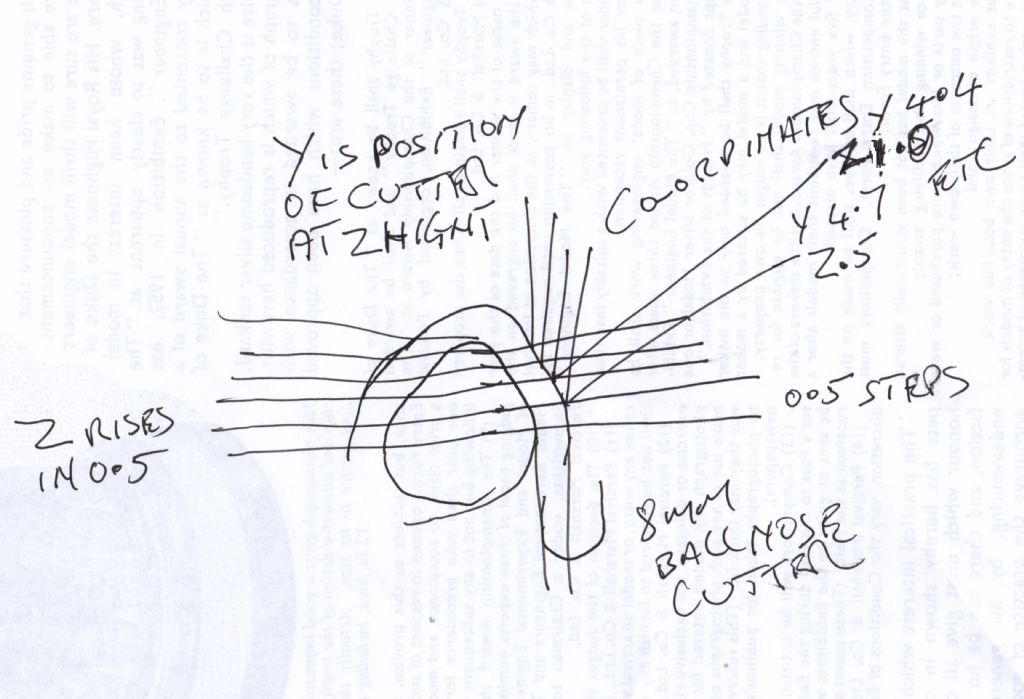

I want to machine some cam lobes on the milling machine and I seem to remember a program that gave a list of co-ordinates in the z axis relative to a radial movement. This gave a stepped profile which needed a light dressing with a file. Can anyone shed any light on this or any other way of producing a cam lobe.

Hi There
Draw the cam shape out in a cad package.
Offset the outline by the radius of a ball nose cutter.
Plot the co-ordinates at say every .5mm or 20 thou vertically.
You can then machine the entire top half of the cam then rotate the job 180 degrees and machine all of the bottom.
Sketch to follow after lunch.
regards David

Hi There
Rough sketch but the principle should be clear.
The Z height is stepped at say 0.5mm the Y is where the 0.5 intersects with the path of
the 8mm ball nose.
If you move the cutter to these co-ordinates and take a cut, you will generate the cam.
You can start at the top or bottom of the cam, does not matter which.
The path is for the centre of the ball, if working manually the Z will be 4mm lower.
If using CNC, allow the 4mm in length compensation.
