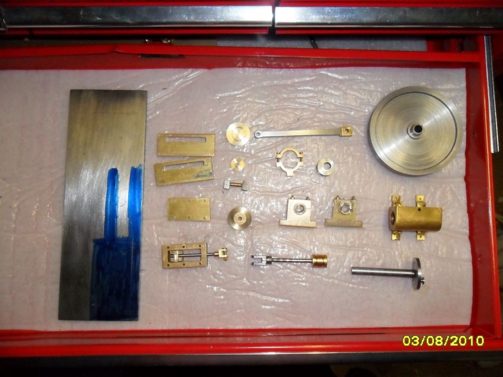

For Rob (and everyone else)
  A photo of the progress on the Suum Cirque.  I have a problem at the moment, breaking a 10BA tap in a hole on the base plate - how can I remove it?
Pete

Hello there Pete. Re the 10 Ba tap, two questions. Is it in a blind hole? What is the base plate made if? If the base plate is Brass or bronze, get some Ferric Chloride solution –the stuff used to etch printed circuits-.  Build up a little dam with wax and put a drop of Ferric Chloride into the hole and leave it overnight. Wash and repeat the dose until the tap is gone (4 or 5 days). If the base is aluminium make a small trepanning saw and cut away the metal surrounding the broken tap. Plug the hole and start again.
Dick

Many years ago on my second engine (Stuart 10V) I broke off an M2 tap in the cast iron base. The etching idea was out, since of course the tap and the iron are much the same stuff, barring the amount of carbon.. So I made a very rudimentary spark erosion setup and eroded away the core of the tap with a copper wire electrode. When I say rudimentary, the jiggling up and down of the electrode was done by me moving the quill up and down repeatedly. However, the voltage involved is nicely into the lethal range, so if you want to try this sort of thing you need to have some idea about how to keep yourself safe.
So it can be done, and I can tell you more if you are OK with that sort of stuff.

                 I do  not agree with Richards suggestion regarding ferric chloride. In etching printed circuits the ferric chloride dissolves the copper which is not what you want. If the base is aluminium electrolysis might work. If the aluminium is made the anode then it will become anodised but the steel tap should dissolve. I suggest using a small cathode positioned close to the hole with the broken tap. You would use dilute sulphuric acid as the electrolyte. Whichever method you decide to use I suggest doing a test on some scrap material first.

Unfortunately the base is Mild Steel so would probably etch at a similar speed to the tap.

I think that Dick may have the Ferric Chloride solution wrong as this will etch the brass - the technique however is an old one but the chemical should be a solution of Alum.
The other tip is valid - make a small cutter from silver steel ie this would be like making a counterbore without the centre pin. The hole up the middle sholud just clear 10BA and deep enough to go over the the length of the (broken part) tap. The OD needs to be as small as you can get away with without the cutting edges becoming too fragile but don't be too worried about this as the hole is easilly filled.
In use you need to set the baseplate up again with the tool exactly over the tapped hole and then, gently, make short plunges to remove the metal around the tap removing frequently to clear the chips . Providing you have centred the cutter accurately this will work very well albeit rather slowly.
The teeth on the cutter need not be anything special, filing them on is adequate and harden and temper in the usual way. Personally I wouldn't temper it but that's up to you.
Once you are deep enough for the tap to loosen drill right through the plate. then drill through again with the next size drill to give a uniform hole right through but do not debur the top face.You can if desired counter bore the lower face then make a small plug, shouldered to fit the CB or straight,  about 2mm longer than the plate is thick and either a tight fit in the hole or use loctite. With the plug pushed from the bottom face through about a mm peen the ends gently just enough to swell them in the hole. Mill and finish file the surplus off level. If you do his right there will be very little evidence, if any, on the top face of this having been done - that's why you don't debur the hole.
