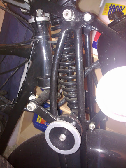

14/08/2010 21:54:44
 Hey all, I have to make three half scale versions of some full size springs I have.  The trouble is they use large diameter wire, are fish-bellied in shape and quite tightly wound for their diameter.  The large  full size one can be seen below.  Any ideas on how to make these would be great - the first one to come up with a sensible answer gets a free wish.
 The main spring is for the front suspension and the rear smaller springs are for under the seat on this:
 Rob.

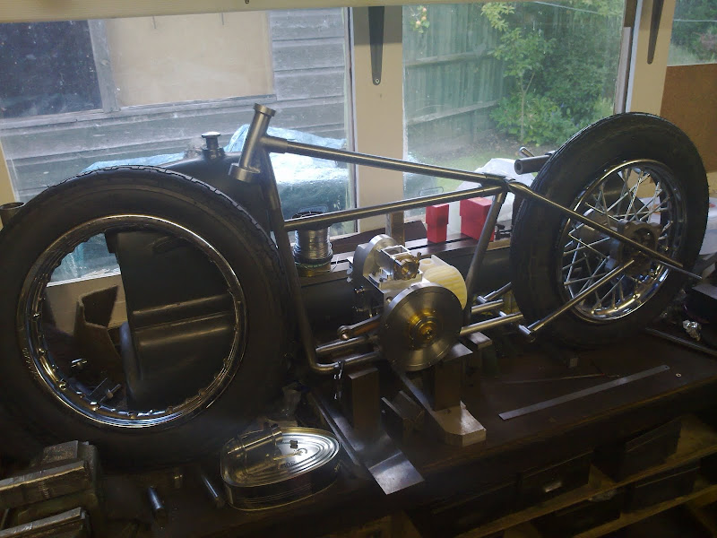

05/08/2010 16:55:36
Right, for anyone interested I have finished the half scale - fully working amal carb.  After some digging around the internet I found that cork painted with shellac is whats used.  Got some shellac but haven't done the painting yet.
BUT, I couldn't resist.  A friend had a 60cc lawnmower engine sitting under a bench so with a little adapter plate we tried it.  IT WORKS. The choke works and it accelerates well, im really pleased (don't think I can use the word chuffed here).
I still want to take some more pictures of the insides and will post them along with the descriptions to go with them asap.  You can see them here:
https://sites.google.com/site/halfsizedouglasmotorcycle/home/index/carburettor
Rob
