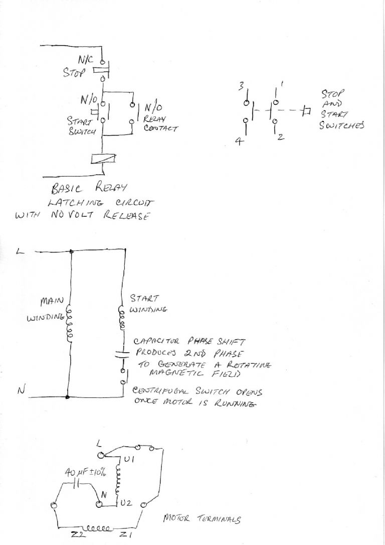

john swift 112/07/2010 11:21:03
avatar
318 forum posts
183 photos
Hi Sam ,
I don't have any machines with a single phase motor , so i can't give you exact values to measure , but I would expect the main winding to be about 10 ohms
on motors without a centrifugal switch the second winding to be around the same resistance
with a centrifugal switch about 20 ohms or so
with a multimeter on the high resistance range the capacitor should be shown as a low resistance at first , then climb to tens of meg ohm as the capacitor charges
to test for the odd shorted turn you will need some thing like the ring tester as in
silicon chip magazine a few years ago.
more expensive multimeters  will measure the capacitance
unless the green's have stopped the sale of all tungsten gls bulbs in your part of the world
you could try connecting a 15W or 25W GLS bulb in series with the capacitor
I would expect a low wattage bulb to light , but not a full brightness
that way you can test it's not short circuit at mains voltages ( it may be OK at 9v from a multimeter)
without the circuit diagram i can not be more precise
If you need more help send me the circuit diagram and a hint as to what test equipment are using  and I'll see what  else I can do
                            John Swift

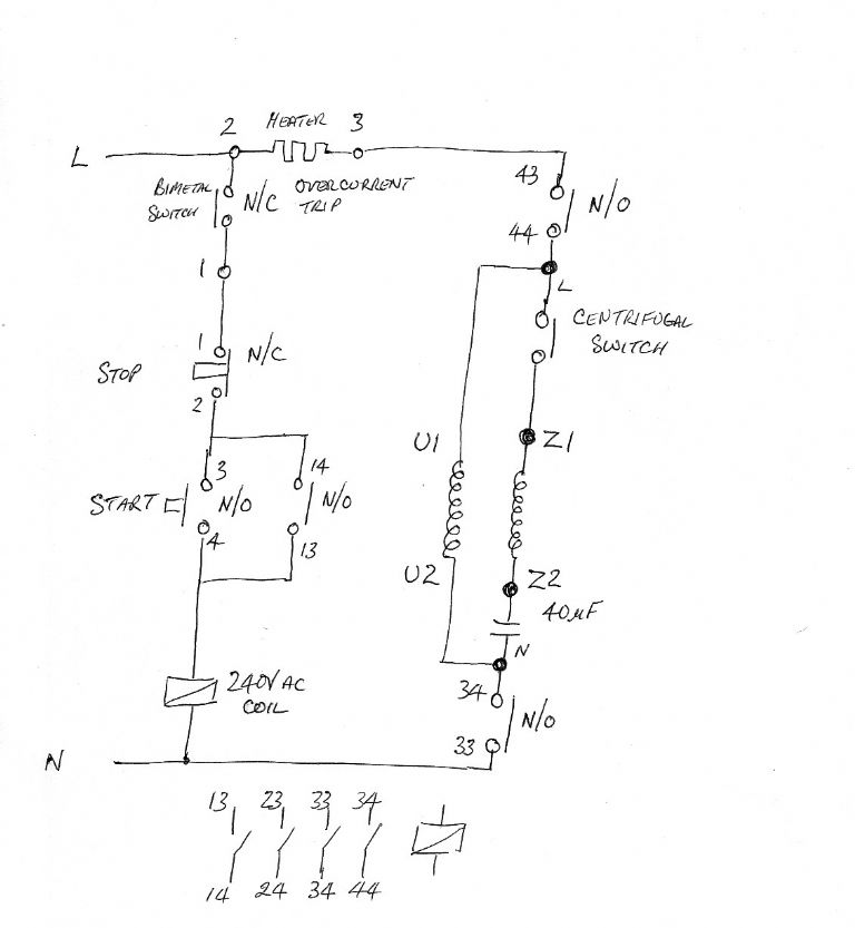

joegib14/07/2010 10:18:59
154 forum posts
18 photos
If it's of any help this is the electrics diagram from the manual:
(Click on image to enlarge)
I should say this is described as the lathe motor circuit/control system but since the mill motor set-up is not separately shown, I believe the latter is exactly the same electrically.
The full manual is available from the Prazi Yahoo newsgroup here:
in the 'Files' section --> 'BF400 Manual'. Unfortunately, to get access you need to join the group and that can be a problem. The administration of the group is unreliable so it may take a week or two for the membership to be registered. It can take that long for a post to appear!. But it's worth trying so as to get access to useful material.
I'll leave it to the electroheads to comment on the implications.

john swift 115/07/2010 03:01:24
avatar
318 forum posts
183 photos
Hi Sam,
I have scanned a few quick diagrams I hope will help
If the contactor operates when you push the start button
the overload cutout must be closed
a fault in the connections  to the contactor terminals 13 & 14
 or the contact is self would stop it latching on
with the mains disconnected you can push down on the top of the
contactor and check you have a low resistance when the contacts make
and across terminals 2 &3 of the overload unit  - the heater coil should be low resistance
 at the motor terminals check the continuity of the windings and the centrifugal switch
If your meter can check the capacitor is 40 uF
you might end up substituting it with a new one to prove if it ok or not
with the mains on the full mains should be across the motor winding U1 to U2
                                                                  John Swift

Nicholas Farr15/07/2010 12:34:43
avatar
3988 forum posts
1799 photos
Hi, the circuit diagram that Joe has posted for his Prazi is exactly the same as printed in the user manual that I have for the Hobbymat BFE 65.
Regards Nick
Nicholas Farr15/07/2010 13:31:57
avatar
3988 forum posts
1799 photos
Hi again, the black circular gadgit that you mention is e1 on Joe's diagram and is a thermal over load that takes at least 10 seconds to reset acording to the user manual instructions.
regards Nick.

In my friend’s workshop yesterday, tests of the electrical component of the BFE 65 mill revealed several issues and anomalies. Before I continue however, I have to thank again, those ME members who, through this thread, have offered their comments. In return, I trust that the following details may be of help to others with similar experiences.
A couple of theoretical (possibly trivial) aspects are noted, such as :-
a) The circuit diagram show the capacitor’s value as 8mf/460V~ while the actual capacitor is rated at 40mf/320V~. I’m told that a larger capacitor may improve the motor torque a little.
b) The circuit diagram shows the motor rated at 220V which immediately drew suspicion from my friend. Whenever I’ve measured our domestic supply, it has been a healthy 250V. However, the tiny motor indicator plate displays 240V.
The 40mf capacitor passed every electrical test, but started to heat up when the motor was placed directly across the mains for a few seconds, (ie bypassing the START/STOP contact breaker circuit).
The motor’s insulation to earth via a high voltage test meter got an "OK!" when it showed a very high resistance.
Using a current meter around single (input) wires in the motor terminal box, motor current on the two windings measured about 7amps and 5amps. We didn’t try to identify which winding was which.
When the motor was removed from the gear box, the shaft could be spun by hand with no mechanical resistance. In fact, it turned very smoothly. Thanks for the warning about the loose key Joe! As you might expect, Murphy placed it face down, but we were ready.
Applying mains as before, we could also hear a centrifugal switch responding to motor rpm, dropping out as it approached running speed and then back in again as it stopped. This latter issue appears to conflict with the circuit diagram which doesn’t show this switch. The presence of amperage on both windings while the motor was running suggests that the centrifugal switch is ineffectual, or for some other reason, the capacitor remains in circuit.
Was this why it began to heat up?
We didn’t get around to John Swift’s suggestion of testing the solenoid `latching’ while the motor was disconnected. However, I tried it myself this morning.
More disappointment!
It wouldn’t latch and instead, I could hear the pulsing (mains frequency) groan I mentioned before.
Prognosis -
1. Probable shorted-turns in the motor.
2. An unexplained fault in the starter circuit.
