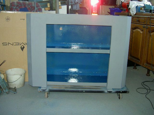

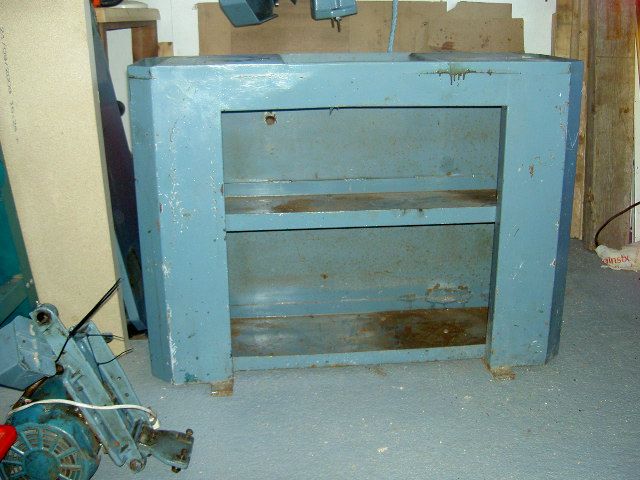

Hi, I'm rebuilding an old Boxford lathe and want to paint it in it's original colour (blue) but so far having trouble locating the right paint. I've attached photo of lathe showing what I think is the right colour, and would appreciate any help with this. Thanks.

I simply asked Boxford and got the answer for my lathe of 1950's vintage as
British standard 381C - 692 'Smoke Grey' (see here)
This is rather a bluey grey that looks more blue than grey in certain lights and in Photographs.  I think that your original colour is the same from looking at the base but couldn't swear to it.
I spoke to the guys at Boxford and they tell me that the paint they used was a cellulose one after filling the castings with body filler.  I have had the lathe for quite a while now and am hoping to refurbish it sometime in the future but need to get some paint mixed at a local dealer but it could be expensive depending on their minimum order.
Here is a picture of my lathe (and it really is the original colour!):  Mail me if you need more information.

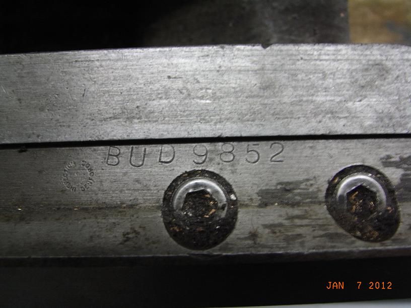

Early Boxfords were painted Smoke Grey BS 381 692. Companies such as Johnstone's Paints (normal caveat) can make it up for you at little relative cost. You need to look up the serial number stamped on the RH end of the bed to confirm the manufacture date, Look up here

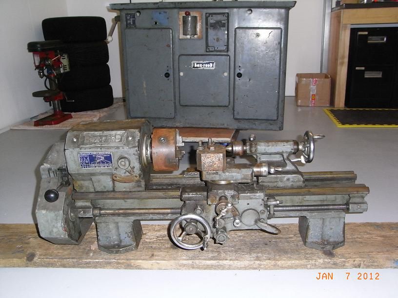

I just had to got out to the garage and look, here's what I found:
And this is what I've got to play with :

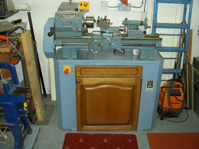

I would agree with the other comments re the yahoo site. I'm still collecting bits and pieces for the lathe to make life easier. I converted it to thyristor drive, thus giving me variable speeds, and easier than changing belts also fitted an emergency stop. I've attached some pics of the lathe as it is at momement.
Regards, Mike

Bl**dy hell, Mike!
Wooden cabinets? Carpets? Spotlessly clean surfaces?...
So where's the microwave and cooker hood?
I'm only jealous
Martin.

It's looking very good, My csb which was caught up in a fire is awaiting attention and I'm just repainting a late model CUD but adding a powered cross feed so it really is now a BUD. I'll add some pictures when I can but I can't guarantee any wooden doors. Well done so far, I'm jealous too

Funny you should mention cooker hood, I re-fitted our kitchen for the "management" and used most of the cabinets and worktops to fit out my workshop, there is a cooker hood with an extract fan in it, I'm sure it will come in handy one day. The reason for the door on the lathe stand is because there is quite a large dent in the front, above the internal shelves of stand (which I could'nt pull out) and the door was a perfect fit. As for a microwave I'm arranging for a meals on wheels delivery service with (you've guessed it) the "management".

All that bling puts my little workshop to shame but why not recycle especially when you have the bits to hand. If you are going to expand into silver soldering, welding and/or brazing then I can think of a good use you could put that cooker hood to.
When I am in the workshop I usually get tea and a biscuit between 4 and 4:30 if I have earned enough brownie points . Mind a new kitchen should keep you going in comfort for a while!!
Looks great and don't get it too dirty.
