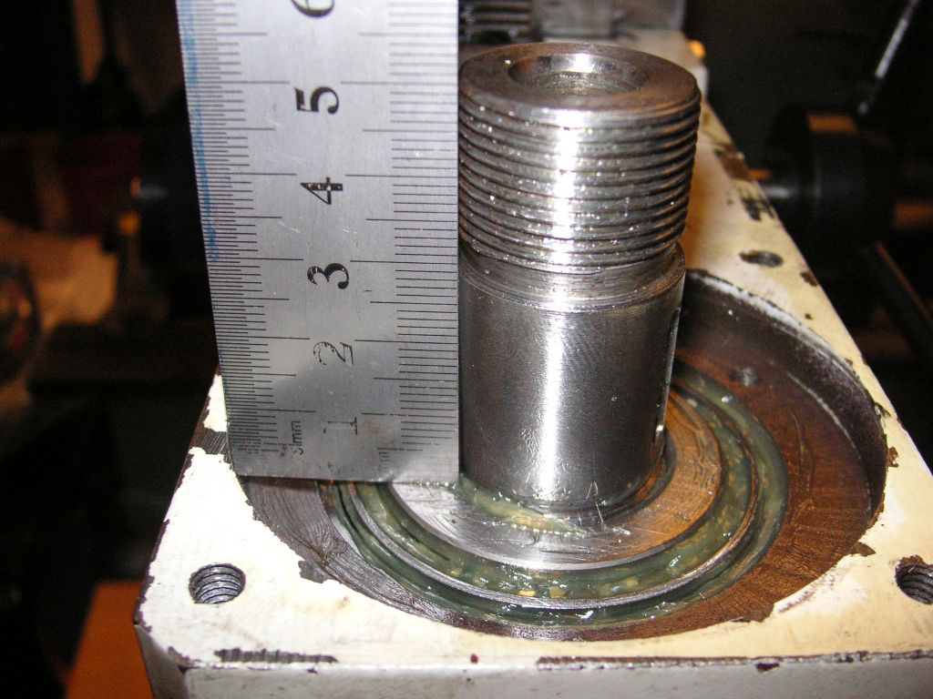

Very easy and straightforward to strip down this little machine.
But here on the gearwheels both on the motor ( metal ) and on the spindle it is bone dry ! Shouldn´t it be a little grease here or something ? I think so.
I´s a little bit hard to se here on this picture but i know WHY the fine feed doesnt work , that´s becouse the gearwheel we se here on the picture doesnt have any spline or loctite or nothing that stick it to the other part. So when i turn the finefeed wheel with my hand nothing happends beside with the finefeed gearwheel. Nothing else happends so ofcourse it will not work - how did they think about this in the factory ? Did they think ?
But this will be my second problem and some splines will probably fix it up.
Spindle out.
Last ballbearing part removed.
This is what i got for about 2 hours of work.
My first reflection is that the manual say the bearings should be :
2 pieces of 6206-RS and 2 smaller 6001-z
But what i got was :
6206RZ upper left on picture.
7206AC upper right on picture.
2 smaller 6001 2RS.

Hi Marcus,
Not necessarily in the same order that you put...
My machine had exactly the same bearings as yours, not as in the manual.
I haven't looked into it, but I have a suspicion that headstock bearings for the C3 lathe may be the same - see Arc Euro Trade website. If I am correct, then I seem to recall Dave Fenner changing them (on the C3 that is) and describing it in MEW somewhere.
Now, I notice from your photos that the bottom bearing (7206AC) has come apart during the disassembly. Mine did not, ie the complete bearing came out with the shaft. However, a friend of mine has the same mill, Warco MiniMill, and only last week had to replace his gears. Just like you, his bottom bearing came apart. Now, I am not an expert, but it doesn't seem right to me that these bearings should come apart like this. They are, after all ball bearings and I thought that once assembled they should stay assembled. I am aware though, that on bicycles that various ball bearings do in fact dismantle quite easily, but I think these of ours are meant to be sealed. Anyway, if you do succeed in changing to taper rollers then please let us, especially me, know because when my gears next break, I will wish to change them.
You comment on a lack of grease. This is exactly what my friend found, but I do not remember on mine.

"Now, I notice from your photos that the bottom bearing (7206AC) has come apart during the disassembly."
The 7206AC is a angular contact ball bearing , they are "open" , a little bit like taper rolling bearing.

Today I mounted the new bearigns the postie got me some days ago , i mounted the SKF 30206 Q taper rolling bearings , they fit perfect.
It is possible to use the little higher 32206 Q , but then the spindle comes a few millimeters lower and the uper bearing dont get more than 70% contact with the spindle on the upside.
The 32206 can handle more load than 30206 but 30206 is way better than thoose bearings the mill came with from the factory.
It is very easy to mount 30206 bearings on the minimill / X2 clones , 30206 has the same inner and outer diameter as the factory mounted bearings.

This is how much is left of the spindle with the SKF 30206Q Taper roller bearings mounted.
