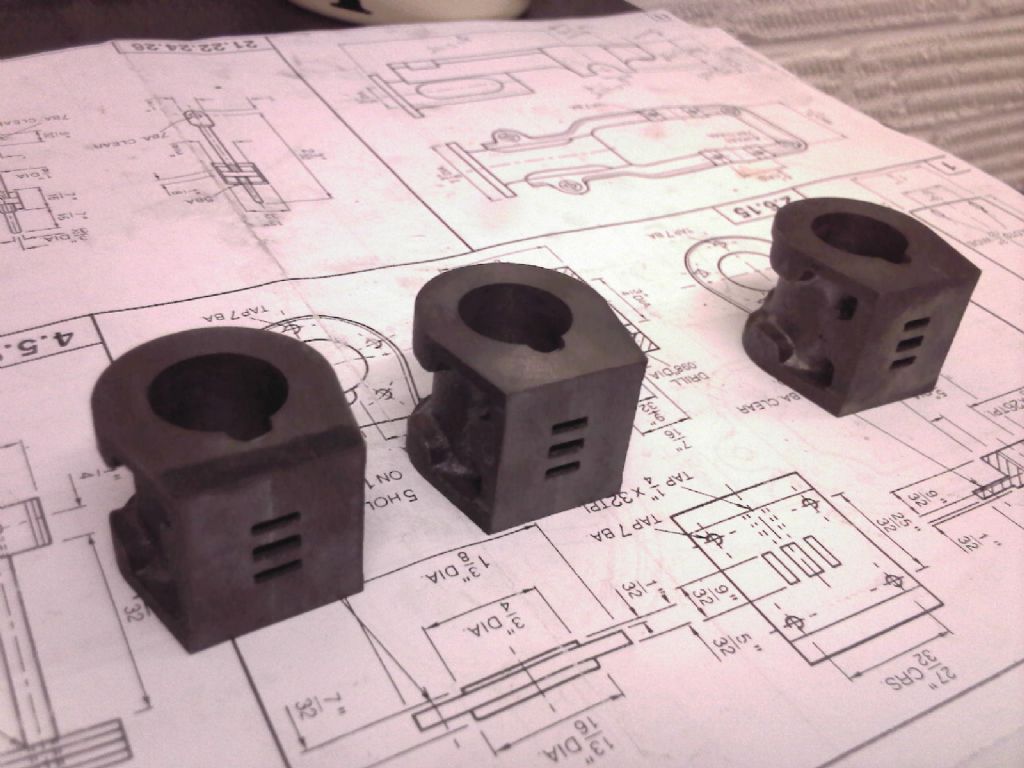

No problems facing and boring the cylinder, set up around the outer edge with scribe block. just used a small vee block to spread the load on the webs - maybe some packing would help to prevent any marks
milled the steam way then set to the required angle and nipped in the vice, centre drilled and then drill through to ports
The three cylinders so far.......

Hi David, when you come to fitting the cylinders to the frame bed...if the pitch circle dia. on the drawing is used I think you will find it very difficult to fit the nuts at the back of the cylinders...This is the ''Score'' I am referring to, I really would like the pitch circle increased a bit on the drawing...I made the mistake of following the drawing and had one heck of a lot of ''fettling'' to do plus had to use ''one size smaller nuts''...lucky not to scrap it.

Might be worth checking that all the machined faces and the bore are square and true to each other David, boreing using the 4 jaw to hold the cylinder may be a bit suspect. Hope it is true.

The rough casting was set in the four jaw and set to the rough cast outside edge using a scribing block then the front edge faced, followed by the bore (without moving from the chuck) this ensure the front face which bolts to the frame is square to the bore.
A mandrel was then made to fit the bore - size for size (just warmed the cylinder with a hot air gun to shrink fit) then the outer face was turned
The cylinder was then bolted to my face plate on the milling machine to square off to size the port face - will have to find the photo's

Many thanks lancelot for the tip RE: "fitting the cylinders to the frame bed" will check the PCD - thought I'd make the cylinder covers first then drill tapping size through with the cover/cylinder in place then open cover hole out to clearance size

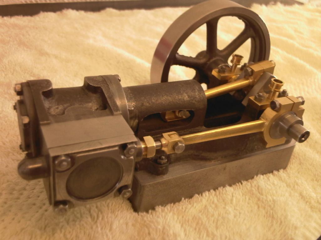

Nearly finished
made the eccentric up in the 3jaw
Just some fit and finishing now
Valves - Drain cocks and some pipework next and then the hardest part (for me!) how to paint and finish off - any help most welcome
