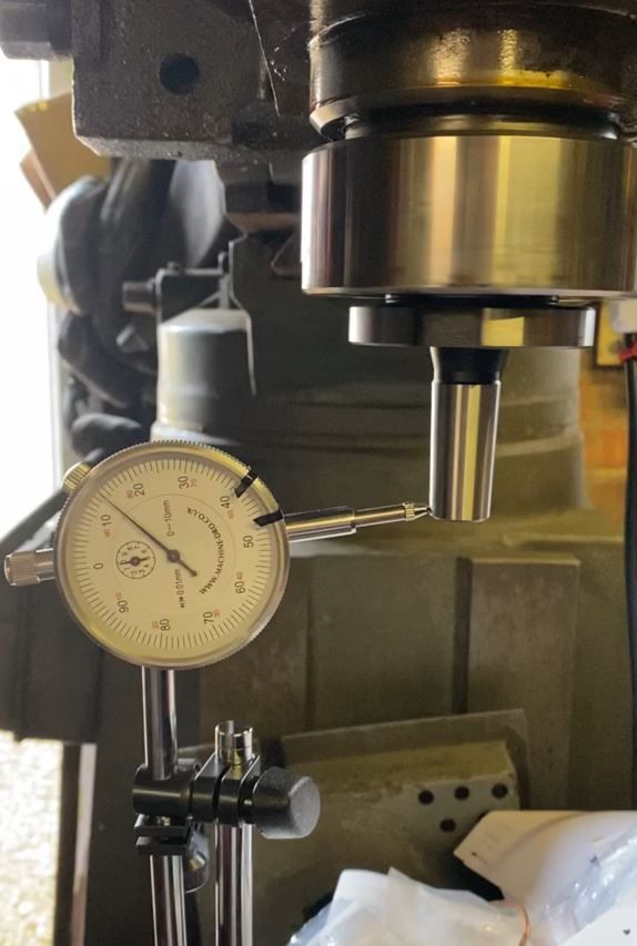

Hi,
Have a question, I am new to milling but got myself a 2nd hand mill and just bought a new Arbour and Drill Chuck for it. Before joining the two together I put an indicator dial on outgoing shaft of the arbour while in the mill rotating. The "play" in the shaft was about 1.5mm. I tried to reseat the arbour a couple of times but 1.5mm play was the best of all three times.
Would you say this is not bad "play" for a £50 arbour ??? or should I return it and ask for another one?

Hi guys - sorry yep its a INT40 in a Beaver Mill. Give me 2mins will try and post a photo of the dial.
Antony Harding16/09/2023 20:13:08
27 forum posts
7 photos
Hi, so hopfully i am readying the dial correct... the movement is from 0 to 15. I take that as 1.5mm.
Will see if i can get a screenshot of the "set-up" i done.

Each small division round the large scale is 0.01 mm as is printed across the dial. So that's 0.15mm TIR which isn't bad though not wonderful.

Yep 0.15mm whch is still not that good,
Put the indicator into the spindle taper and see what that reads.

I throught as the dial noted 0 - 10mm each "10" was 1mm. I take it I was completely reading this incorrectly.
The internal face of the INT40 and the arbour face look fine, I cleaned them and wiped them down with cleaner to get rid of any oils.
Would you agree its best to send this back and ask for another arbour ?

I think you have probably ‘got it’ now, Antony … but the 0 - 10mm reference means the total travel is 10mm
… The little dial counts rotations of the big one.

On the left is "mm 0.01" that is what each division measures.
The "0-10" is total travel. Each complete turn of the needle will be 1.0mm and for each of those rotations the small "clock" upper centre will count upto 10.
Was there any tooling with teh machine a sthat would be something else you could clock and compare results with.

The new arbour has probably got centre holes at each end. Is there any way for you to set it up between centres, such as in a lathe, and check if it is bent? I ask this as the usual reason for changing arbors when I was at work is because someone swung a large radial drill around and clouted a vice with a drill chuck. The neck of the arbor was the weak spot that bent as a result. I would assume a new arbor without any obvious bruising is not going to be bent and that the spindle is likely the source of your runout, especially since you have tried different positions and got the same result.
The other thing to do is when you measure the runout on the end of the arbor mark the high spot on the arbor and the spindle Then see if it moves with the arbor when the arbor is tried in a different position or stays in the same place on the spindle.

You must have other holders that fit your machine, put one of those in and see how far out that is, also have a good look at the taper in your spindle, all it needs is a bit of swarf embedded there and surprisingly in industry where your machine most probably came from the operators don’t always look after machinery as men in sheds do, also if you have them remove any spindle drive dogs, the arbor slots can be undersize and catch on the dogs causing a runout.

This is what I would do first. Turn a centre in your lathe chuck and then put the new arbor between that and the tailstock centre. Put a dial gauge on the wide part of the taper and turn it by hand between the centres. If there is runout the part is bad, if none then the spindle needs looking at.
