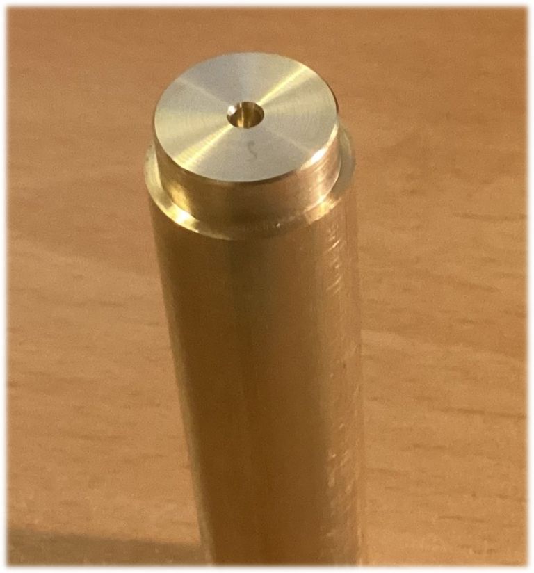

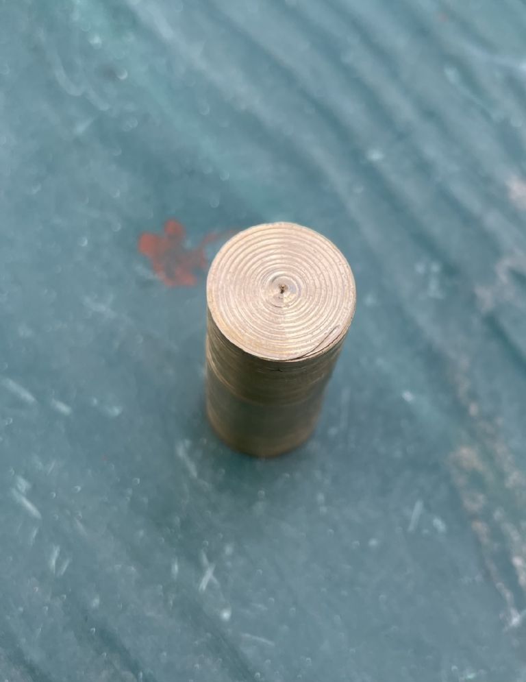

img_5582.jpegimg_5581.jpegMy friends - HELP!
Not sure what is going on but I am getting excessive cutting marks - chatter!?
I love a good natter but not this chatter! It’s driving me mad! Everything seems to be tight: the cross slide and compound are tight but moving freely. The gib is tight(ish) on the compound. The tools are fairly new - carbide inserts and HSS are giving me the same results.
Any ideas please? The thinner brass stock is hopeless to turn - it’s bending when the tool is applied. Even facing is giving me rings!
The only tool which cuts without leaving marks is the parting blade. But that isn’t moving right to left.
I am so frustrated! (Using the original tool post from the lathe - as I can’t even begin to think about machining a new stud for the QCTP until I get this headache sorted.
Thanks

What type of tool are you using HSS, Carbide, shape.
Is it on ctr height. The pip left in the middle suggests not
Is it sharp?

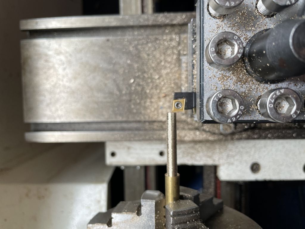

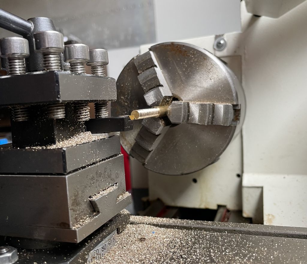

img_5588.jpegimg_5586.jpegBoth types give similar results Jason. The tool looks centred - please see pics.

There could be a number of things here
1) Tool needs to be very sharp for brass
2) Best practice says zero top rake (top edge of the tool should be ground flat, not tilted back like your knife and insert tooling is. That said I have never had any problems with using "standard" tooling for brass.
3) Your work is a long way out of the chuck unsupported, this is defintely not going to help. Either get it much closer to the chuck of use a centre to support it.
4) It could just be "bad" brass, some just don't machine well
5) Centre height is critical as this does affect rake if it is above or below centre. I still use the old trick of pressing a 6 inch rule between the tool and the work (not under power). It should be vertical if the height is correct,

I would use the insert holder that you have but get one of the inserts intended for Aluminium and other non ferrous metals Yours looks like a CCGT 060202 or 060204 would suit. The CCMT that you have can be a bit blunt even when new due to how they are made

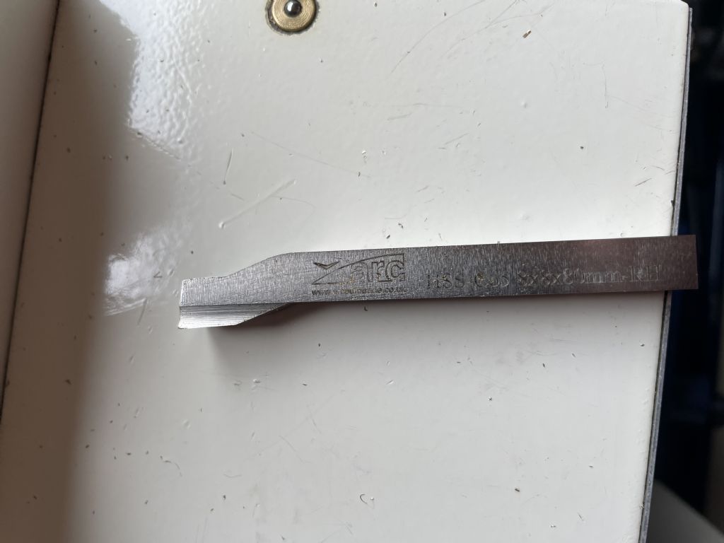

The HSs one just wants the end rubbing on a Diamond slip to sharpen it up a bit but I'm not keen on those preground ones with the chip breaker groove
The pip (but sticking out) in the middle of the faced part is a good indicator that you are not on ctr height

The coarse groove on the end face is by too fast feed.
I've never had much luck with the rule technique as it seems to demand looking at the lathe from just the right angle. I point the tool at a centre, and use the facing behaviour to verify the (HSS or carbide) is on centre-height.
The work's projection is too much, especially on such a slender diameter. Best to support the outer end on a half-centre, though on some lathes (such as my Myford) that can lead to the tailstock and top-slide in each other's way without turning the latter partially round.
Try using a fine power feed, too, if that's not what you're doing anyway.

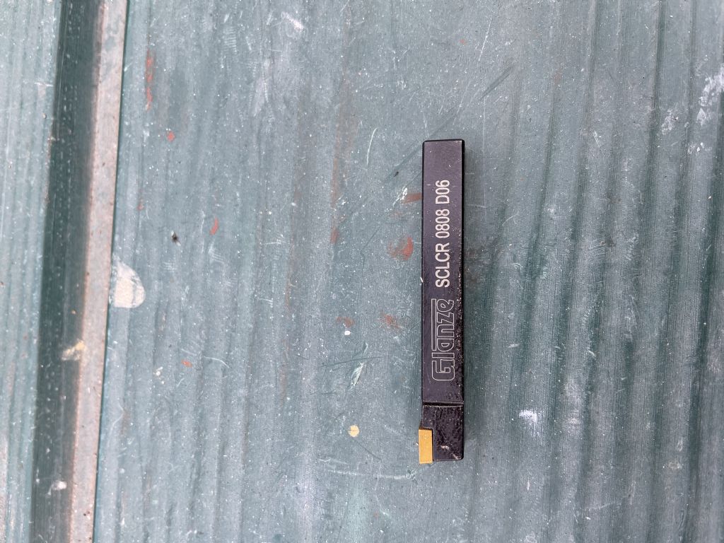

img_5589.jpegThanks guys. Appreciate your help.
Jason - this is the tool - which of those inserts for non-ferrous would fit? I’m not familiar with the coding and how you match up inserts.
thank you!

Either of the two will fit your holder, the ones from APT have a smaller corner radius of 0.2mm and are what I tend to use, the ARC ones 0.4mm as they don't do 0.2mm.
This shows the ruler method, don't press a carbide tool too hard against the ruler as they are a bit more brittle than HSS.
Then facing a bit of brass, no pip and a reasonably good finish. Too much stick out really on the piece of 6mm dia brass that follows but still gives a good finish once I get it into focus. That's an 8mm Glanze holder I'm using so the same as yours with the APT inserts, the link is to a pack of two which will be enough to give you an idea of how well they work and can be use don all metals.

Both tools Margaret is using should be OK on Brass, though the sharp silver inserts are much better.
Rule of thumb, an unsupported rod shouldn't protrude more than 5 times it's own diameter. Beyond that the cutter pushes the work away, and chatters. Note that a blunt insert has to be pushed harder into the job before it will start cutting.
The Brass is a suspect. Though most Brasses machine well I have a rod that doesn't!
Centre height is important, especially on small diameters. Too low and the cutter tends to dig in and chatter.
Here's a photo of tool height being checked with a steel rule. The cutter is wound gently to nip the rule in place. When the cutter is too high the top of the rule tilts away from the operator. If too low, the top of the rule tips towards the operator. When the rule is vertical the cutter is exactly right.
I suspect all these factors have come together to spoil Margaret's day. In order, I'd:
  1. Set Centre height
  2. Reduce how far the rod protrudes from the chuck to much less than 5x diameter
  3. Try a sharper insert (or sharpen the HSS)
  4. Try a different Brass - though it's probably OK
There are other possibilities, such as bell-mouthed chuck jaws, but deal with the most likely first. It's possible that steps one and two will fix it.

Like Jason, I'm not that keen on the pre-ground deeply grooved HSS tools for facing or turning, though they do the job well enough when kept nicely honed.
Try having a look at Tom's Techniques.
He has some print-offs [under "reference"] on grinding HSS lathe tools, as well as videos. The first tool I ever made was his facing tool, which gives nice results in brass.

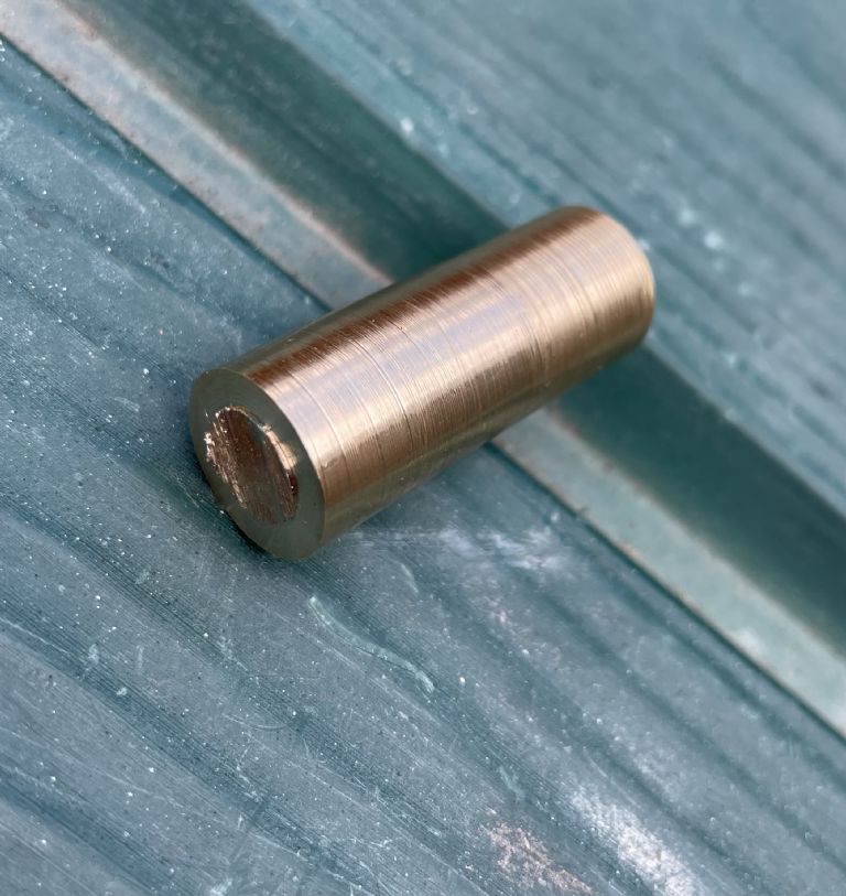

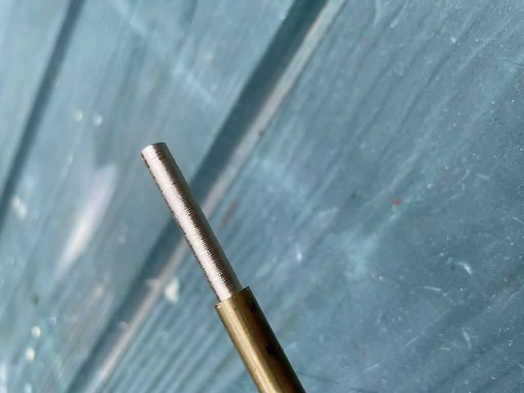

Margaret Trelawny27/08/2023 11:23:42
100 forum posts
42 photos
Chatter 2
Morning everyone, my machining marks continue.
To recap:
1: I have checked the centre height of the tool - it looks apot on.
2: purchased a piece of CZ121
3: purchased the tool tips recommended from APT.
4: feeding the cross slide with both hands (which has helped).
But, although an improvement - I would say I am far from happy with the results so far. The facing off is better after the second pass, but the turning isn’t.
Any suggestions where I am now going wrong please?
