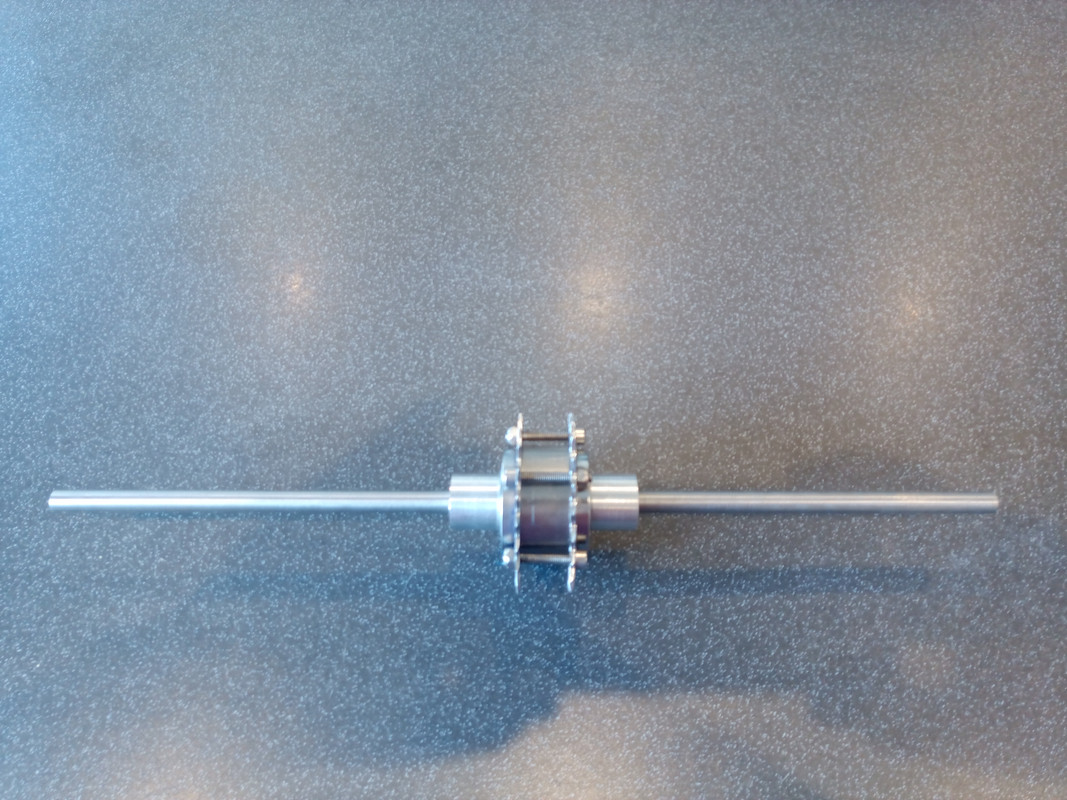

The biggest problem I have is the lack of rigidity on this little machine for parting off operations. My only successful way to part-off is by putting a blade upside-down at centre-height and running the lathe backwards.
I have made parts and adapters from raw stock and successfully cut 24TPI threads.
Here is a 2WD unit for a trike made from 2 standard freewheels and 2 home-made adapters.
Drive either one of the sprockets and BOTH half-shafts turn equally. Turn a corner and the freewheel ratchets on the unit allow the faster outside wheel to outrun the other one. Simple and effective.

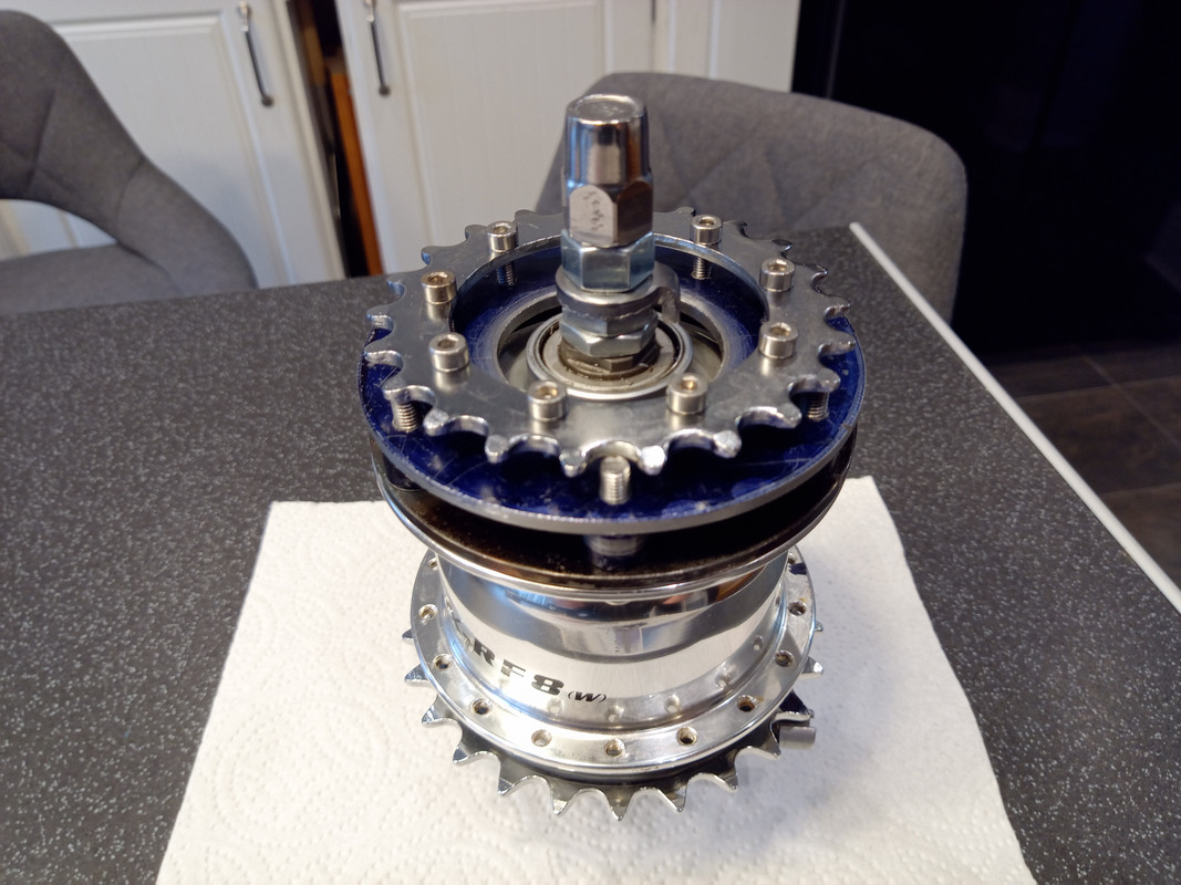

And here is a simple conversion of an 8-Speed Sturmey Archer hub to provide an intermediate gearbox function for driving the 2WD unit.
