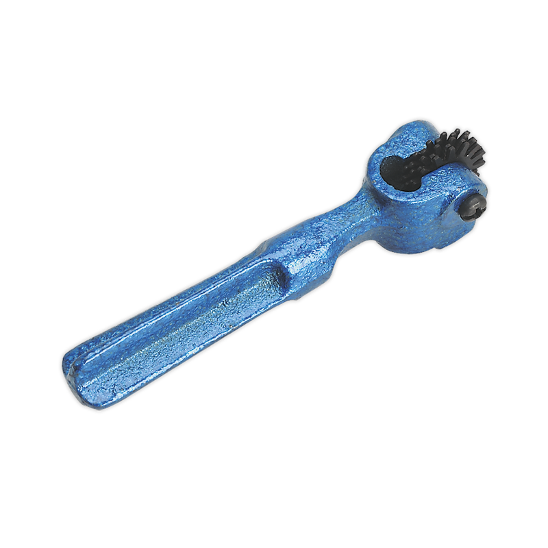

Anyone know of a cheap source for these “star” discs. Mine have nearly worn down all the way. This is the type of dresser I have. Bore is for a 1/4” bolt and I guess the discs were about an inch diameter, maybe a bit bigger?

Those dressers were numbered. Can you give me a number or else hole size, OD and thickness ? I may be able to help you. Noel

Hi, this is the type I have, and I was lucky enough to get a small box-full of the wheels, discs rods and bushes that were destined for the scrap bin, which will last me out.

The brand name for that dresser n the US is Desmond. Maybe the same name in the UK.

Chuck the barbaric thing away and treat yourself to a diamond dresser.
mark costello 112/04/2023 17:22:22
avatar
800 forum posts
16 photos
The above dresser will rip much of the wheel off, useful when removing grroves etc. The dressing sticks and diamond dressers are more finesse, useful for touch ups. They also seem to make the wheel make the part hotter. Not as free cutting.. Horses for courses.
noel shelley12/04/2023 17:35:17
2308 forum posts
33 photos
Mark has it ! the star wheel dresser is for making the wheel flat ish, use a diamond for this and you may well smash/ rip out the diamond. The diamond is really for final dressing but can make the wheel less free cutting and generate more heat. Noel.
