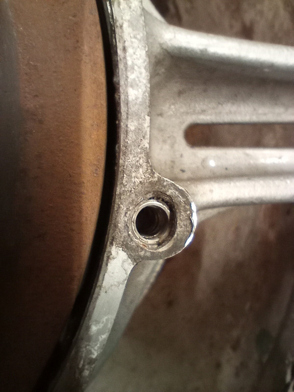

I'm going over my newly-acquired Moto Guzzi T5 Polizia and removed the rear wheel to change the tyre. It was disappointing to find that the retaining ring for the cush drive was missing and it didn't take long to find out why. The ring is held by three M6x20 bolts - one is stripped, another broken 8mm below the surface. These have been a straightforward repair, but the third one is problematic:
The bolt is broken below the surface and an attempt has been made to drill it out, but this has not been done right and the drill has wandered into the aluminium. It has been Helicoiled at an angle, the coil being 1/3 in the remains of the steel bolt, and 2/3 in the aluminium. There is very little metal surrounding the area. My initial thought is to remove the helicoil and make a core drill to remove the remaining bolt, but then what to do.
Ideally it would need welding, but the hole is deep. I wondered if it could be filled with a spool gun, or MIG to get to the bottom of the hole. I don't know about TIG - it seems to be too small and too deep to get to the bottom of the hole effectively.
Does anyone have any suggestions?

How much is "very little metal surrounding the area"?
Could one of these work?
http://www.timesert.com/html/bigsert.html
If you post a picture, you will likely receive more focussed suggestions.

An M6 x 1 Timesert won't help as the tapping drill size is the same as a helical so it can only go back in the same place.
Consider using high strength loctite to hold a special thin wall bush with an M6 x 1 thread down the middle. Last time I did such I was able to use 1/8" BSP for the bush thread. Being able to buy a solid blanking plug from the plumbing shop made it all much easier.
Sounds like there may not be enough room for a thread that large, almost 10 mm Ø, but M9 x1 and M8 x 1 exist. One time job standard taps and dies can be found relatively inexpensively on line.
Once you have the hole straightened up consider using a counterbore to take out the off angle part at the end so a suitable stub of aluminium alloy can be fitted with loctite to properly support the end of the bush. As you have hole depth to spare consider going deeper so a longer screw can be used. If you choose to do that make your bush just long enough to correct the off angled helicoiled portion then extend the thread into the parent metal guide by the thread in the bush.
Welding is a last resort. Not only is filling holes in old metal is tricky for all sorts of reasons it's also not a job that folk get much practice at. The professionals usually prefer to find another way or decline the job.

Mick Bailey25/02/2023 15:34:39
61 forum posts
Here's a picture;

The perspective of the photo is not clear. How far below the threaded hole is the spoke to the upper right of the photo? If it is lower, then you slice off the edge of the hole, so the repair area becomes an open channel, sit the wheel at 45 degrees and rebuild the entire boss. Many, many stripped out two stroke exhaust studs are repaired the same way.
An open channel allows you to remove everything that is not aluminium and to clean the hole to a surgical standard before welding. As an option, a car alloy wheel repair specialist should be able to do the welding for you.

You seem to have two good holes now, so how about using the retaining ring, or another specially made one, to act as a drill guide for the offset hole.
Obviously remove the dodgy Helicoil, and re-drill the hole, but using a spot drill and pecking at it.
Spot drills are far more rigid than jobbers, with very short flutes, so lend themselves to being guided by a close fitting bush. I some ways, provided there is an existing hole, the short flutes make them easier to steer, and more rigid, than a 2/3 flute slot end mill.

Although the bodgerey is hideous … The amount of ‘meat’ remaining doesn’t look too bad.
I would first remove the Helicoil [inflicting the minimum possible damage to the wheel] and then measure carefully the minimum diameter which would clear away the damage and restore the correct location.
Then, and only then, decide what repair-scheme is appropriate.
As Bill says, a specially made replica of the hole-pattern on retaining ring would seem appropriate for this exercise.

The cheapest new wheel I can find is £1391.97. I can't find a used one that matches mine - the brake offset is different on the ones I've enquired about, and they're all in Europe. I've been bitten buying used parts from EU breakers and trying to return scrap. Also, the screws coming loose and breaking when they hit the webbing in the drive box is not uncommon and I don't want to risk buying something that still needs repairing. Buying in the UK would be a better option to avoid the prospect of return postage and import costs. To get the bike on the road I'd prefer a good solid repair for the time being and if a wheel becomes available buy a replacement, if necessary.
The threaded hole extends into the spoke web, but the Helicoiled depth is fairly shallow.

You're not getting a timesert onto that there's not enough meat. If it were mine I would make a hardened drill bushing and put a 6mm slot drill down it until all of the bolt was drilled out, then I would simply use a longer bolt to pick up the remaining thread.

I thought of a stepped stud. Maybe even an M8, or as previously mentioned, an M7 Helicoil. I can't see how much of the remaining M6 stud is left, but getting that out cleanly first and taking a look how much of the original hole is left is perhaps the best path. I was even thinking of removing the Helicoil and filling that hole with a solid slug of threaded alloy bar, coated with JB Weld and made a very tight fit, then treating the job as though it had never been Helicoiled. Because that hole is much shallower then the original, and it runs sharply away from the stud, it may be that the re-threaded original hole would not extend too far into the JB welded slug. Whilst the original bolt is M6x20, the hole is 22mm deep - easily enough to get at least a 1.5D insert into good metal and maybe even a D2.
I don't think there's much force on the retaining ring that the bolts hold - they went from 6 screws to 3 in later years and the ring is fairly thin gauge sheet steel.
+1 on this. A slot drill with a hardened guide bush is far less likely to wander than even a stub drill. You are trying to drill out an offset hole in two different materials, one hard and one soft, that's a big ask for a drill bit.
I can't really tell from the photo but you might be able to make your own oversize threaded insert and drill and tap to suit after removing the bolt if there is not enough thread to use deeper in the original bolt hole.
Or alternatively, if the existing helicoil is securely in place, is there any reason you can't use it as is? If it is not quite straight, you might have to enlarge the hole in the ring that it retains and maybe even machine a tapered washer to suit? A bit bodgey for sure, but may be an alternative if you absolutely don't have enough "meat" there for inserts etc and the threaded hole has not extra threads deeper inside. Better to "bodge" than destroy an expensive wheel if there is not enough metal there to play around with, and it does look very thin there. Not familiar with Guzzi wheels but the bolts are not transmitting drive, just holding the retaining ring for the cush rubbers, are they not?
