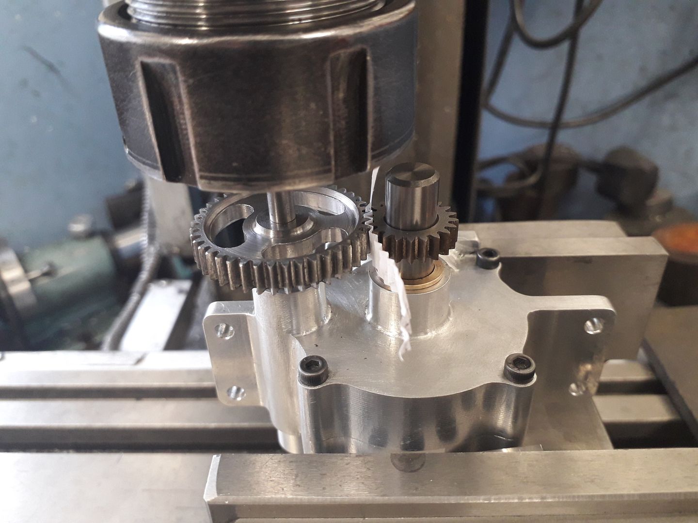

As the main function of the gear is just to get the 2:1 ratio you could probably get away with using the No3 and just tweak the PCD. Don't know which Hit and Miss you are making but a lot of designs mount the cam gear stud on an eccentric so you can easily adjust the mesh. If not just use a depthing method to place the cam gear a suitable distance from the crank gear, I tend to do that anyway.
Typical depthing with a dummy crankshaft supporting the smaller gear and the cam gear held in the mill which is rotated by hand to get a nice mesh and then note the handwheel position or zero the DRO so the cam stud hole can be drilled in that position.

I like Jason’s idea for meshing gears, given the limited demonstration use my engine will get I’m tempted to give it a go with just the No 3 cutter. The softer brass gear may just ‘wear in’.
