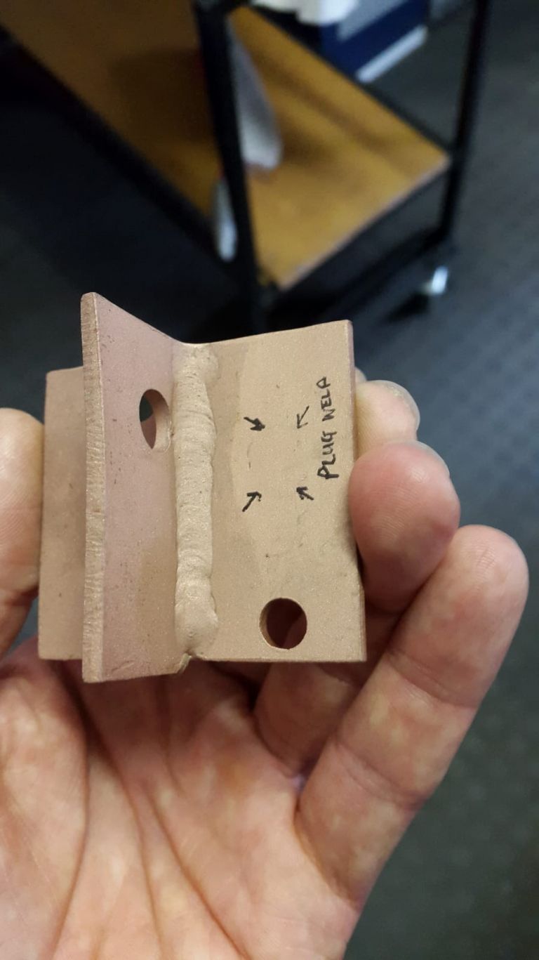

Yep and unfortunately, unlike the AMBSC stainless code, there is no allowance for supervising an amateur welding his boiler. An interesting inconsistency in the AMBSC codes. It is highly unlikely you will find anybody with the correct certification and recent expieriance as required by the code. My view of certified welders…
This was welded by a qualified, experienced, certified welder and passed inspection. This was for a very large Australian company.
This was welded by an amateur with no official experience, certifications or welder qualifications to try show the company what it 'should' look like.
Destructive testing...
Nuff said…
JasonB04/11/2022 07:18:54
avatar
25215 forum posts
3105 photos
1 articles
Is that actually weld on the first photo, colour of filler rod looks more like it was TIG brazed?
Would be interesting to see if the other side was a better "weld" as access may have been a bit tight from the side where the photo was taken depending on scale of job.
Edited By JasonB on 04/11/2022 07:22:39

Posted by JasonB on 04/11/2022 07:18:54:
Yep, AlBr filler rod, MIG. The pre-heat and interpass temperature was completely wrong, not to mention the welder was holding the gun incorrectly. The copper welding they did was worse.
Luker04/11/2022 07:44:45
avatar
230 forum posts
172 photos
Its a big job, those bent plates are 10mm thick. Other side looks like this...
The paint is for specific testing.
Luker04/11/2022 07:54:20
avatar
230 forum posts
172 photos
I think the point I'm trying to make is the requirement for a certified welder for ME boilers scares me. The one professionally made boiler we had at the club (71/4 Romulus, made in the UK) failed dismally and there were a few welding techniques that were simply unsafe. From what I've seen in industry the skills are not nearly as good as the amateur welders that have built their own boilers (at our club). We are very fortunate to have a boiler inspector that understands engineering first principles, and has himself, built more than half a dozen of his own boilers.
