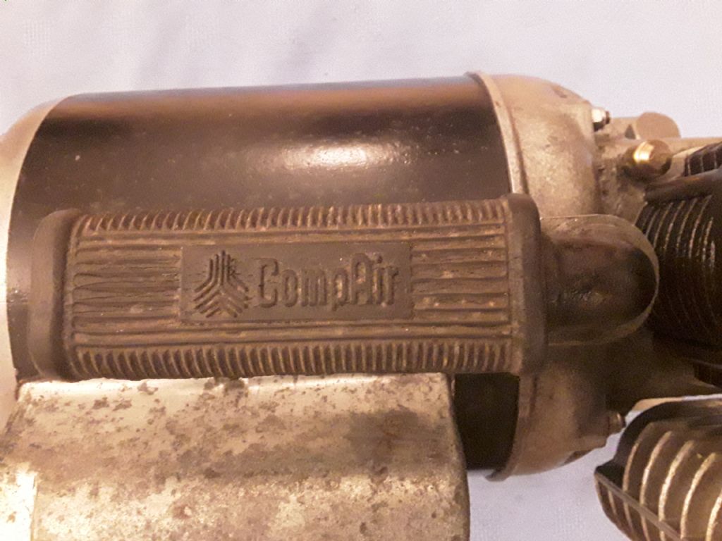

This is ancient, I got it out of a skip probably 30 years ago, so it's probably due an oil change. It is mounted straight on the end of the electric motorAny idea what I should use. There are no makers marks anywhere as far as I can see. Tellus 37 would be good as I've got a tin, but I'm prepared to buy the right stuff if need be

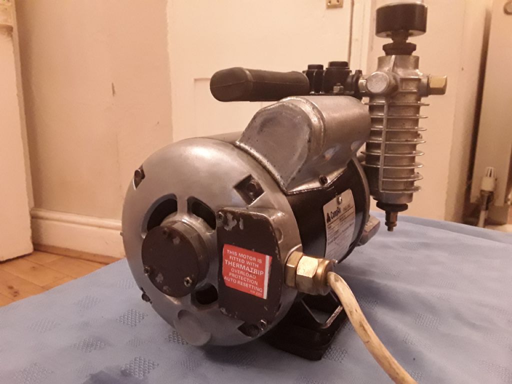

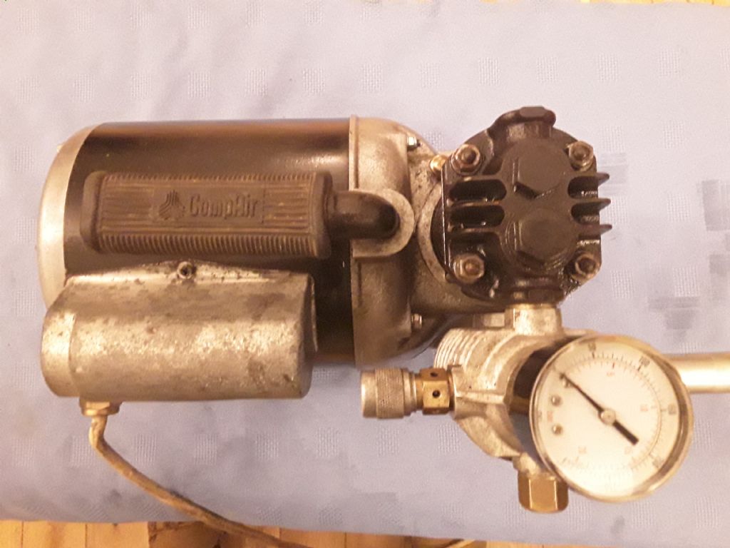

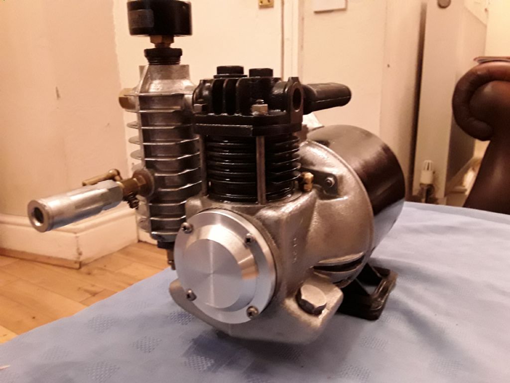

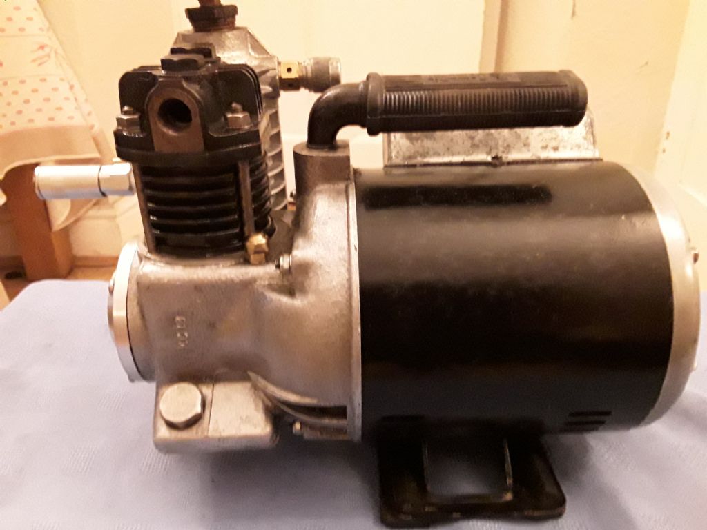

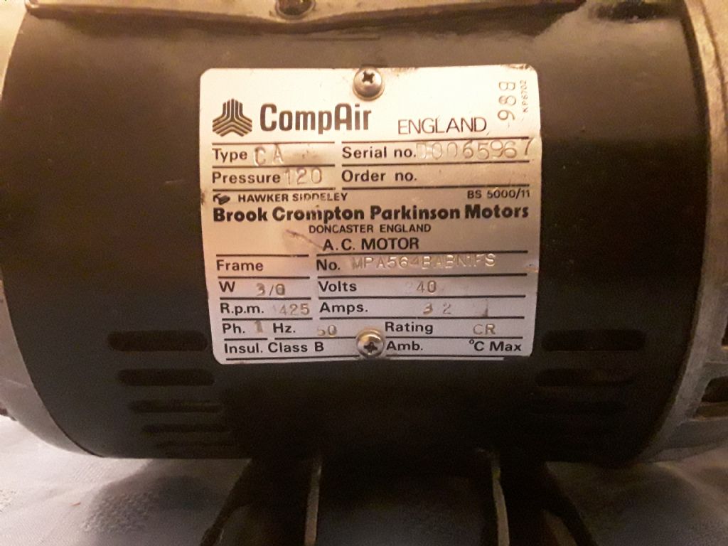

It looks like a COMPAIIR air compressor, just like mine.
I rescued this one from a dark and damp barn nearly 20 years ago, after rolling the dirty scabby looking thing out of my way many times while working in the barn. At first I thought the lump was a home made bodge up of a pump grafted onto an old motor, until one day I finally took a closer look.
I replaced the thin circular flat steel crankcase cover with a nice Alluminium cover I machined up, the air filter has just been removed while I make up another adapter to take a different type of filter.
When I stripped down the pump I found it was in perfect as new condition, not a single mark on the Alluminium alloy piston or cast iron cylinder bore. The conrod is steel and uses a sort of self aligning ball race big end bearing.
I use straight SAE 30 oil in this little compressor, and in my other larger compressors.

That's it exactly, but no plate or name on the inlet filter. Following NDIY advice I've used Tellus 37. It only holds about half a cup. One of these years I'll treat it to a pressure switch
