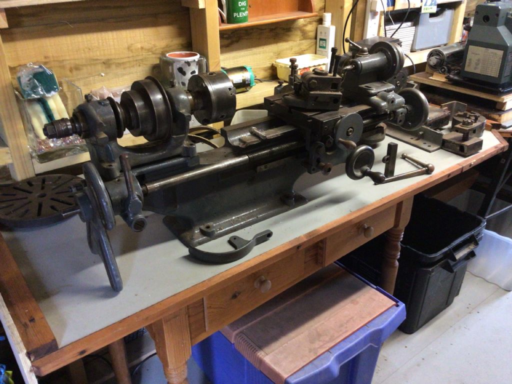

Hi, can anyone tell me anything about this lathe I have just bought to restore.
make,
age.

It looks in fair condition - at least, not a rust-bucket.
You may find it helpful to re-photograph the parts arranged logically even if not assembled; and the right way round (headstock to the left). As it is about the only part that may be identifiable by manufacturer in the picture, is the bed!

Looks like a Drunnond M series from the piccy
Welcome to the nuthouse
(keep every teeny grubscrew/washer you can find if anything drops out, it all finds a home eventually)

Or maybe a Pools? A number of pre-war small British lathes took that general form, a front view with all the bits in the right general place would help. At the moment hard to see many distinguishing features.

The leadscrew clutch handle is a significant identifying feature.

Thanks, yes it does seem to match a Drummond M…..I collect it tomorrow….
just hope it’s all there….

Then say yes to everything, and scan the floor for bits. Refuse nothing.
Look for a box of bits too, nuts, screws, washers, cogs, flat bits, funny looking metal bits, take it all
Good luck
Edit: The 4 studs for fitting the headstock to the bed? you can see the 4 holes
there must be a box somewhere with them in if they are missing
And where's the backgear? that's a solid shaft with 2 cogs attached that goes on the back of the headstock
The tailstock shaft has been withdrawn, that has parts to tie it to the bed
There's a box of bits somewhere and you really really need them

Hi Haydn it is an M type Drummond Myford lathe. There are a few web sites with help with these.

How certain is the identification? The reason I guessed it might be a Pools is these wings on the headstock:
David's Drummond looks different to me.

What I think is the tail-stock looks odd to me - has this photo been flipped left-to-right?

It’s not sharp enough to check the handedness of the screw threads devil
… but there is probably a useful clue on that timber on the floor

The headstock may not be a drummond at all, where are the holes for the backgear shaft?
Yet the catellated front nut and rear lug are there
But the rest of it looks Drummond
It looks like the headstock may have been "modified"

Hi, it could be like the unusual Myford one shown with serial J1102 dated 1944 Drummond M type on Tony's web site, which may explain the dog clutch lever at the headstock end of the bed shown in Haydn's photo.
