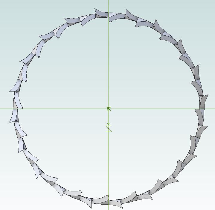

I learn CAD by tackling ever more difficult objects, mostly successful, but the latest has me stumped. My nemesis is a hole saw:
First attempt was easy enough, not worrying about the exact scale, below was done by creating a plane tangent to the cylinder, sketching a tooth on the plane, cutting through the cylinder with the sketch, and then replicating the cut with a circular pattern:
There are three problems!
First, the teeth don't align properly with the central axis. The error is more obvious on a small diameter hole saw and is caused by a flat sketch being projected parallel on to the curve.
Second, the teeth need to be alternately bent a couple of degrees in and out to create the kerf. Something like this, but easier to draw and replicate in a circle with properly shaped teeth;
Thirdly, the teeth in the real saw aren't all the same depth. It can just be seen in the first photo that the teeth nearest and furthest from the camera are deep and those to the side are shallow. Might be a manufacturing error except it looks neatly deliberate.
I don't know how to model this saw in CAD! I've failed with FreeCAD and Solid Edge in both Part Design and sheet-metal modes. Very grateful for any suggestions please!

Andrew Johnston27/08/2022 22:42:16
avatar
7061 forum posts
719 photos
Use a loft from the sketch to a point on the rotational axis to create the tooth shape?
Andrew
PS: In reality I expect the teeth are cut straight during manfacture with no taper

JasonB28/08/2022 06:58:47
avatar
25215 forum posts
3105 photos
1 articles
Does the CAD that you are using have sheet metal? you may be able to draw it flat and then roll it up just like the saws are made.
If not you may be able to wrap the sketch of the teeth around the circle
The better makes of holesaw have the variable pitch to reduce chatter and noise, if you look on larger dia saws you can see it quite clearly. Also you get the odd part tooth where the rolled up blade is joined which confirms the teeth are cut then rolled

JasonB28/08/2022 18:09:34
avatar
25215 forum posts
3105 photos
1 articles
I wonder if you could make it by combining two sketched. Draw as you have above but with a slight trumpet shape and cut the teeth plus a gap which will gibe you the teeth bent outwards. Then do an additional ring around the top that bends in slightly and cut the alternate teeth from that. When the two are combined you will have teeth set in either direction.

Needs a bit more work getting the inner and outer teeth the same size but basically what I said in the previous post using Boolean unite to make the flaired out tube and ring of flaired in teeth into one unit

SillyOldDuffer28/08/2022 19:04:24
10668 forum posts
2415 photos
SolidEdge Sheetmetal achieved this on a straight blade:
Hard work though because the teeth have to be bent one at a time - takes forever. Also the round holes are essential to relieve the bends: seems SoildEdge won't apply bends that break the rules!
A quick try with Ed's suggestion didn't work in Solid Edge (Sheetmetal) and I'll try in Part mode later.
I like Jason's trumpet idea, pretty sure SE can do the same and will try after I've eaten.

SillyOldDuffer29/08/2022 15:28:28
10668 forum posts
2415 photos
This my first attempt at Jason's Trumpet method, proof of concept, with no attempt at getting the tooth details right. However it works, and is quick!

Gary Wooding29/08/2022 19:30:15
1074 forum posts
290 photos
I first created sketch of two versions of the profile of the blade; one with the lip curving out and the other with the lip curving in.hole saw0.jpg
Then each profile was revolved to create two bodies in the same location. Here's the one for the top sloping out.
A new sketch was then drawn from the top. This was to get the correct angle for the pairs of teeth - I chose 10 pairs.
I then created a workplane offset from the original sketch, but through the line defining the angle of the previous sketch.
I then cut then created a workplane to cut the two bodies along the horizontal line of that sketch. This created 4 bodies: two copies of the cylindrical parts, and one each of the in/out sloping parts.
Gary Wooding29/08/2022 19:41:37
1074 forum posts
290 photos
Continued...
I then lofted the two teeth towards the small rectangle in the centre.
Because the in/out sloping parts were now separate from the two cylindrical parts I could create an intersection of one tooth and the in-slope section, and the other with the out-slope section.
I could then do a circular pattern of the two teeth and then combine then with one of the cylindrical parts. That completed the job.
