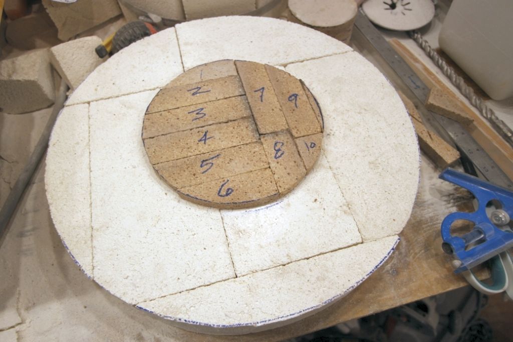

In order to keep material costs as low as possible, I am trying to build this entire furnace using the materials I have on hand in the shop.
I am having to get creative with the hot face, which needs to withstand iron temperatures which will be continuous 2,900 F rated.
I have some hard fire bricks, which stand up to iron temperatures quite well, and so I am cutting up strips for a hot face veneer.
I have a wet saw, and the cutting went pretty well (using a commercial-grade respirator).
A few of the strips broke into two or three pieces, but I have some plastic refractory that is rated 3,800 F, that is good about gluing hot faces together.
If I had enough plastic refractory (which I don't), I would make the entire 3/8" thick hot face using that material.
I added tile flooring to several rooms in a relative's house a few years ago, and so I have gotten good with a tile saw.
The lighter color bricks are insulating fire bricks rated at 2,600 F.
The insulating bricks will not stand up to iron temperatures, at least not the 2,600 F rated ones, but the hot face will protect them.
The insulating fire bricks are soft and easy to cut with a hand saw.
The hard fire bricks have to be cut with a wet masonry saw.
The plinth (the platform that the crucible sits on) is made from two pieces of 1" thick hard fire brick.

The hot face veneer is 3/8" thick, and it is not shown in this photo.
I think an A4 will be the ideal crucible size for this furnace, which will hold perhaps 8-10 lbs of bronze.
I will wrap two layers of 1" ceramic blanket around this furnace, so that the exterior will operate cool to the touch.
The outer shell will be an old hot water heater steel tank that I will cut up and salvage.
The intent of the insulating fire bricks is to provide a rigid support behind the 3/8" thick hot face veneer.
Some folks use coated ceramic blanket, but I wanted a more robust furnace that cannot be damaged easily.
This is not my finest brick bevel cutting job, but when you see an iron furnace after a few years, you realize there is not much to be gained by making a perfect furnace.
The main goals of this furnace build is to keep the mass relatively low, have a very durable iron-temperature-rated hot face, and have a very long lasting furnace when operated at iron temperatures.
