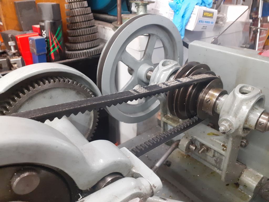

Having recently bought a 1946 Myford M a few questions have come up, both general to the model and specific to my machine. I had a look through the forum but can't find answers to these particular ones, so, bearing in mind I am a novice, here goes:
The toolpost arrangement seems odd. I have both the clamp-on type and the 4-way post which are designed to take tooling of up to about half an inch, but the centre height seems too high as anything over about 5/16" (8mm) toolling falls well above the minimum adjustment for centre height. Is there a reason for this? It would also be very convenient to fit a quick-change toolpost to get the height adjustment set up without shims. I am aware of the modification by removing the original cast-in toolpost but has anyone successfully bored out a quick-change toolpost to fit the 1-1/4" original post? I know most are hardened and hence difficult to do this with, but annealing case hardening is possible, or there is an unhardened one from Chronos. Has it been done?
Whilst wear appears acceptable in most parts, I do have a lot of wear in the half nut with over half a turn of backlash. I have seen the bobbin-type repair approach but am not yet confident enough to attempt that level of work. Has anyone made these for sale? I also have some adjustments to make as there is a bit of end float in the headstock spindle - I have read the instructions (and the notes on adding/changing various bearings) but I can't claim to fully understand the pros and cons of the various approaches. It looks like the starting point is to obtain a suitably sized C-spanner to slacken the bronze collars, but I can't see any castellated nuts?
I definitely have a missing oiler on the front end of the headstock and my understanding is that since this also serves to lock the bearing and spread it slightly, simply dropping oil down the hole is not a suitable substitute. Any ideas on where to find a suitable oiler or, better still, to find a drip oiler? I can get simple oil cups from RDG but don't actually know what the thread is?
The whole machine has a wobble. Whilst everything runs true relative to its own reference, the wobble makes it difficult to check what is happening whilst turning. It seems to trace back to the motor - this has the bench-mounted counter-shaft/motor unit so whilst the motor pivots semi-independently, the whole assembly has some degree of coupling to the bed, both through being bolted to the bench and through the tensioning bar. The motor is a Brook Crompton and probably contemporary to the lathe. Any ideas why I am getting a wobble or how to stop it?
I have a reasonable amount of equipment with it, certainly everything needed for now, but there are a few things which would be useful to add at some point down the line so am keeping an eye out for the original slimline 4-jaw chuck and a faceplate so that I can swing larger items in the gap. The two which are unlikely to turn up are a reverse tumbler and a milling slide. I therefore wondered whether anyone had successfully used these parts from an ML7 and if there were any issues in doing so? It appears that the ML7 slide should be a drop-on fit to the cross-slide (removing the top-slide and accepting that linear movement will need to be on the leadscrew). The ML7 reverse tumbler appears to be easily available and fairly cheap - can it be adapted?
Finally, and somewhat trivial, but what colour should it be? Mine is currently Myford 'aqua' and I have seen a few others for sale in that colour, but it has certainly been repainted, The fixed and travelling steadies (which of course may not have originally been with this machine) have not been repainted and are a sort of murky brown/green/grey, similar to that shown on this page on lathes.co.uk - http://www.lathes.co.uk/drummond-m-type-post-1924/page2.html (see particularly the close-up of the headstock). However, this does not appear to be a recognised colour for Myford, as in Paragon don't list it, so does anyone have any idea what it is and if that would be correct? I don't plan a major rebuild but some parts would benefit from a clean and paint to keep the rust off, so since I will need to buy some paint I might as well get the right colour from the start.

Sounds like your 4-way toolpost is off another machine and the metal under the tool is too thick,causing the toolbit to sit up too high. Pics of what you have there would help. The original Norman clamping type tool holder should hold 1/2" tool bits at centre height no problem. I would not chop the pillar off the topslide to fit a QC toolpost. Learn to use the others first and get to know the machine. Nothing wrong with using shims on a four way. It's all I do on my M-Type and my ML7.
From memory the oiler bolt is about 5/16 BSW, with the end machined to a point that fits into the bearing wedge. Bolt has a square head and a hole through the middle for the oil. I made adaptors and soldered them onto mine so I could screw drip oilers into the adaptor.
The C spanner fits onto the slots machined around the circumfrence of the round bronze rings that screw on to the front of the bearing.
Wobble couuld be caused by old hardened V belts that have "taken a set" from standing for years.
Colour, not sure. Drummonds were black originally. Myford may have changed that to war surplus battleship grey like the ML7 when they took over making the M-Type. I don't know.
There is a good drummondlathe group at groups.io with a lot of knowledgeable and helpful M-type owners there. The Files section has a lot of good info in it. Also a Facebook page on Drummond lathes I believe.
ML7 four jaw chuck could be adapted by bolting to an M-type back plate, which used to be available from lathes.co.uk some years back, but not sure these days.
ML7 cross slide and tumbler reverse and just about everything else will not fit on an M-type. Totally different design and the M-Type was a lot heavier built. Tumbler reverse castings and gears and other such accessory castings are available at times through the groups.io Drummondlathe group. But it is not something that is necessary. Myford vertical slide will fit. T slot spacing is different but you can use one T bolt and one clamp etc.

Following your comments I had another look and observed that the Norman tool holder does indeed hold 1/2" tools at exactly the right centre height. The 4-way toolpost is about 1/16" too thick on the base which lifts it just above centre, so skimming the base off would be the easiest option (once I have a suitable faceplate or chuck). You can still get suitable M-type back plates but they extend the length of the chuck which reduces the capacity to use the swing so I will hang on until something correct turns up. I can just use a faceplate for now once I find a suitable one.
Through a process of disconnecting belts in turn it is definitely either the motor to counter shaft V-belt or the counter shaft itself which is causing the wobble. The belt does not show any signs of having a set but it is the easiest option to try to eliminate as a cause so I will buy a replacement once I have worked out what I need.
I won't be cutting the cast in toolpost off, but I do need some form of more rapid tool changing solution as a lot of what I want to do is repeat sequences of cutting, e.g. for nuts and studs. I don't want to have to keep swapping out the tool every couple of minutes on the Norman tool holder. A modern quick-change tool holder that I can bore out the centre on to a suitable size would be the obvious solution.
The oiler appears to be more of an issue than I first thought. I can't see any sign of anything down the chuck end hole, suggesting that something has rotated in there. It is still free and smooth so hopefully not too much damage, but it does mean I now need to work out how to dismantle the headstock far enough to see what's going on.

Hi Alec  I have an M Type Drummond Myford lathe. I havd done a few mods to my lathe to make it more useable for me like quick change toolpost, rear toolpost, spindle lubrication drip feed, Morse 2 taper in tailstock and tumbler reverse for feed drive. The wobble on your lathe may be because the intermediate large pully on the counter shaft is out of ballance. The one on my lathe had the same problem and I re-machined the casting to remove lumps and bumps which was causing the problem. The wear in the half nut can be caused by swarf etc in there causing it to not engage properly it is worth striping the front saddle and clean and adjust it. I have a milling slide which is for sale if you like drop me a message.
The spindle is awkward to adjust just follow the instructions. Slacken off the rear nut on the spindle gear ensuring you slacken the grub screw in the side then first then loosen the two lubrication bolts on both bearings but not too much or the bearing may spin when you tighten the bronze nuts. Slacken both bronze nuts on the bearings to make sure the wedge is not trapped or stuck, I tap the bearing with a small hide mallet to ensure they are loose. Tighten the front bearing first, using the correct C spanner till you get a slight friction but still free to spin. Then tighten the lubrication bolt which very slightly opens the bearing as you tighten it. It should soinn free with no play. Do the same for the rear bearing checking the same as before. Then tighten the rear nut to take up any end float and retighten the grub screw. Lubricate both bearings and run the lathe and keep putting your hand on the castings checking for excessive heat. Also put a dial indication on to the chuck and pull and push and check for end float and up and down movement.
Have a look at my pictures in my albums and have a look at my posts if you can.
Have a look on here as well. https://m.facebook.com/groups/703113663087249/
The lubrication bolt drawing.
If the bolt is missing the bearing may hsve spun and you will need to check if the wedge is still there as well.
Do not overtighten the bronze bearing nut as you can strip the threads and they are not easy to replace. You will have to remove the gear cover on the rear of the spindle to get at the bronze nut there probably and watch out for spacer on screw holding cover plate on.
Warning never lock the spindle with back gear as the cast iron gear teeth break off if shock treated  and are also difficult to repair or replace.

Thanks David, that's great information. I will take the cover off the rear of the spindle tomorrow, locate the grub screw. I can't do much else until I sort out a C-spanner.
The front bearing has spun - what do I need to dismantle to access it enough to spin it back? Is it as simple as taking the front nut right off and I should be able to poke it round, or am I in for a complete spindle strip-down? I'm hoping the wedge is still in there somewhere as otherwise I have another thing to make, although that probably isn't as challenging as making the lubrication bolt without a lathe!
Fingers crossed it's not the pulley causing the wobble, as that's a distinctly Catch 22 situation of another part which needs the lathe to fix it. I will try changing the belt first. Looks like I have a few things to sort out, then I will try using it and then decide which modifications will be worthwhile for me, but I'm pretty sure I will need to sort out a quick change tool holder one way or another.

Your 4 way toolpost looks about the same as the one I made for mine. It takes 3/8 square tooling right on centre height. Works well. Although, I use a lot of 1/4 and 5/16 HSS anyway. Cheaper and quicker to grind up than the bigger stuff. I found carbide insert tooling does not work that well on my M-Type. Partly because the spindle seems a bit small and not rigid enough for the heavier cuts the carbide can take, and partly because mine is flat belt that slips under heavy cuts with carbide. Yet it will take 100 thou cuts with HSS no problem.
I think you will find all the Drummond/Myford M-Type chucks are mounted on backplates. The gap in the bed is longer than on an ML7 to accommodate this. And from memory the ML7 four jaw uses a backplate too. Only the 3 jaw has the internal thread in the body itself.

Progress is necessarily limited as I don't have a suitably sized C-spanner, so have ordered one but will have to wait until it arrives to take the nuts off. I have stripped the back end down - the collar with the grub screw did not have a piece of copper under it so I presume it would be a good idea to make one - I'll see what I have lying around in the way of suitable copper (probably an old MIG tip will yield something). There were no nasty surprises getting in as far as I could at the back end, and it all feels smooth, so fingers crossed.
David - offhand do you know the spindle OD? I like the idea of tapping through with a piece of wood that catches everything in order, but want to make sure I don't use anything too large which will jam up. I have found an online copy of the Drummond manual which appears to give me what I need by way of a drawing.
One win - the link belt from countershaft to headstock turns out to be the same length as the belt needed from motor to countershaft, so I swapped it over and the wobble has gone. The pulley on the motor needs moving down a bit to get it in line, and the large pulley isn't quite true in plane, but nothing that will affect running at the kind of accuracy I am looking for. Just need to order another length of link belt.
Ref. the collet set from RDG - they appear to have both an ER16 set and an ER25 set in 1MT. Apart from the latter being nearly double the price but allowing tools up to 16mm, are there any other pros/cons I should be aware of?
Hopper - I may not be lucky in finding a chuck which mounts without a backplate for the M, but the 4-jaw did exist for the ML7 with an internal thread - see https://www.ebay.co.uk/itm/154976775357?hash=item241555ecbd:g:dZQAAOSwFzZicNkV for example. The clue is that there are no screw holes on the front face. A version is still available new from RDG.
I do still have the 'Catch 22' of needing a front lubricator bolt to run the lathe, but needing the lathe to make the bolt. I think a quick conversion of a standard BSW bolt by drilling a hole up the centre on the pillar drill and creating a good approximation to the cone angle by spinning against the grinder should suffice to get it running and then I can make the proper part, although that will be a bit interesting as I will have to use the catch plate and I haven't tried one of those before.

Beware that the ML7 spindle nose has a larger thread and register than the M-Type so ML7 chucks will not screw on to a M-type. You need the earler type 4-jaw with the backing plate and a M-type backing plate with the small thread. Not all those older 4-jaws had the bolts going all the way through to the front, but studs in the back. Another thing is the longer gap on on the M-Type. if you use a compact chuck without a backplate on it, you then have to have the carriage hanging off the end of the bed to get the tool up close to the chuck, so better to go with the backplate.
Your plan with the oiler screw sounds good. Should get you going. There is a small wedge that the screw bears on and sits in the slot in the bearing. It has an oil hole through it from memory.

The small end of the spindle is 3/4 inch diamiter so that is the size I use to tap out the spindle. I will send another message about drawings etc so I can emsil you copies.

Don't run the motor any more till you fix the bearing, the felt (if there is one) may be unable to soak up any oil.
