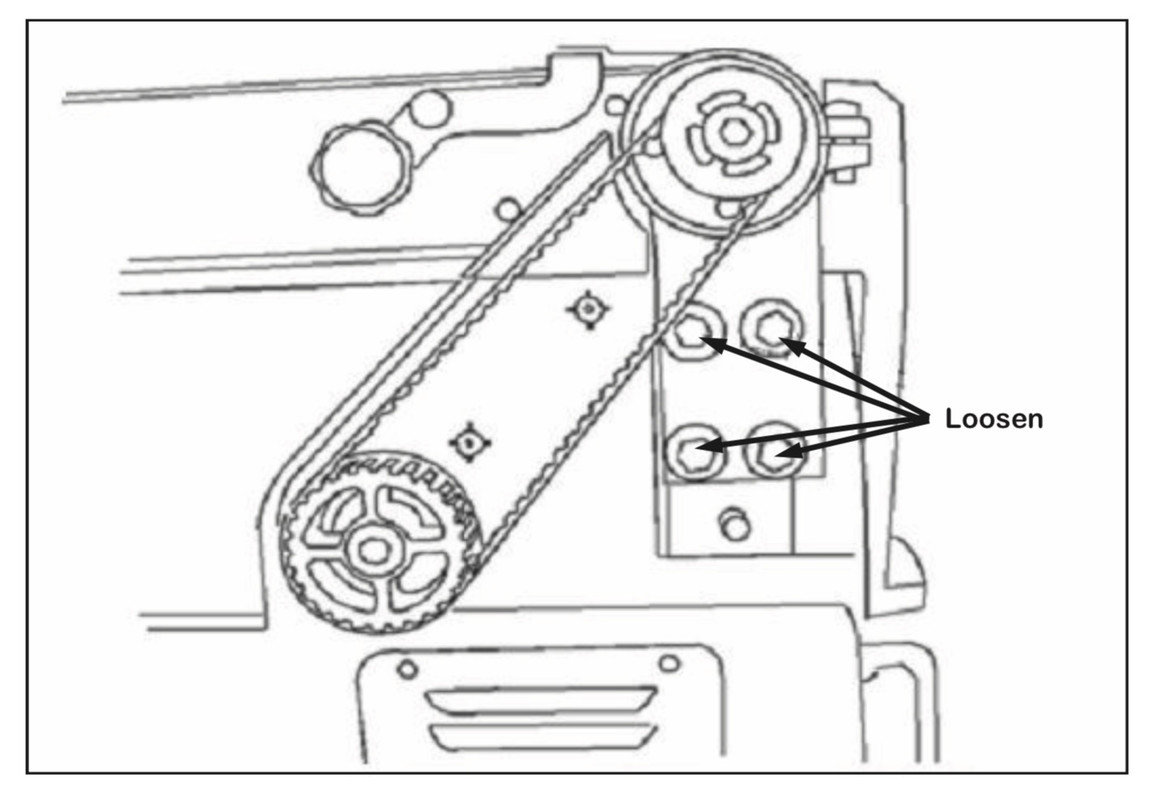

This is what the setup looks like. You loosen the four bolts and the whole assembly goes up and down. I’ve sent a message to RP asking how much a replacement belt is.

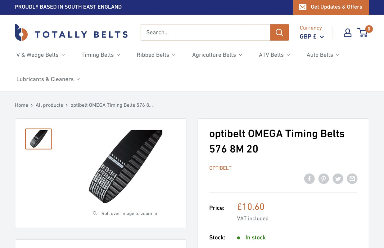

By a process of elimination I think I may have found something. I took a measurement of 575mm long and 576mm seems to be a standard length. Pitch and width also seem about right. I quite like the price as well. Postage is £4.99.
