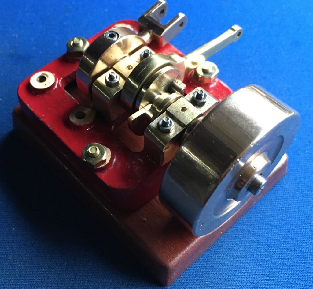

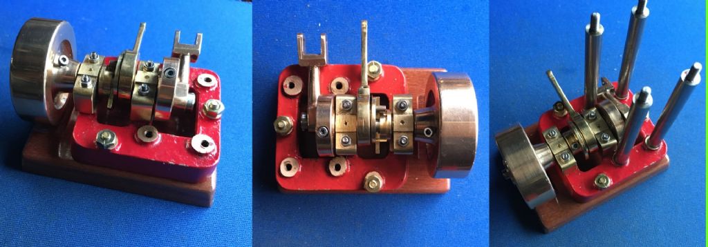

A friend gave me a set of castings for a small marine steam engine which he had started when he was an apprentice machinist in the early 1970’s but never finished the project. He got side tracked and joined the Australian navy to see the world and became a senior officer. His work involved the commissioning and operation of steam turbines on the navy ships.

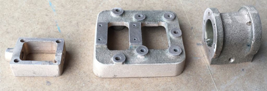

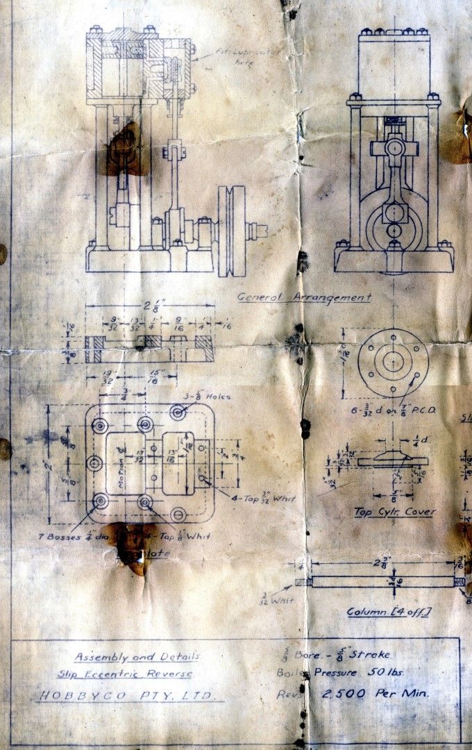

The drawings and castings were sold by HobbyCo Pty Ltd, a model supplier in Sydney and is similar to the Trojan engine sold by Reeves. It is a vertical marine engine with a 5/8” bore and 5/8” stroke, fitted with a slip reversing eccentric. Only the steam cylinder and the base had been completed and all other parts had to be made to finish the model.

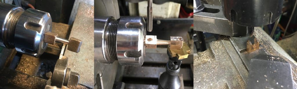

Castings after machining and grit blasting
3 valve shaft.jpgMachining slide valve connecting rod

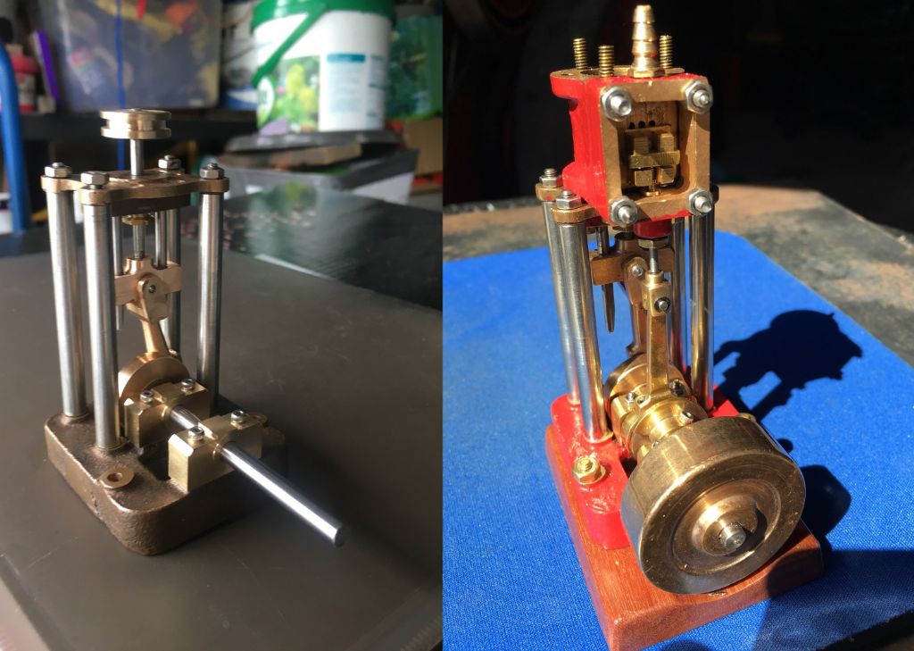

4 end cap.jpgCylinder bottom end cap and crosshead guides
5 base assy.jpgCrankshaft and Base Assembly

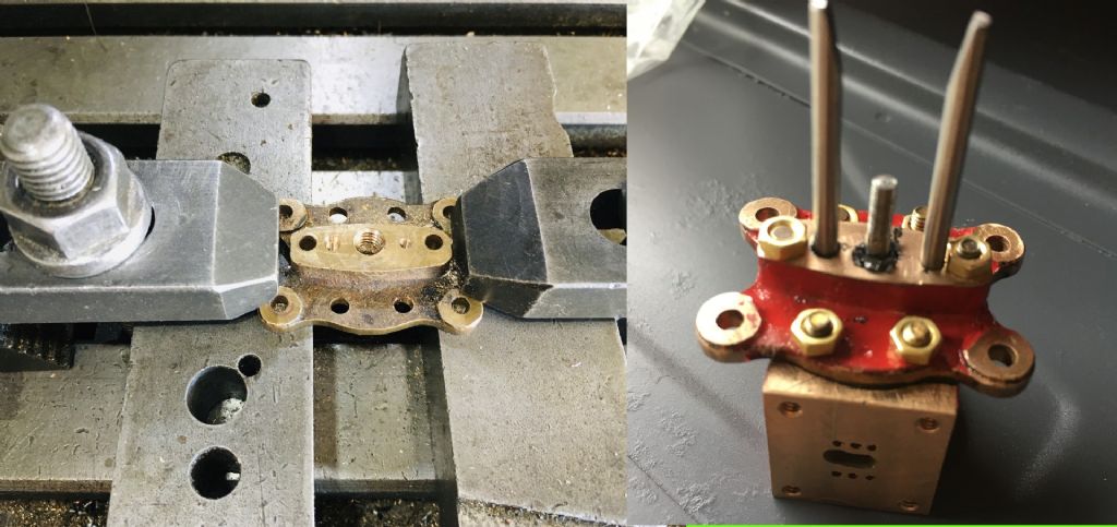

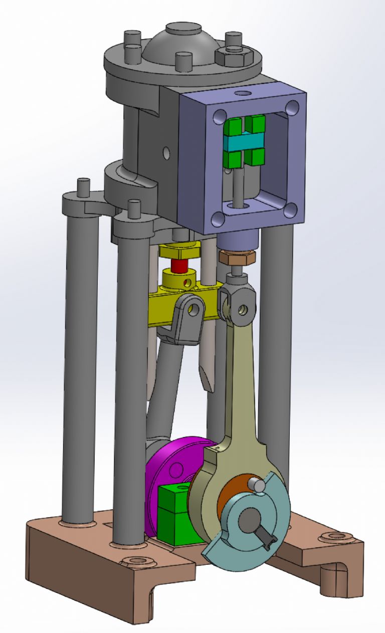

The eccentrics on a standard steam engine with a slide or piston valve are fixed to the crankshaft with a key or clamp screw and the direction can be reversed by rotating them by 180 degrees.
On an engine with slip eccentrics they are not fixed and is free to “slip” on the crankshaft and are driven by a pin on an adjacent boss that is fixed to the crankshaft. Manually turning the crankshaft in the opposite direction moves the pin but it does not contact and drive the eccentric until it has moved thru 180 degrees.
A slip eccentric is one of the easiest ways of making a steam engine reversible and is ideal for use on a small boat.
Assembly of Engine, Painting and a Wooden Base

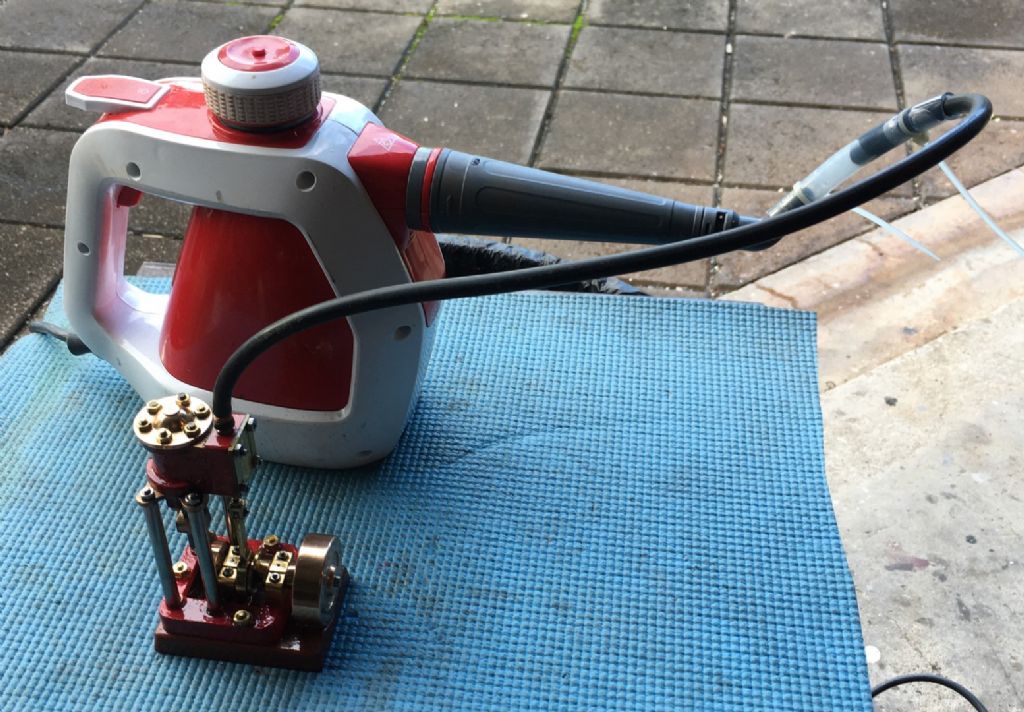

The boiler for running the engine is a $35 ALDI steam cleaner and much better than running a noisy air compressor.

A good project well completed. Thanks for the story and the pictures. Thanks also for the description and cad drawing of how a slip eccentric works, we're never too old to learn are we.

Its interesting that other Trojan and its look alikes have appeared recently. I tried to build Trojan without castings when I was at school. I tried again using bar stock about 12 years ago (photos in my album). I was surprised to discover that a casting set is about £100 now!!! The completed simplex, fully machined looks like it was about £3.
