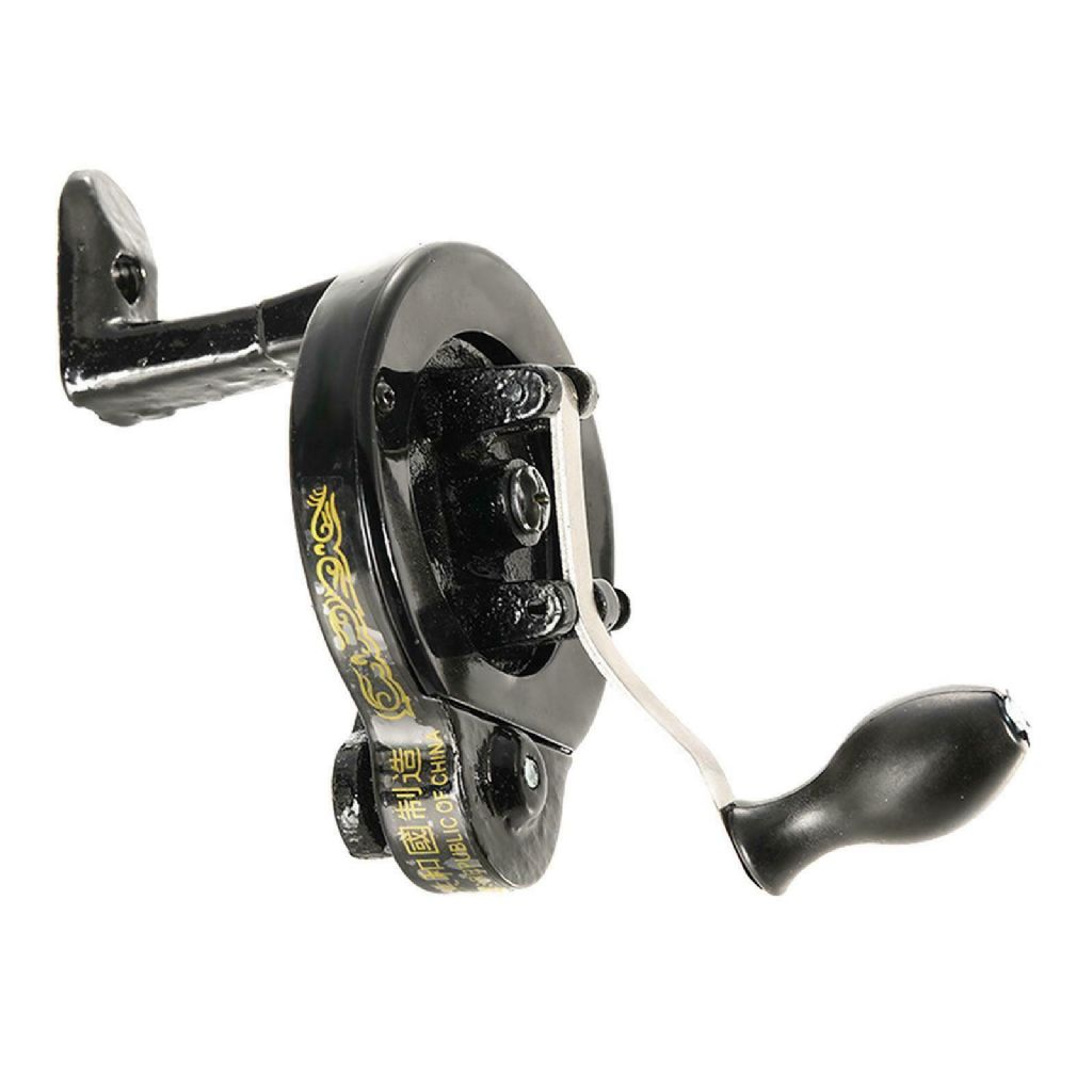

I have an old hand-crank gearbox of an old sewing machine like the one below, that I plan to one day add to the apron of the M-Type as a handwheel reduction gear and rotation reverser. They seem to be common and cheap to buy. It;s just two gears in a housing, one large one small. Perfect, with a little fettling to fit the existing gear and spindle and hand wheel.
