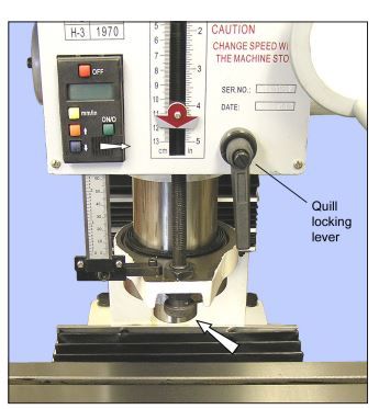

Before anyone else says the quill is too far extended here is a shot of an RF45 type mill. When you extend the quill the gap opens up above the bracket around the quill, we can't even see the bracket let alone if there is any significant gap above it. All we can see is the rotating end of the spindle
Or hover your mouse over the end of the spindle on the image that comes up here
Edited By JasonB on 07/04/2022 07:43:14

Regarding the quill, Jasonb is bang on. The quill is extended only enough to allow engagement of the fine feed mechanism. In other words, very little.
