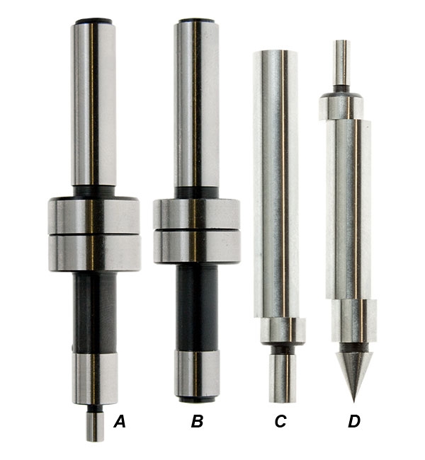

I posted in my CNC lathe thread a little on an edge finder/probe I am playing with. Turns out it is very sensitive in detecting contact with an object, but I wish to quantify that somehow. I wish to try measure the deflection of the ball at the instant where detection of the contact is made. A crude attempt in the DRO fitted mill gave very promising results, but not definitive. The DRO is a hi-spec glass scale type, with readout in 0.005mm resolution - note, not accuracy, just resolution. Moving the probe to detect contact, zero the DRO and then retract till no-detect and the DRO shows - nothing..no movement detected. I repeated this at a dozen different DRO positions, moving towards and away from contact, etc - the DRO never registers the movement that results in a detection or loss thereoff.
I tried with a micrometer, screwing the anvil up to the ball till contact, and then retract till no contact - the amount of unscrew is so small it shows nothing on the micrometer scribed position line movement...
I was wondering if Foucault measurement concepts ( such as for lens accuracies) might somehow be used - but not really applicable. My current ideas are around making a differential screw setup to improve on the micrometer concept - a differential screw with 1mm and 1.1mm pitches ) doable to some extent on my lathe with ELS, but at those dimensions maybe even the lathe leadscrew variation will mask the results. Averaging over a few settings of the differential screw length may help?  And even a 0.1mm per screw rev gives 0.001mm with 1/100 of a turn - difficult to determine that as well. - Maybe a combination of a metric and imperial thread, sort of 1mm and 1.01 mm pitch!
The probe tip vibrates at around 3.9khz - in a resonant oscillator circuit, which relies on feedback from a pickup point on the piezo disc generating the mechanical vibration. The probe and disc are part of the mechanical load, setting the resonant frequency. A LC tuned circuit forms the 'tank' of the oscillator and ha a high circulating current in the tank ( tens of milliamps) . The feedback from the Piezo disc is adjusted so that the system only just oscillates. Then the slightest mechanical contact causes heavy damping of the resonant circuit, and oscillation stops - I then detect the drop in current in the coil and know we have made contact.
How do I in an amateur workshop measure this? I guess I don't need to know that it is '0.3um' - sort of less than 1um would be good enough..!

Played a bit in the workshop with this again. It will not be possible for me to measure accurately the actual deflection required for detection - as Kiwi Bloke said - chasing microns is hard! just brushing against the test setup causes detection to come and go in my setup - micron(s) are really small!
I put the probe in the 3jaw on my Emco V10P. Gently clamped a micrometer in the tool post and tried with the anvil against the ball to see in a 'rigid' setup if I can actually see any movement of the thimble line from zero.
The lightest touch on the thimble is enough to cause/remove detection, and being very gentle, holding my breath, I can 'just' sense some thimble rotation to make/break detection, but cannot see any line movement on the thimble with a x3.5 loupe.
I moved the cross slide so that the micrometer anvil just touches the ball and shows contact, and locked all slides - fiddly to lock cross slide while ensuring that contact is 'just' made, but got it right. Then I 'tapped' my right forefinger nail against the tool post and each tap would break contact, removing finger re-made contact - the lightest of taps! See the video link...
I have a strong suspicion the contact detection deflection is WELL into the sub-micron region!
