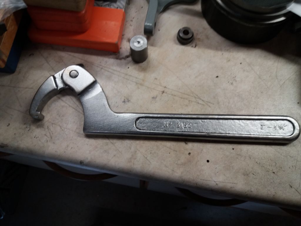

David George 130/03/2022 22:20:41
avatar
2110 forum posts
565 photos
I use a C spanner on chuck groove as this part is clearance and won't damage the chuck or jaws. Just s tap with a mallet.
David
