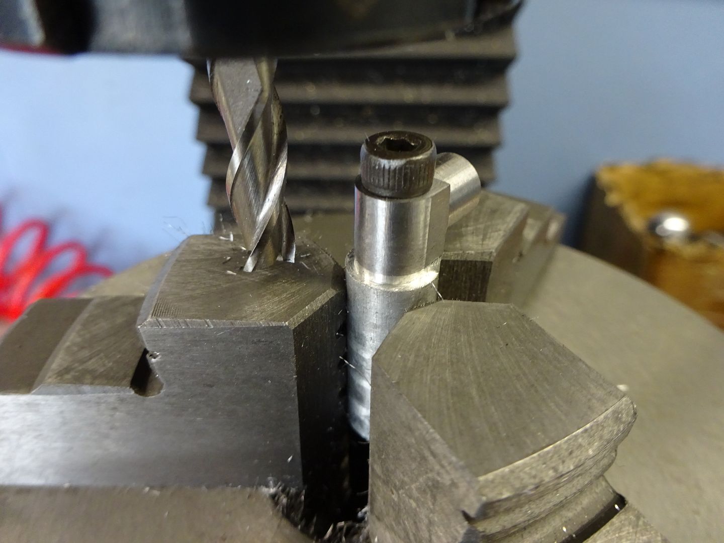

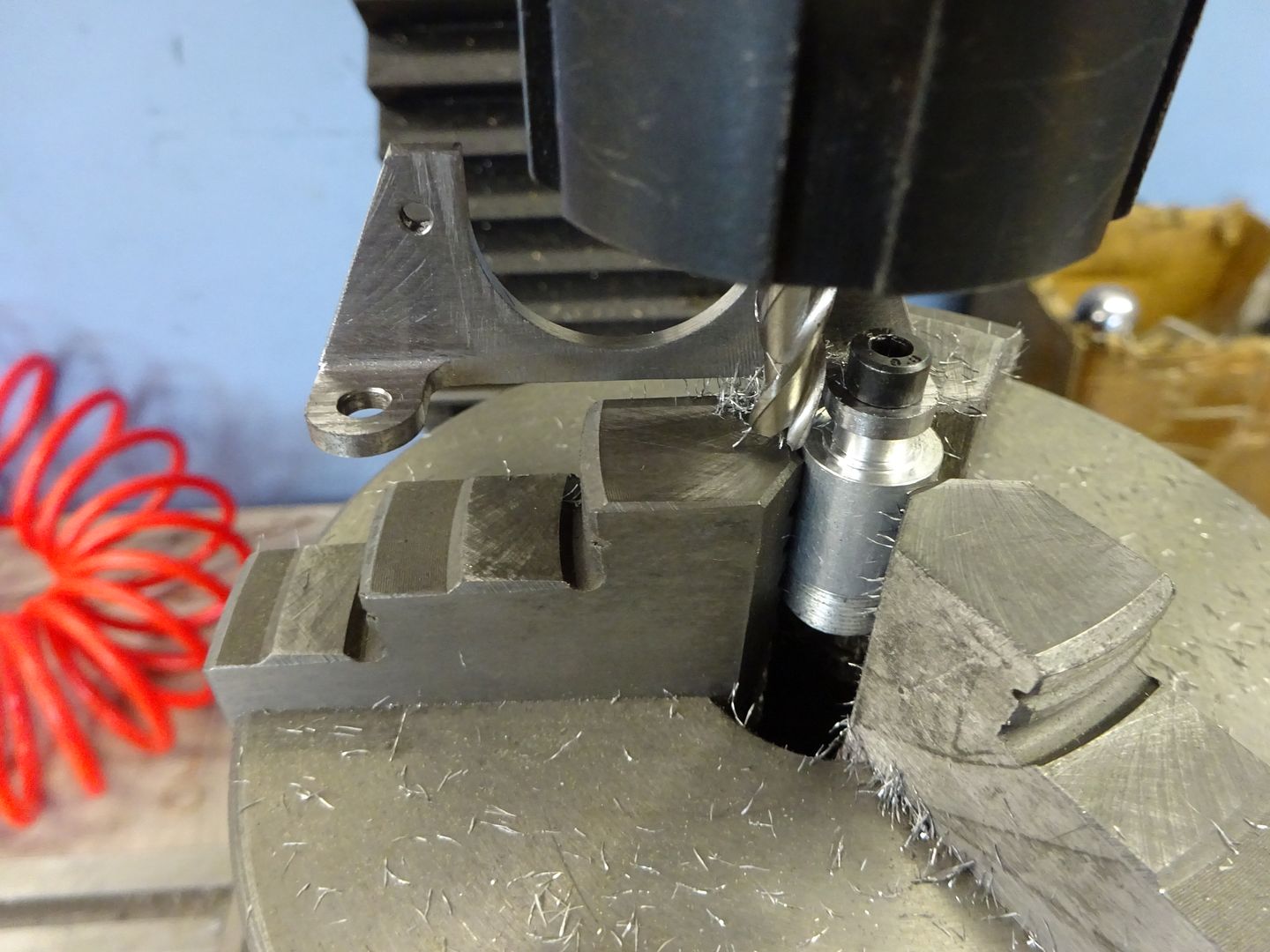

On thing mine get used for quite a lot is rounding over the ends of rods etc, in fact the 6" ARC one tends to stay fixed to the SX2.7 most of the time with it's 3-jaw so it's ready to go for just this type of work. Looking back through the photos of my Victoria build that's the only thing the R/T was used for and all done with the 3-jaw.
Over the years I have built up a fair number of simple arbors which get reused or it's not hard to knock up another and these just go into the chuck and the work screws to those. Not sure I would want to try clamping this 1/4" sq x 3/8" long part direct to the table and still be able to get at it will a 6mm cutter and not hit any clamps
The Cylinder legs may have been easier to clamp being larger but still quicker to just screw to the arbor

Unfortunately said screw would get in the way of machining with the 1.5mm dia cutter so back to doing what suits the job in hand.
If you could not get the chuck in then a 5mm pin held in your collet chuck and lowered into the central hole would locate the part and a couple of small clamps will hold it down by the flange. Zero DRO before raising head and changing to the cutter. Though as I said it could be done without a rotary table too.
