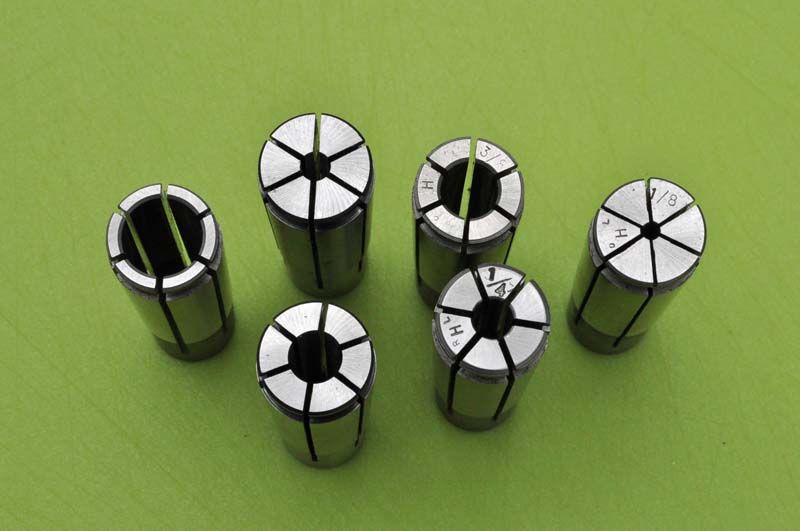

Over the years I have traded various sets and part sets of the Myford collets to get a set that suits my needs. The metric ones are quite tricky to find. My understanding is that the Myford ones were made for them by Crawford Collets but these passed through my hands:
The three marked RHL were subtly different, but still fully functional, from the Myford ones so perhaps Myford weren't the only firm to make use of the Mr Blood's patent.
