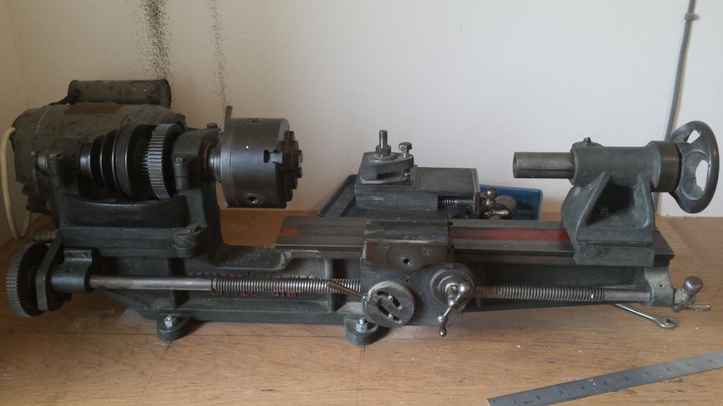

As posted in my newbie introduction I have bought a small 3 1/2" lathe as pictured below. The lathe is a Corbetts "Little Jim". (All the pictures are in an album "Little Jim Lathe" which I think anyone can see.) I know little about lathes although i have read the recommended books, so I need advice and direction.
There are problems and I thought it best to tackle these step by step in this new thread. There is clearly a great pool of experience and talent here so I would really appreciate any advice and this may perhaps be useful to other newbies getting started.

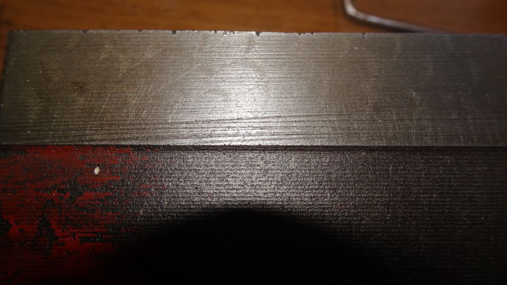

I stripped and cleaned the lathe. Pictures of the bed are attached. I adjusted the gib strips and can eliminate movement, but yes this makes saddle very tight at the tailstock end. I also adjusted the solid headstock bearings and the spindle feels like it has no lateral movement but has some axial slop. How important are these issues? I am more after something to learn on than high precision.
I think the first three issues to address are
- the suitability and speed of the motor.
- stripped threads in the crossslide
- damaged backgear.
If there is something more important to look at first please let me know. I will park the problem with screw gear for now.
Next post will describe the motor issue.

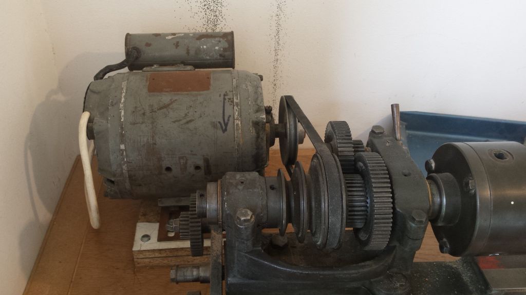

The motor is pictured below. The name plate has been removed. Can anyone guess at the age and horsepower. By the time to wind 30m of thread onto a small spindle I figure it must be a 4 pole motor running at 1500 rpm. Insulation readings are good.
What should I do to service this motor. That capacitor must be pretty old. Should I dismantle and clean? I can see the rotor when looking in the bottom vents and this has two tranverse springs. I thought an induction rotor would be solid so what are these springs for and what if they are old and weak? How do I grease or check the bearings - there is screw on the front above the front bearing, is that for oil/grease.
The 1500rpm at the motor is slightly reduced by the current pulley setup. Is this still too fast for solid bearings, especially since the backgear is not working. What are my options:
- fix the backgear - yes - subject of a later question.
- make a countershaft - any ideas on how/layout would be very welcome.
- VSD - I could be tempted if it is cheap and it would also run my crappy wood lathe. Could a VSD really turn down the speed to something workable.
Any thoughts?
Andrew Johnston05/07/2021 22:59:56
avatar
7061 forum posts
719 photos
Posted by Andy Thompson 3 on 05/07/2021 22:47:07:
Given the motor has a capacitor it'll be single phase. A VFD will not work with a single phase motor. They are designed to work with 3-phase motors. Cheap VFDs operate with constant torque as the frequency (aka motor speed) decreases. Since the speed decreases and the torque stays constant the power available decreases.
Andrew

Andy Thompson 305/07/2021 23:27:18
55 forum posts
57 photos
Thanks Ian.
What tensions both belts? Is the motor and the countershaft all one unit that is hinged and the weight of the motor makes tension.
Since my motor is so big and heavy I was hoping to bolt the motor to the bench or something solid to avoid vibration. I can make a hinged shaft like yours but unsure how to provide tension to both belts.
What range of spindle speed should I aim for.
Andy Thompson 306/07/2021 00:47:06
55 forum posts
57 photos
Thanks Andrew -
Had to research a bit on single phase vfds. I have seen ads for some from ATO but it is more complicated than I thought and I still don't understand. Depens on how the motor capacitor is wired. I guess single phase vfd is not commonly used or available.
Will look at a countershaft.

As others have commented, the motor/countershaft belt tension is fixed by having a slotted base and sliding the motor back & forth. The tension of the countershaft/lathe is set by the swing of the hinge and mine is simply set by a square wooden block under the motor that adjusts the angle used (and also takes the weight of the motor). I don't have my belts too tight, it causes excessive wear and if you have a dig-in (and you will) it's much nicer to have the belt slip. It's a small lathe and on my EW I only use HSS tools. If they are sharp, they will cut.
I've never actually worked out my EW speeds - but the motor-c/s pulley ratio is probably just under 3 to 1 (so somewhere in the 550rpm range) and the countershaft has three settings, the middle one being roughly neutral and the other two stepping up or down by about 200rpm I'd guess. I have a back-gear fitted but rarely use it on the EW.
You can make a more elaborate countershaft set-up with a toggle lever, which can also act as a simple clutch but the simple design works well enough and will get you turning sooner.

Andrew Johnston06/07/2021 09:59:29
avatar
7061 forum posts
719 photos
Posted by Andy Thompson 3 on 06/07/2021 00:47:06:
Just to clarify; a VFD can be single phase or 3-phase power in, but is always 3-phase out. So a VFD can be used to run a 3-phase motor from a single phase supply.
A single phase induction motor is not self-starting as there is no rotating magnetic field. So capacitors/start windings are added to give the motor a nudge on start up. If a single phase motor is run on a variable frequency the parameters of the capacitors and extra windings will be incorrect. Single phase motors are one huge fudge.
On the assumption that a true 3-phase supply is not available I'd use a 4-pole single phase motor along with a countershaft and belt drive.
Andrew

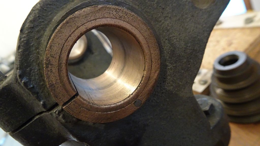

Paul Lousick06/07/2021 12:38:23
2276 forum posts
801 photos
This is one of the problems that I found in the lathe motor when I got it home. The internals were not much better and one of the reasons that I decided to replace it.
Paul.

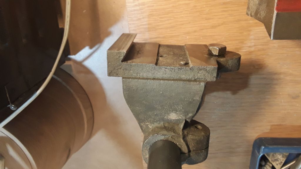

Dave Halford06/07/2021 14:15:38
2536 forum posts
24 photos
The tailstock clamp is wrong, it would not have come with a bolt head to fit a dovetail, using it may damage the slide for future use, cast iron can get nibbled by that setup.
You need another matching cone pulley on a layshaft driven by a 10" or 12" pulley and something like a 2 or 3" on the motor to get the speeds decent as others have said. Current speeds are a bit woodworking.
Andy Thompson 306/07/2021 14:55:22
55 forum posts
57 photos
Thanks guys very helpful.
Andrew - I guess vfd is a non starter! My motor has four teminals and a label - input to 1 and 4 and capacitor to 2 and 3. I guess there are two coils. Out of curiosity, would a vfd with two outputs at 90 deg phase connected to each coil and remove capacitor not work? Any idea why I can see springs on the rotor?
Duffer, Ady1 - I have done domestic electrics and repaired things for decades so reasonably confortable. Earth continuity is fine, insulation is fine and circuit is RCD protected.
Ian, JA, - thanks for pic of your shaft! I understand now. Not sure about those colours JA!
So I am convinced about the need for a shaft and have been out measuring what pulleys I have. With one 4 stepped pulley I think I can get 963/620/349 rpm and 236/151/85 with backgear. That uses 2" pulleys on the motor and smaller on the shaft. I wonder if the belt will slip. It would be better if I could source a 7 or 8 or 9" pulley on a 1/2" boss but that seems to cost a fortune at bearings UK. Their plummer blocks are also very expensive - any better source? Do I really need self aligning bearings? Where did you get that threaded rod to tension?
That motor is so big and heavy that I would like it firmly bolted down. I an thinking of mounting motor and shaft on a skid. The skid can be bolted down but then loosened and moved to change the spindle belts. Does it matter how close the drive and slave pulleys are if I can get a belt short enough? I will experiment and let you see.
Andy Thompson 306/07/2021 15:03:20
55 forum posts
57 photos
Thanks Dave.
Yes that tailstock clamp is very Heath Robinson. Any suggestion to improve. I was just going to angle a piece of 12mm steel and try to drill a bolt hole in just the right place. Will that work?
For others who may not have seen it on my intro thread, the tailstock is pictured below. The upper tailstock is held by the pin you can just see an one bolt. So it can be rotated to parallel the bed but not adjust laterally. Any issue?
