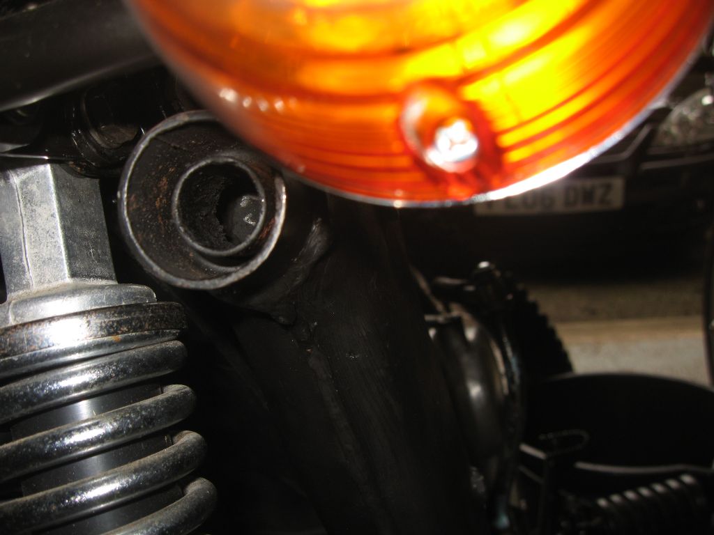

Hello all.
For those of you that have been following the challenges of renovating a Honda SL125, it is now running, on the road, insured and officially an 'historic vehicle'. I am currently 'de-snagging' the vehicle.
A current 'snag' is that the exhaust is (very) loud.
It has an aftermarket muffler which isn't as well engineered (or expensive as an OEM unit - $2999.95 U.S.) but has the correct contours and is aesthetically correct. I propose to modify the aftermarket unit by putting a diffuser in the exhaust stream to hopefully deaden / reduce the sound. I propose that the diffuser will be similar to the OEM design - see item 6 on the sketch below.
This would require removing the existing outlet pipe and an internal baffle (Rotabroach cutter maybe) to provide room for the diffuser.

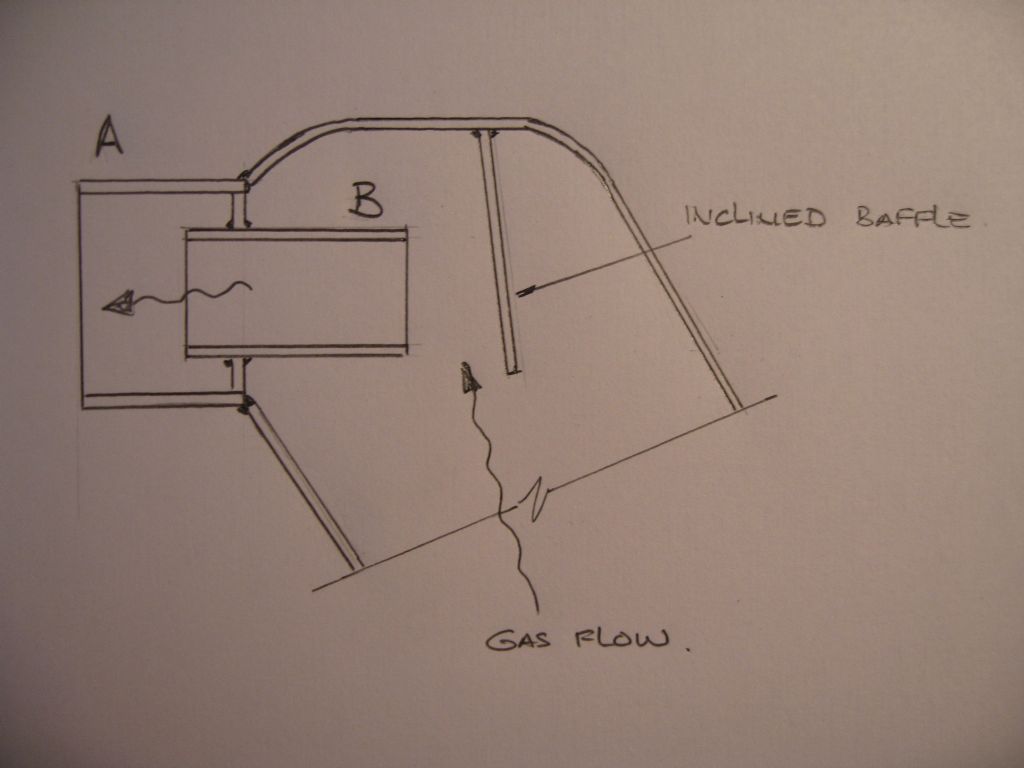

I am relatively confident I could make a diffuser to suit from steel, and that the primary design parameter is that the diffusers combined 'flow gas' area should be not less than the open cross sectional area of the current exhaust outlet.
So my queries are -
Is the above design parameter reasonable and do you think a quieter exhaust note would result?
Are there any other issues I should take into consideration?
Should I leave things as they are and claim ' historic vehicle / old technology' if challenged?
Lastly, and this is the most interesting bit,- have any of you any different solutions that could be applied to this to result in a quieter exhaust.
All the best, and thank you in advance for any input / comments

In answer to your question, I don't know.
My son and I bought this as five boxes of bits. Even the engine was down to its component parts. So we never heard it running.
It does seem to attract a lot of attention when I am riding it, and my neighbours say it is loud.
It is an all welded unit, and it doesn't feel (?) as though it has any packing inside - I may have to have a 'prod' inside to see its there is anything 'spongy' there.
The muffler was bought new, by us, as the old one wasn't present when we bought the bike, but it is an aftermarket unit, which I am positive isn't built / manufactured to the same standard as the OEM equipment (for this particular item).

The outlet on the aftermarket muffler is smaller than the inlet pipe. The actual exhaust pipe is the inner pipe in the photo below.
Redsetter
The inner pipe is welded into the muffler and has a baffle at the end of it. I think this is supposed to emulate the OEM diffuser, but as you comment the baffle does not appear to be doing much. There is a reasonable gap between the end of the inner pipe and the baffle, so I think it is worth making a diffuser to suit this. As mentioned earlier this pipe is smaller than the inlet end, so If this combined reduction in the 'gas flow area' is detrimental to the bikes performance, then that is the time to consider modify the outlet further.
P.S. Just a thought while writing this. The black box on the exhaust system is described as a 'muffler'. Is a muffler an alternative term for silencer or is a muffler technically different to a silencer?

Looking at the photo, the enlarged end of the outlet pipe will have a megaphone effect, somewhat like a loudspeaker cone. Extending the inner pipe, or simply inserting a bush to reduce the outer pipe diameter, might be interesting. Whatever you do, you will have to get it very badly wrong to compromise performance. Let us know how you get on.
I think Muffler is just Chinese/American for Silencer.

I believe what you intend to do will reduce the dB level from your exhaust system, provided the combined area of the wall holes are equal to the existing outlet area performance should be similar.
From the sketch it seems the your new diffuser has a closed front, is that correct ?
However if the outlet area is currently larger than optimum reducing the output area may increase power output with less noise.

That diffuser is basically a simple annular discharge outlet functionally equivalent to a slot outlet fishtail but significantly less effective because the flow path length is the same all round. Properly made fishtails are better because the path length varies depending on where the gas actually comes out of the fishtail and expands into the atmosphere. Considerable potential for destructive interference reducing sound levels. If you are lucky there may even be a bit of pipework in that diffuser giving some sort of reverse flow effects.
Messing about with different styles of diffuser / absorber bungs is likely to be interesting, frustrating and inconclusive in fairly equal measure.
One things for sure as an aftermarket unit the internals were never designed in any real sense of the word. Usual philosophy seems to be "Just stuff something it that looks like it might work." It is, after all quite hard to make a completely ineffective silencer / muffler. Especially when market demand is for something a bit more rorty than standard.
The aftermarket one on my BSA DB32 Gold Star had a single lonely baffle about 2/3 rds of the way along yet was silly quiet up to around 3,500 or so RPM. Above that standard "Who started World War 3" service was resumed. I felt the characteristics well suited to my youthful use. After all successfully creeping in at silly early hours in the morning to be followed by bleary eyed breakfast time maternal interrogation "And what time did you get in last night? I didn't hear anything." not being a standard Goldie specification requirement.
If you really want something effective its probably best to bite the bullet and accept that the back will have to be cut off and proper innards inserted. After experimentation with a relatively crude but near enough the same shape to fit mock up.
For innards consider a pair of hockey stick or "J" shaped pipes with closed ends, one on the inlet and one on the outlet set back to back and overlapping for most of the length of the silencer. Drill holes in opposite sides of the pipes so the gas can get from one to the other. Holes at top end of inlet and bottom end of outlet to give some element of reverse flow and expansion. Maybe add a longitudinal wall between the pair to make the flow behave better and another transverse one at the top end of the inlet pipe to properly close things off.
A second wall at the top would let you further drill the output pipe and stuff in some wadding to make a short absorption silencer which would take out some high frequency sound removing the hard edge to the exhaust note. That would be similar in principle the the short absorption silencer accessory BSA sold to shove up the tailpipe of a Goldie fitted with the proper, baffle-less, "megaphone" silencer properly intended for racing use. Surprisingly effective at rendering the exhaust less offensive but I never felt the real noise levels were much reduced.
A simple pair of J shape pipes is pretty effective though.

Thank you so much for all your input. There are plenty of options for me to try. I have provided a sectional sketch of the outlet end of the muffler below.
I have found a piece of pipe in my 'it may come in useful one day' pile that is a snug fit on the exhaust (diameter A). So first off, I intend to start with just a short extension tube and see what effect that has. I could then try and add some sound insulation on the inside of that and see what effect that has if still noisy. - basically as per Phil P's suggestion.
I will probably try the diffuser style of modification as well just to see how that compares to 'tail pipe' mod.
To answer Emgee's question the diffuser would have a closed end according to the diagram, but my thoughs are to push the diffuser against against the baffle therefore effectively closing off the end.
I will try the easy solutions first before moving on to the more difficult stuff.
