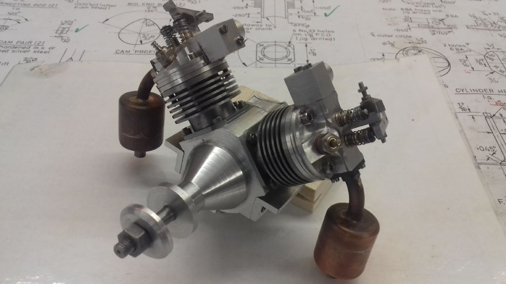

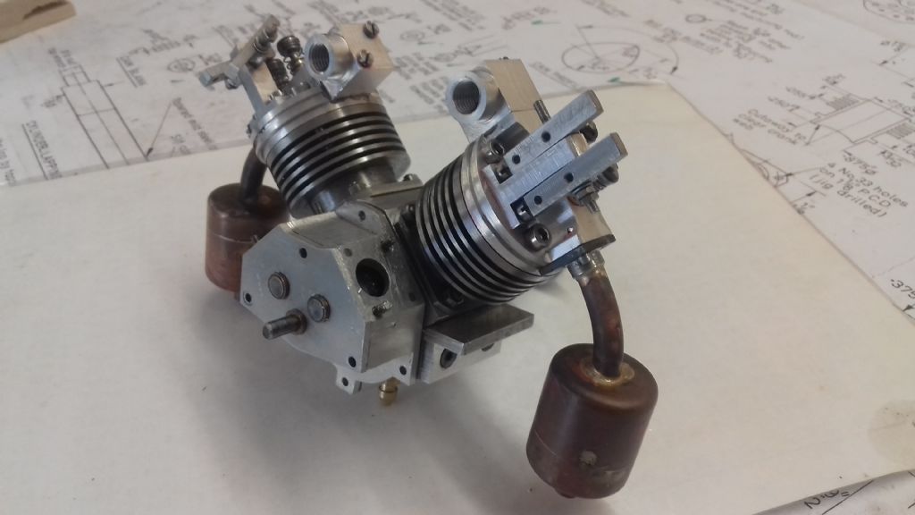

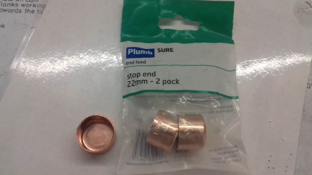

20210620_095613.jpg20210620_095538.jpgHi Guys, Thought I would post a few photos of the Vega progress. I struggled with making the exhausts so trip to B&Q and a visit to the plumbing section got me a couple of these 22mm copper end caps. I took each cap and drilled the 1/4" holes either end. I then cut one cap down to give me the required length as per the plan. I joined the halves together using a nut and bolt and silver solder together. Not as elegant perhaps but maybe a wee pollish will help.20210620_095503.jpg

Engine is looking good, a bit of black BBQ paint is another option for exhausts and silencers.
Alan Gordon 420/06/2021 14:18:11
129 forum posts
13 photos
Hi Jason,
Thought about that, but on the assumption that it will run !!!!! I was concerned that the paint would peel off due to heat,
However I was thinking about using a car / motorcycle exhaust paint which I assume would be more resistant,
If anyone has other alternative ideas ?
Emgee20/06/2021 14:33:48
2610 forum posts
312 photos
Nickel or chrome plating may look good but I would just use some black heat resistant paint.

JasonB20/06/2021 14:45:00
avatar
25215 forum posts
3105 photos
1 articles
The BBQ paint is heat resistant. I use a stove paint and have not had problems with that coming off exhausts
