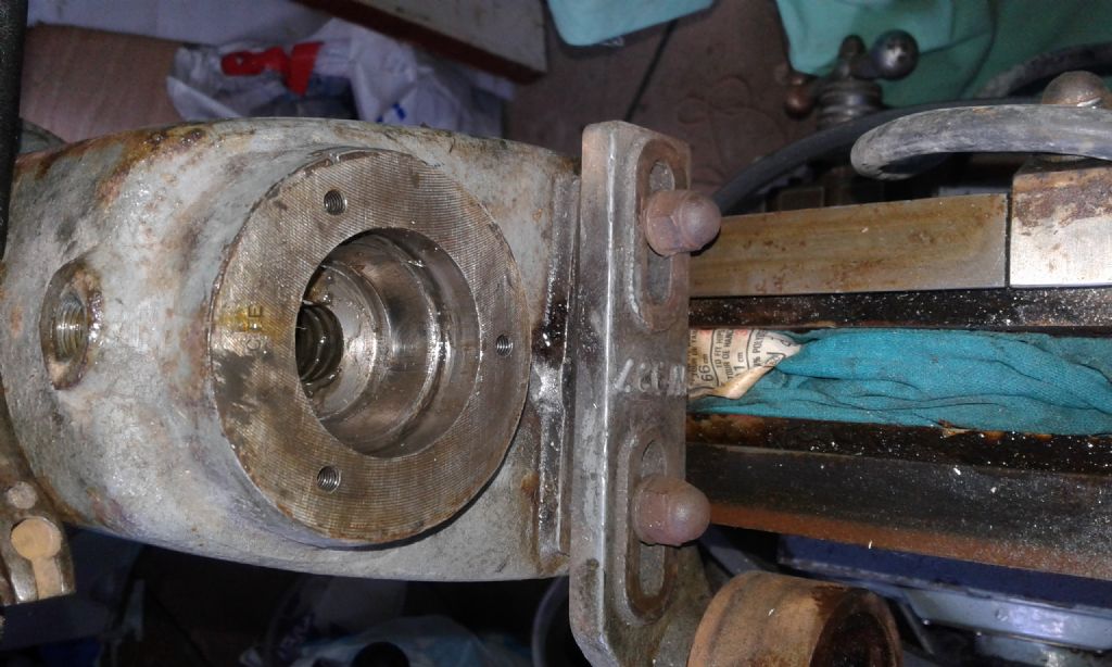

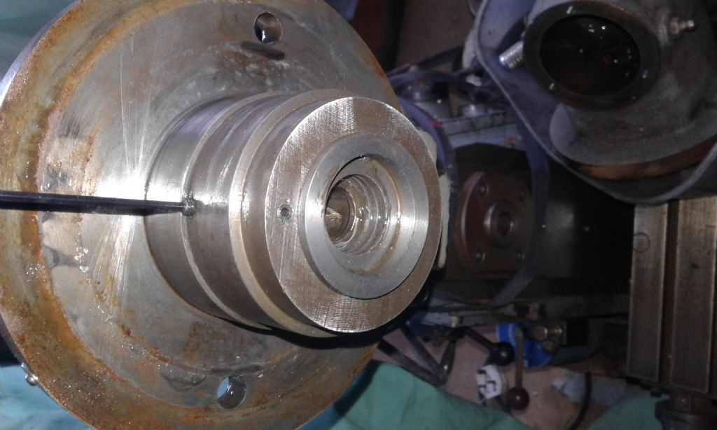

front of main body of the vertical headcentec vertical head rear bearingHi. I've recently bought a Centec 2a which needs a bit of work. I've run into a bit of a problem with the bearings on the horizontal drive shaft within the main body of the vertical head. A v-belt that was too short (and so too tight) had been used, which I think has contributed to the rear bearing rollers being pitted and scored. I've got the shaft out no problem, but the rear bearing outer race is up a bit of a blind alley (I hope the 2nd photo will make it clear) with no way of getting a bearing puller onto it, and no way of getting a drift in behind. Any good tricks to get it out?
(sorry, but photos are on their sides!)
Also, does anyone know how to get to the front bearing? I can see where it is, but can't work out how to get there! There is a grub-screw on the top (see photo 1), and maybe one on the front face (although I can't find an allen key to fit it), but I can't see what they might release. Has anyone been here before and can offer some advice. I can't find a section drawing of the vertical head to refer to.
Many thanks.
Phil in Cornwall.

Thanks for your help Dave. I have managed to make a bit of progress today. Very carefully putting a tapered brass drift down the hole under the grease nipple moved the outer shell a bit, and then a couple of hours of making up some brass levers and using them etc got it out. For future reference, the bearing is a Timken, numbered 03062 on the inner race, 03162 on the outer. I think the front one is the same but I haven't cleaned the filthy grease off yet.
Better lighting revealed a second grub screw at a 9 o'clock position at the front, which allowed access to the front bearing. Just waiting for the parts now.

You've done it now but it's not good practice to use a brass drift to knock out bearings. Any small bits of brass left from the drift and not removed completely will ruin your new bearings. Use steel as it's much less likely to chip and won't hurt a hardened bearing. This was a golden rule when I was an apprentice at British Timken.

Machine up a steel disc to fit into the bore of the outer shell of the bearing,tack weld it in place using arc welder,then use a stout steel rod down the spindle bore,beat it out. this allows a blow inline with bearing bore and the welding tends to shrink the bearing slightly and loosen it. Done this many times removing sleeve double row ball bearings from lorry steering gears,good earner until my friend who reconditioned motor parts bought his own welder.

You've probably sorted it now, but two of the grubscrews (BA) are plugs for the grease way and there is one at the side which holds the flange for the spindle.
