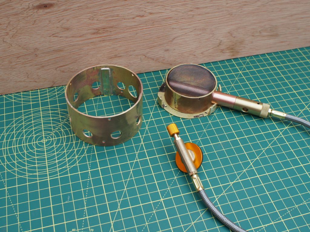

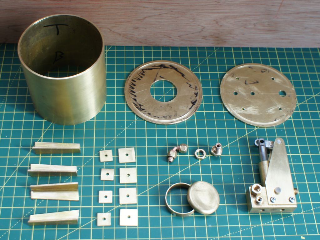

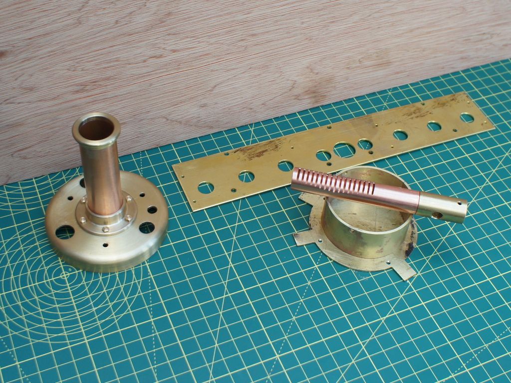

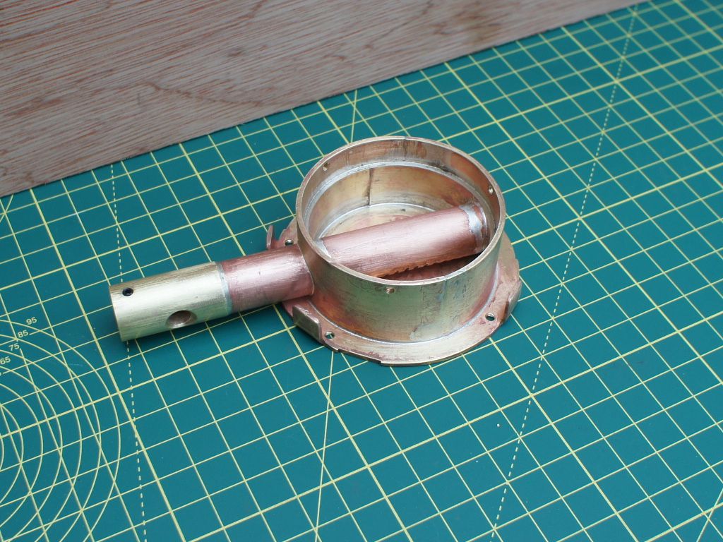

As mentioned in my introductory post a few weeks ago, I'm currently working on building an ME Boiler to power my recently completed Stuart 10V.
So I thought I'd post an update of the progress I've made since then.
I was in the process of making the components for the firebox and burner, which you can again see here.
meboiler_2
And I've now formed and silver soldered the firebox, along with the rest of the components for the burner which are test fitted together with a camping gas regulator and hose.
meboiler_4
The burner components and firebox base silver soldered together
meboiler_5

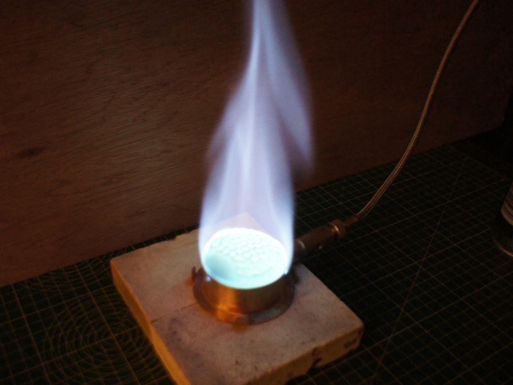

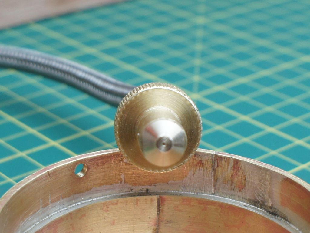

I also had a go at drilling my own gas jet.
The design calls for a No8 jet, which appears to be 0.25mm. The smallest drill I had was 0.3, so I went with that for now.
meboiler_6
And, it works!
The flame is a bit large when the regulator is fully open, due to the slightly bigger jet size, but is otherwise stable and burns cleanly over the full range.
I can tweak it later once it's running in the firebox with the boiler fitted.

Careful when you fire it up for the first time - I found that the flame had a habit of coming out of the lighting hole which charred the cladding. In the end I made a brass plug for the hole to stop it happening. This was with a ceramic burner rather than the fabricated one.

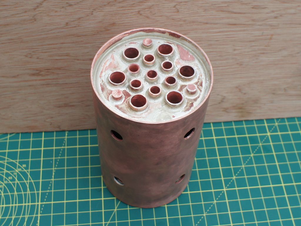

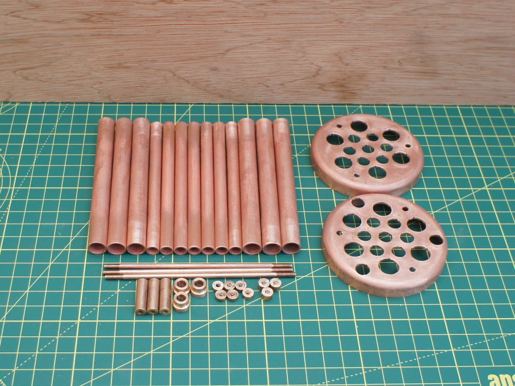

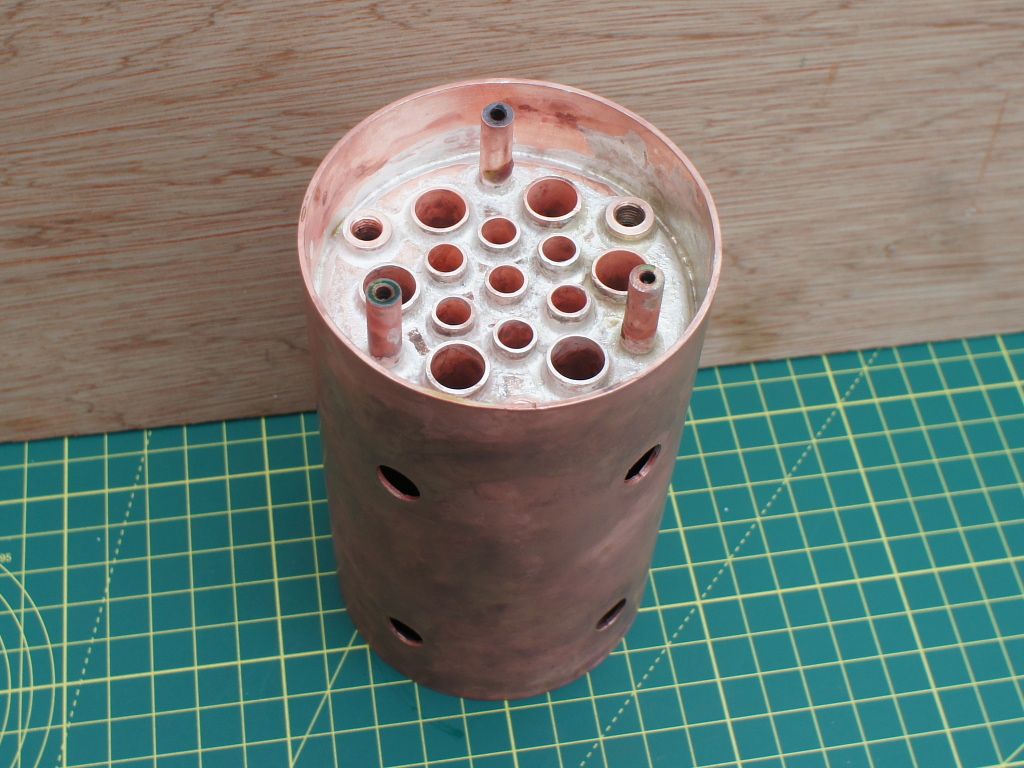

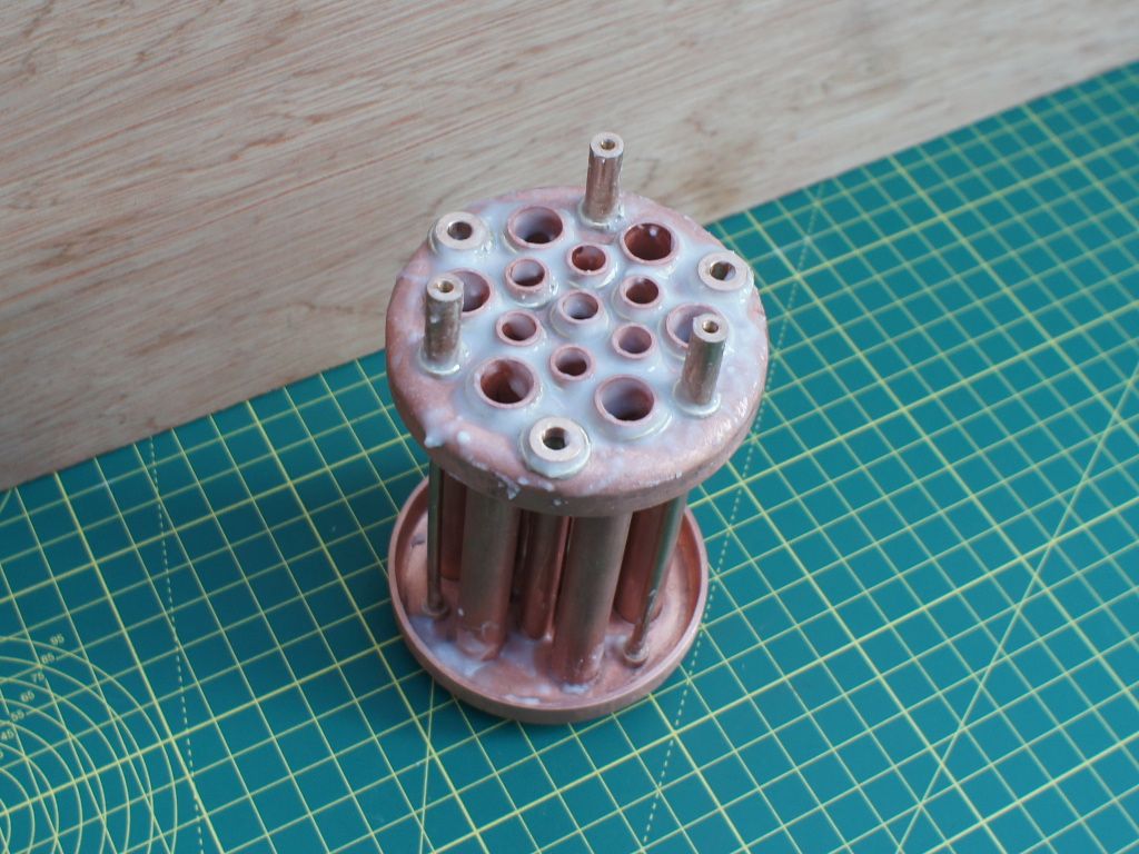

So the time has come to make a start on the nerve wracking part, actually silver soldering the boiler together.
The internal parts laid out ready for assembly...
meboiler_10

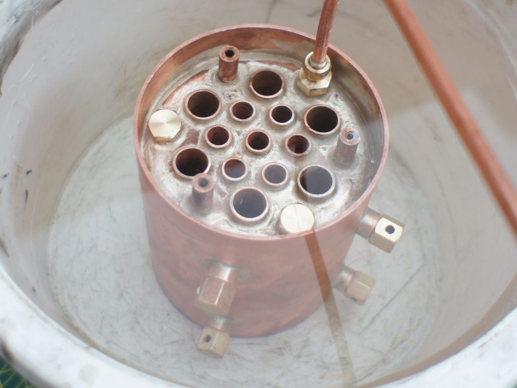

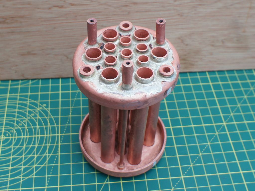

All fitted together and fluxed up with the solder.
meboiler_11

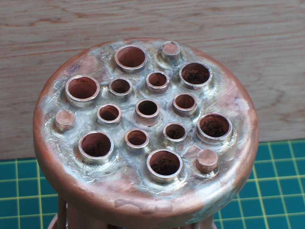

First side done, and after coming out of the pickle it's looking good so far....
meboiler_12
So repeat for the second side, and oops, something has gone wrong!
meboiler_13
I'm not sure why, but the solder has just not taken on the centre tube and I didn't spot it at the time.
So time to heat it all up and try again, thankfully it all worked out much better the second time.
After double checking that the solder had properly penetrated on both sides and I was completely happy,

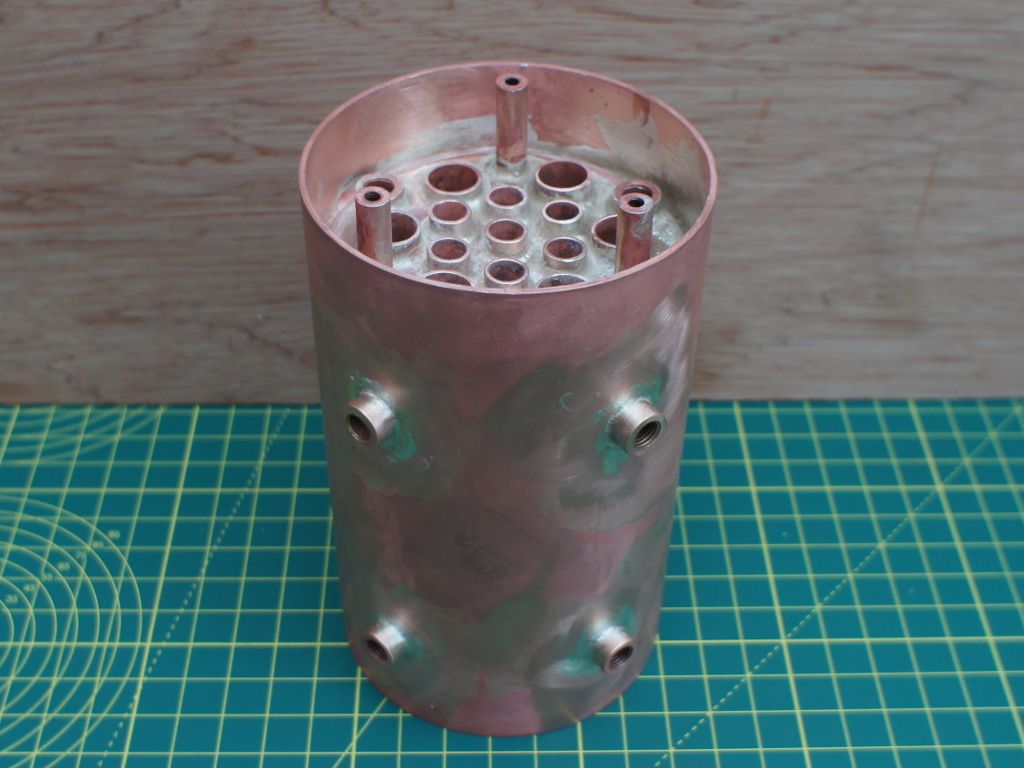

I did a final drilling and tapping of the bushes to make sure they were truly vertical, and then it was time to fit it into the outer shell.
meboiler_14
And the bottom end, where you can also see the now fixed centre tube.
meboiler_15
The final step was to solder in the bushes into the boiler shell.
A couple of them were a bit wobbly, so I made the protection plugs with cross-drilled holes so I could run a stainless rod through them for alignment.
meboiler_16
And it's done!
meboiler_17
Next step, the pressure test!!
fizzy20/03/2021 16:36:53
avatar
1860 forum posts
121 photos
Dominic hit the nail on the head! When you try to light yours there will likely be a lot of flames from the chimney top and none down below. A 0.3mm jet is massive, you will get much better results using a no.3 jet or at a push a no.5 jet. Using your current set up, assuming you can get the burner to light will give off huge amounts of hydrocarbons so whatever you do, dont use it indoors. Gas burners dont work well with multi tube boilers, or at least not as well as they do in single flue boilers with cross tubes. I make boilers and burners for a living (well I did until Brexit!) and am happy to advise fellow enthusiasts so if you get stuck feel free to pm me. Boiler is looking sound and very well made!
MarkR20/03/2021 17:25:02
17 forum posts
45 photos
Thanks for the warnings Dominic and fizzy.
I was eager to see if it would work at all, and the 0.3mm hole 'only' being 50% over the recommended size in terms of area, I just went with what I had.
However that does result in a huge flame unless you turn the regulator right down, so as you say, I think even the recommended no8 will be far too large.
I've now got a set of carbide drills going down to 0.1mm, so it will be interesting to see if I can successfully drill something that small, and if not I can buy a suitable jet.

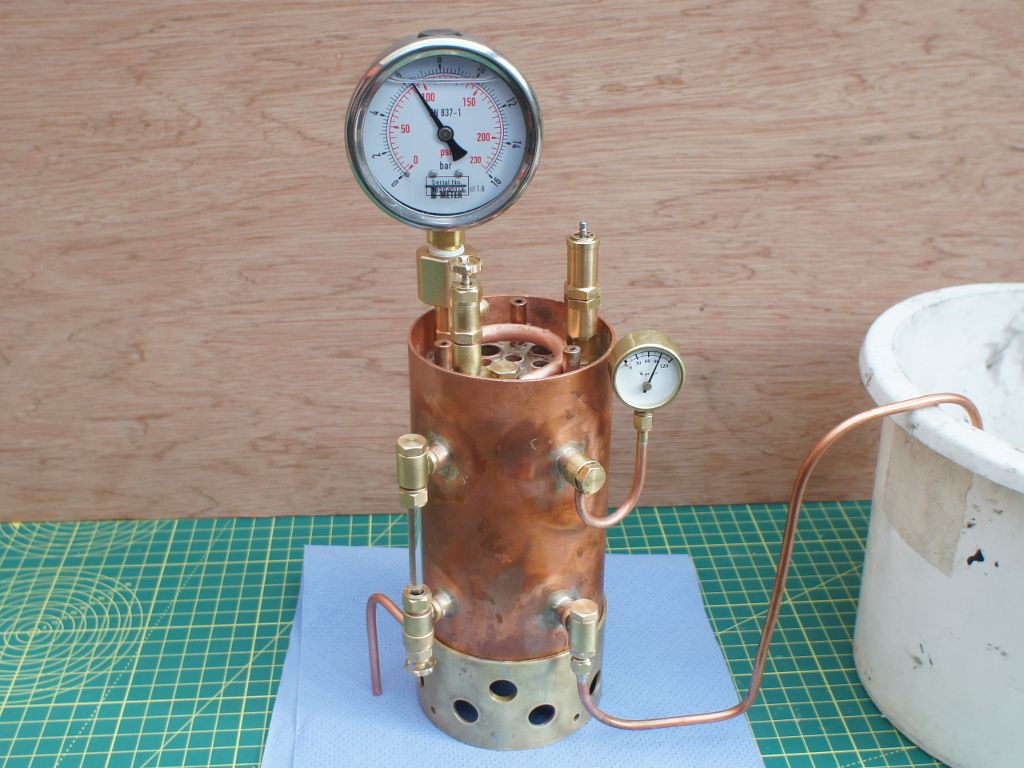

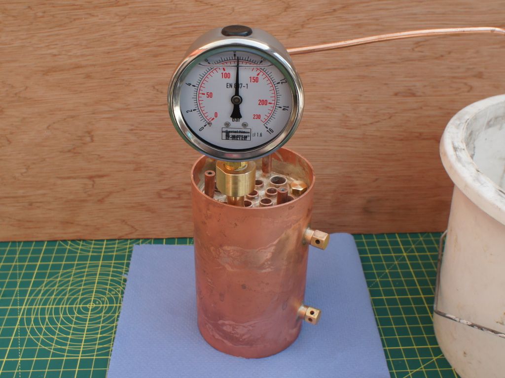

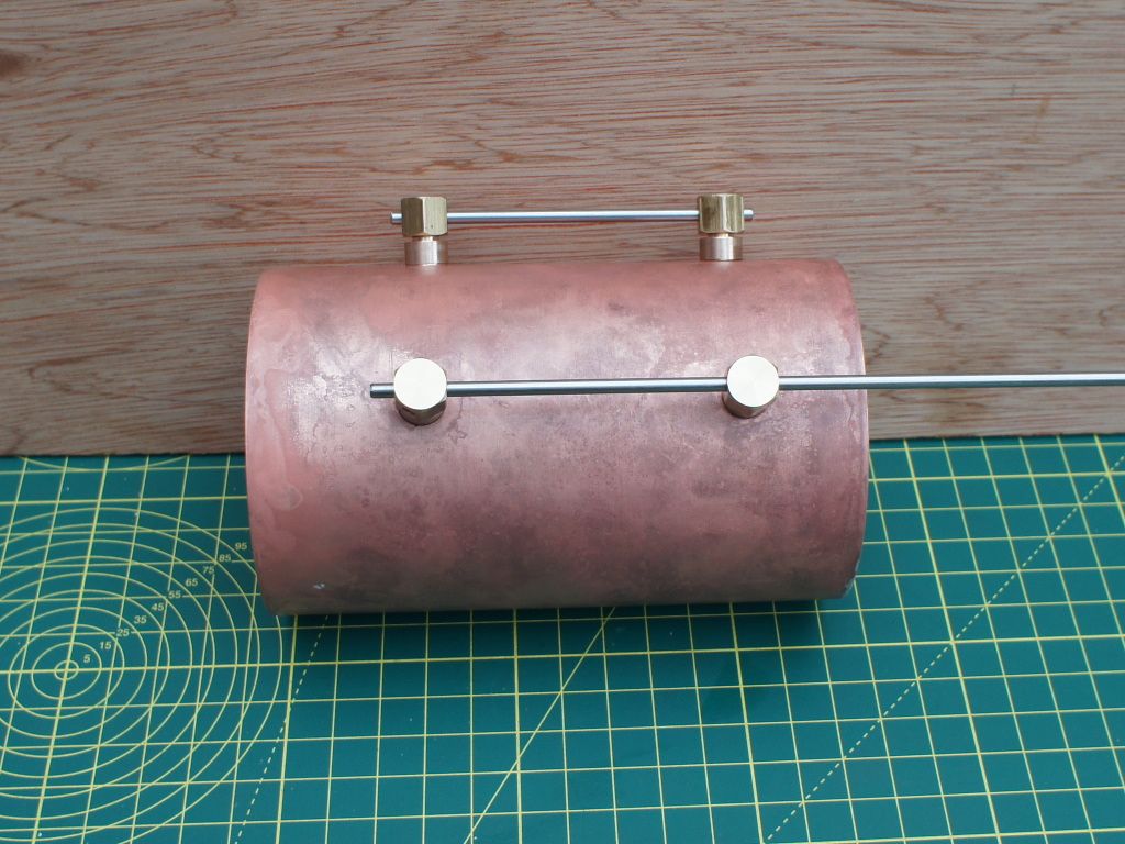

I made up the various plugs and adaptors, and did a quick test with some air at 5psi to check for any obvious leaks and get all the plugs properly sealed.
meboiler_18
After fitting the pressure gauge and pump, I tried bringing it up to pressure but couldn't get it to hold much above 50psi, with it leaking down fairly quickly with anything higher than that.
The problem was the ball valves in the pump, and despite my efforts to fix the seating I could only get it up to about 80psi, so I ordered some some nitrile balls which solved the issue.
meboiler_19
So for the rest of the fittings, I think I'm going to modify the design to use separate parts for the ball seats, rather than using the angled D-bit for cutting the seat in the single piece bodies.
JasonB25/03/2021 13:04:58
avatar
25215 forum posts
3105 photos
1 articles
You really want a valve in the line so you can isolate the pump once things are upto pressure which eliminates any losses through the pump.
Also not sure how you are doing the higher pressure tests but you want to fill the boiler with water as it is safer if things should go wrong. Low pressure air is OK for an initial bubble test.
MarkR25/03/2021 13:55:07
17 forum posts
45 photos
Hi Jason,
The full pressure test was a hydraulic test, which might not be clear from my description/picture.
In the second pricture, the pipe is going off to the pump in the bucket of water.
My next step was to make a separate valve if I couldn't get the pump to seal, but the nitrile balls solved the problem, and I was able to leave the boiler like that for half an hour before I let the pressure out.

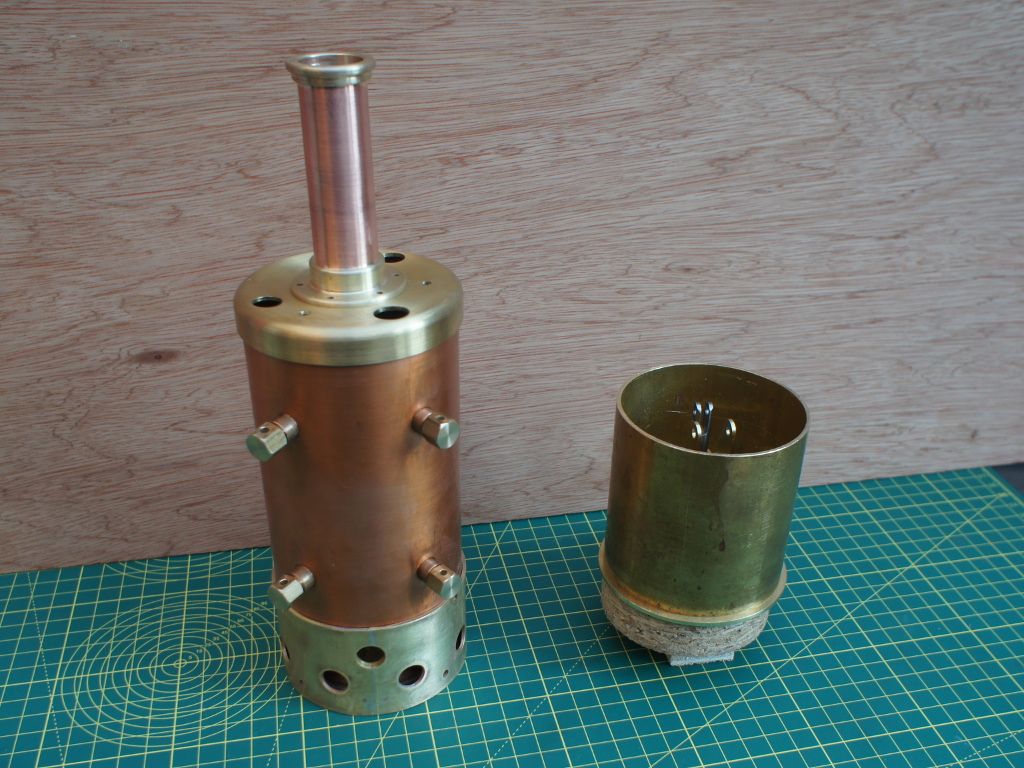

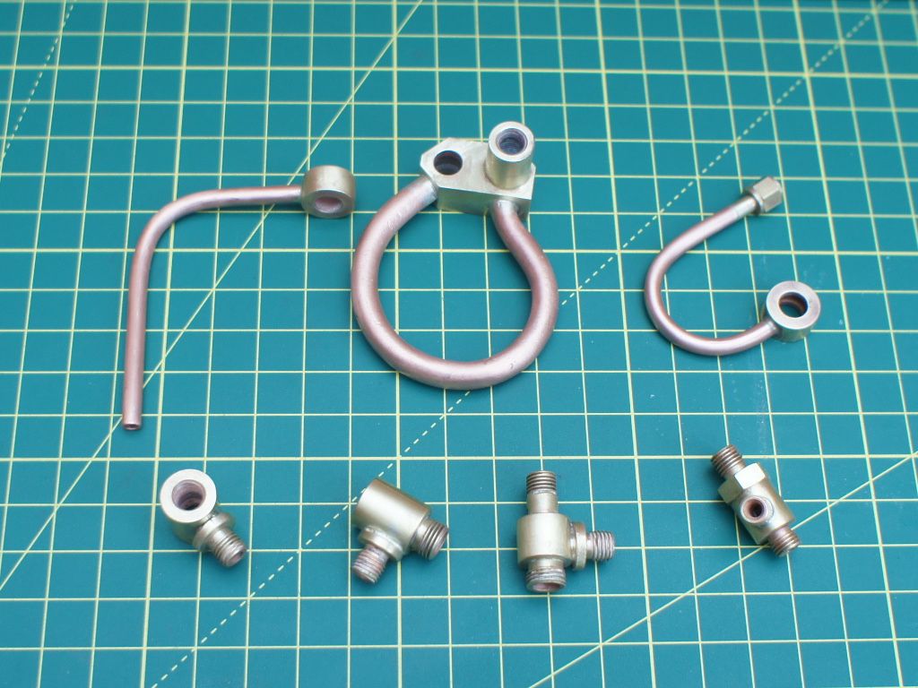

MarkR14/04/2021 17:33:26
17 forum posts
45 photos
So as mentioned above, I decided to make the fittings a bit differently from the design.
Making all the valve seats separate components so they could be turned more precisely rather than using the angled D-bits internally.
I also turned the bodies down leaving only hex sections where needed, which results in a much nicer look than the plain blocky hexes of the original.
meboiler_20
The various right-angle parts silver soldered together, along with the pipes.
meboiler_21
I think I'll have to make a proper miniature pipe bender at some point, as bending that superheater to fit correctly around evertthing was much more tricky than it first appears.

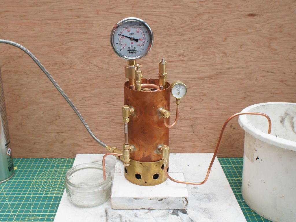

Everything assembled on the boiler, and hydraulically tested to 1.5xWP to check for any leaks.
meboiler_22
And finally on to the the actual steam test.
As Dominic warned above, the flame does want to come out of the lighting hole unless you turn the gas right down. But even at that very minimal setting it only takes a few minutes to raise the pressure, so I'll have to make further adjustments to limit everything to a sensible range.
In the mean time I set the safety valve to keep within working pressure while using the maximum 'not setting the boiler on fire' gas level.
meboiler_24
There is one slightly annoying issue, in that once the safety valve has opened, it never seems to quite close completely again unless the pressure has dropped by quite a bit, sometimes as low as 40psi. Although just a gentle press on the stem seems to fix it until the next time it opens.
Dominic Bramley14/04/2021 19:29:42
60 forum posts
1 photos
Good job! I agree - your turned down fittings definitely look better than the original. Tempted to redo my safety valve body now!
Cheers
Dom
Gerhard Novak15/04/2021 21:13:37
avatar
109 forum posts
114 photos
" There is one slightly annoying issue, in that once the safety valve has opened, it never seems to quite close completely again unless the pressure has dropped by quite a bit, sometimes as low as 40psi. Although just a gentle press on the stem seems to fix it until the next time it opens. "
See if you can do a "pop" valve. They have a kind of piston above the valve which helps to open safely and when it closes the pressure was that for the larger piston, so the smaller valve will pressed firmly into its seat. I tried one, probably my precision wasn't good enough. I worked most of the times but not always. (Well it opened but jamed when it should close...)
MarkR15/04/2021 22:35:53
17 forum posts
45 photos
Yes I may give that a go Gerhard.
Do you know if the 'tri-wing' design in Harris boilermaking book still a good one to base it off, or are there better ones I can copy from any recent ME articles?
Jeff Dayman15/04/2021 23:00:59
2356 forum posts
47 photos
The safety valve designs published by Gordon Smith some years ago work very well and re-seat quickly. Search this site - Jason Ballamy published a link to the designs some time ago.

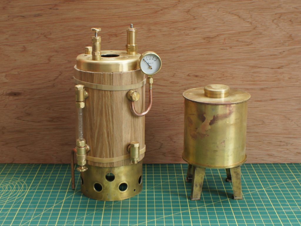

MarkR22/06/2021 14:23:45
17 forum posts
45 photos

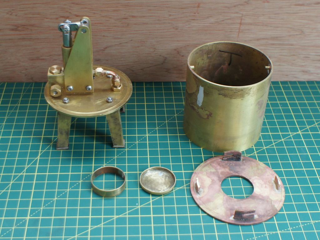

As mentioned previously, rather than just having the rather blocky hand pump sitting next to the boiler I decided to build a water tower to make everything look a bit nicer.
So in the photograph below, you can see all the components ready for assembly. The most tricky bit being the legs being milled from 1/2" brass angle, with both a taper and and angle across the top and base to hopefully give a pleasing appearance when all fitted together.
meboiler_26
In this photograph you can see the legs have been silver-soldered to their top and bottom pads and bolted to the base. The lid has had has some flanges added to it to provide a 'bayonet' style attachment with the two pins soldered in place to the body. The cap and 'neck' were flanged and rolled from sheet brass.
meboiler_27
The lagging strips for the boiler took a lot more effort than expected, mainly because I couldn't find any wood of a suitable thickness. So I had to make a bunch of planks starting from larger stock. Here they are temporarily mounted to the boiler alongside the assembled water tower.
meboiler_28

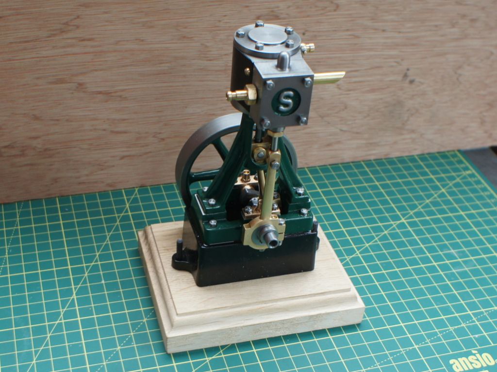

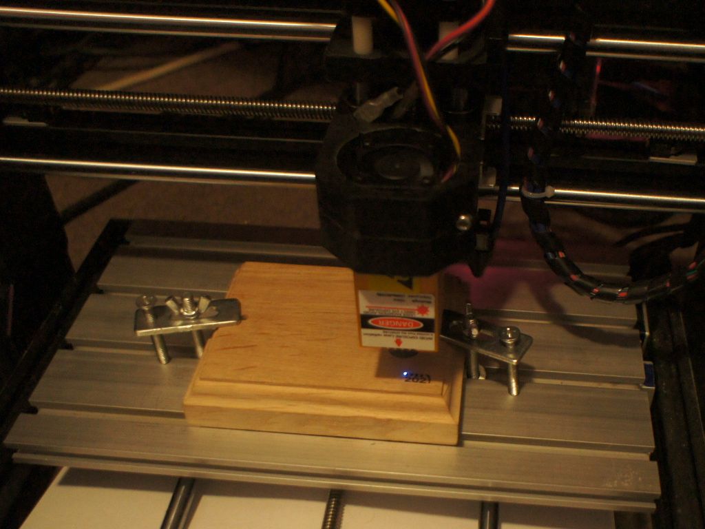

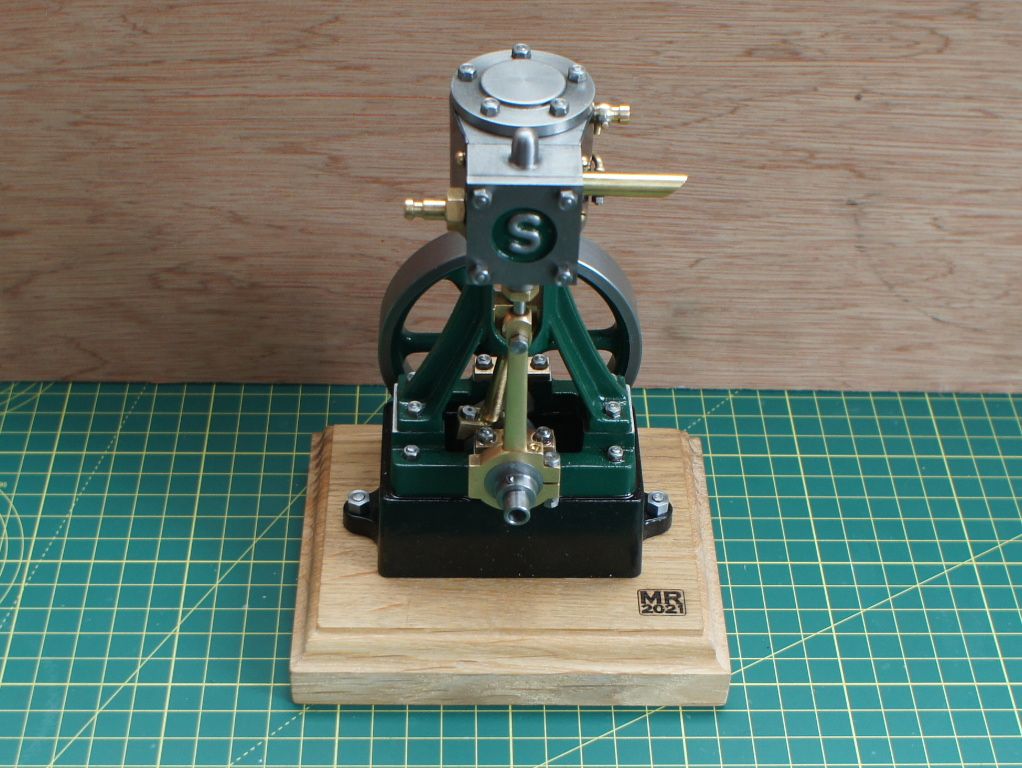

I also finally got round to making a proper base for my 10V after getting myself a set small router bits.
I did this in the mill, lacking a suitable router table, but even with the realtively low spindle speed the surface finish was still very good on the block of oak.
meboiler_29
After a few tests getting the settings correct for the wood I had used, I laser etched the base with my initials.
meboiler_30
And here's the finished item after finishing the base and mounting the engine.
meboiler_31
