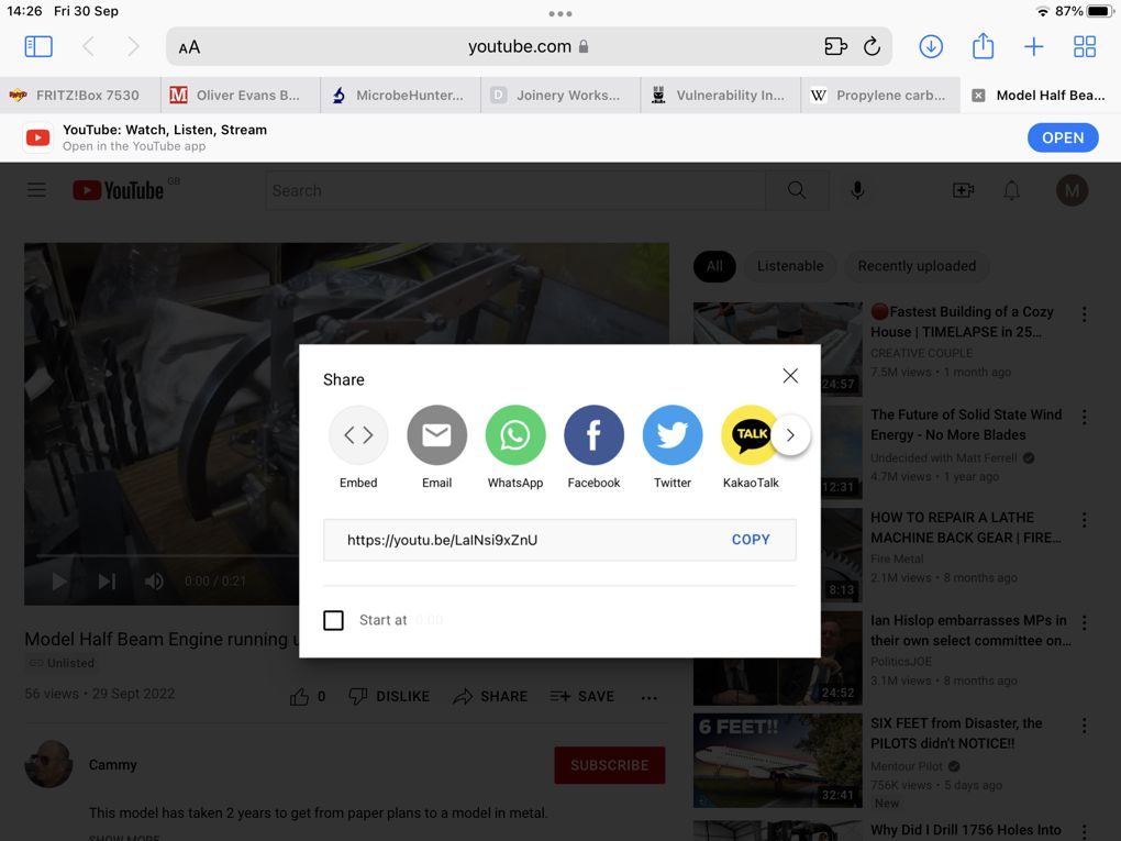

It was the first time I'd used you tube and it had me running round in circles and the only things it offered to share with were all the well known apps and a lot more which didn't give me any option than to post the URL. Thanks again Michael.

It’s actually pretty easy once you click < Embed >
