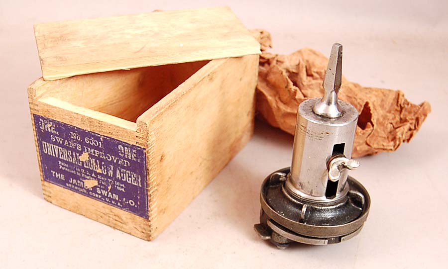

Hi All,
I am not often stuck with woodwork tools but bought this in an auction box of tools with just a bad photo to go on.
I thought it was a a chair makers spindle rounder by SWAN of the USA but it isn't!
I cannot work out what it is for, can anyone shed any light please, there are no apparent makers marks?
Cheers, Martin
Clay Jones01/03/2021 19:01:10
37 forum posts
1 photos
Carpenter myself but never seen anything like that. The fact it has a tang may be suggests it’s use is via a Carpenters brace and possibly used to lock onto some form of spindel for further grip/torque? Keen to know myself.

External threading tool?
JasonB01/03/2021 19:16:55
avatar
25215 forum posts
3105 photos
1 articles
Dowel Cutter?

Could be a tool for forming tenons on dowel spindles, does it have cutting blades ?

This says it's a tennon cutter

This also has it as a Swan hollow auger for cutting tennons

Not sure if I have because Martin says it is not one of those?

Hi Jason,
You have it just right!
I have never seen one of these and it did not click in my brain that it is for round parallel sided tenons.
The "normal" Swan cutters make different sizes of conical ends on spindles, they come in set sizes and rarely in adjustable form a bit like the one shown.
They are almost always clearly marked SWAN USA but not this one unless it is somewhere when I take it apart?

Dalboy01/03/2021 21:17:57
avatar
1009 forum posts
305 photos
It is a tenon making tool for use mainly by wheelwrights to put round tenons on the end of the spokes to go into the felloes

Hi all,
I have dismantled the unit and sharpened the cutters, replaced the very worn cutter locking screws with 3/16W cap screws (kept the originals to go with it!)
The main thread is very fine and required careful removal but after degunking all the rubbish now turns easily and smoothly. The adjustment mechanism is just like that on a scroll chuck, again all crudded up but now free turning.
Absolutely no sign of any makers marks! Just numbering of the scroll parts.
Be interesting to see how it does.
Cheers, Martin
