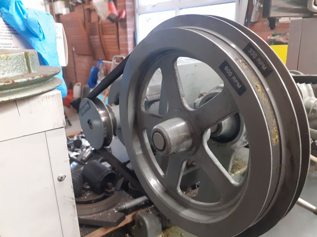

The top speed of my Myford M type is meant to be 840 RPM. I tested it today and found it is 600 RPM.
The motor plate states 1425 RPM.
I do not wish to change the large countershaft pulley which is 8.25" dia.
So I'm thinking I can increase the motor pulley which is currently 1.75" dia.
Having looked on line at cast iron pulleys (I don't want Ali) I currently have two pulley options for the motor. One is 2.25" dia, the other 3.25" dia.
As my arithmetic abilities are less than great, could someone please advise which is likely to be my better option to increase the top speed by around 240RPM?

As Hollowpoint says, 2.25 is the better option on the face of it. The arithmetic says 2.45 ins PCD is needed, so 3.25 is a step too far.
The arithmetic is simple enough - new pulley dia = 1.75 x 840/600 = 2.45
But I'm profoundly suspicious that all is not that simple for the speed to be that far off the mark. Lathes.co.uk says 874 rpm is the top speed, and 600 rpm is the next speed down. Seems a bit basic, but are we missing a trick here?
What speed is the input motor actually doing? If you can check the spindle speed can you check what the motor is doing?
Is this a flat belt final drive?

Chris V14/02/2021 14:43:16
avatar
313 forum posts
42 photos
Ok great thank you all for trying to help me.
First off Simon, yes my mistake my top desired speed is 874 RPM not 840 RPM.
Yes its all flat belts.
I just went out and checked and the motor is indeed running at 1425 RPM as near as I can see using my vintage Smiths RPM counter.
Whats missing? Well my large countershaft pulley although period is not the original and is one step only.
So looks like I'm achieving one step down from top speed as stated on Lathes.co.uk. That's stating 12 speeds utilising back gear as well, I have 6 speeds which is fine for now.
Oh the countershaft speed I just checked is 285 RPM.
Hope that clarifies!

Simon Williams 314/02/2021 15:41:23
728 forum posts
90 photos
Posted by Chris V on 14/02/2021 15:27:00:
Lastly if the 2.25" option is going to only get me part way to my top desired speed, an I correct in my understanding a 2.5" pulley = 857 RPM?
Agreed.
However there is a complication which confuses things, particularly with significant differences between driver and driver (correction driven) diameters.
The actual running ratio of flat pulleys is properly calculated using the effective neutral radius of the belt wrapped round the pulley. That means that the smaller pulley in the drive (the driven pulley in the second stage, the driver pulley in the first stage) is effectively BIGGER than it's outside diameter. The same is true of the bigger pulley, but this has a smaller effect.
In this example you got two corrections which must nearly cancel each other. But don't be too surprised if the calculated speed isn't spot on with the reality.
I'm sure I'm not alone in looking forward to seeing how the results turn out in due course. Do let us know.
Your comments about needing double pulleys for the first stage are right, at least to maintain approximately the same centre distance of the pulleys. But with flat belts this will make the whole arrangement bigger and bulkier.

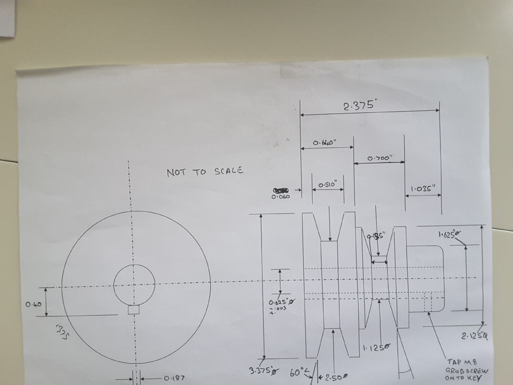

David George 114/02/2021 16:06:18
avatar
2110 forum posts
565 photos
The original pully sizes are motor pully 3 3/8" and 2 1/8"
Intermediate pully 8" and 9"
This is the pully drawing for the motor I made.
David
Chris V14/02/2021 16:51:34
avatar
313 forum posts
42 photos
Ah thank you David, that's good to know for reference!
Chris.
Howard Lewis14/02/2021 17:56:32
7227 forum posts
21 photos
Coming in late.
1425/600 = 2.375. 1425 /870 = 1.637931 1.75 x 1.637931 = 2.5375
So by changing just the motor pulley to a 2.5 " you would get 857, or close to your desired 870 rpm
With a 2.5 " motor pulley, all other speed would b be increased by a factor of 1.638.
Howard

Chris V25/02/2021 15:45:00
avatar
313 forum posts
42 photos
Feedback! (-: Success!
Once the supplier re sent the correct size pulley that I'd ordered ie 2.5" I bored it out this morning and fitted the new belt. Checked the top spindle speed and its 860 RPM, quite noticeably faster, so job done.
Many thanks to all that helped me with this!
