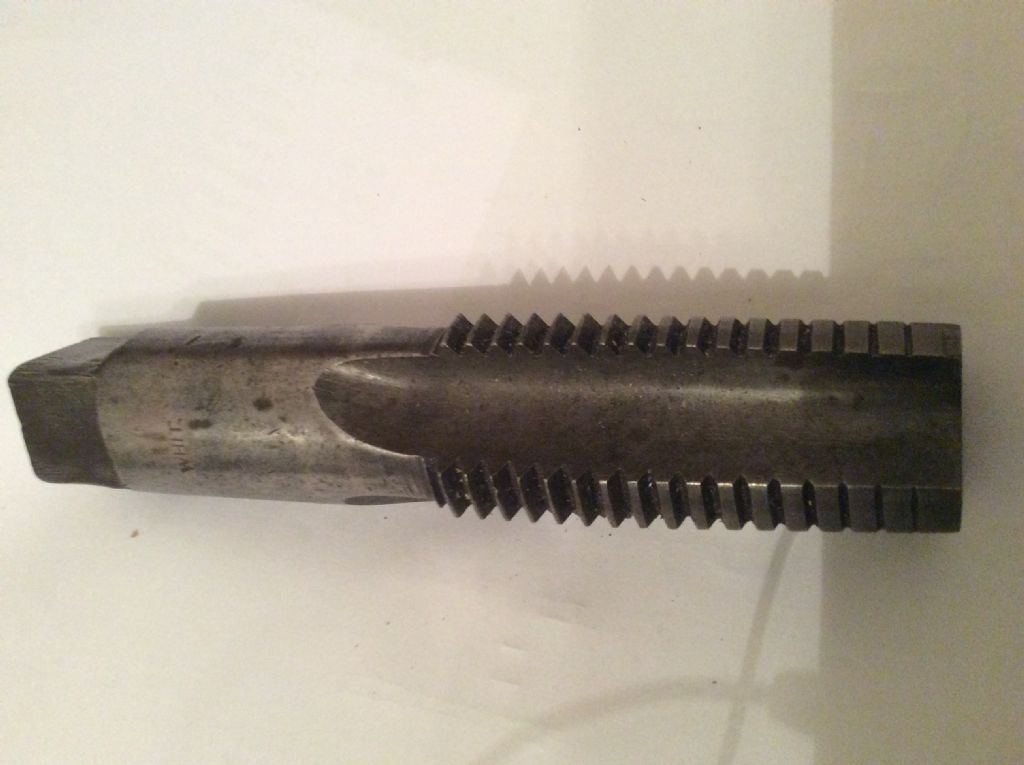

The lathe I'm using is a Toss 26A. Removed from production (I'm guessing) when the bed slide tightened for accuracy nearer the chuck caused the rest of the movement to be tight. So, not super accurate!
However, I've used it to great effect in making parts I could not otherwise buy.
I would like to use it to make metal parts for my wood lathe. I could not get a chuck with a BSW 1.5 x 6TPI thread to fit the head stock, so I bought one with a M33 thread with the intension of boring it out and re- threading it BSW.
I have a bar (S1 2M- SCLCR09).
looking at the bar I don't think it is big enough to hold an insert deep enough to cut the required thread depth. Would I be better to just get a rombic 55 degree tip rather than a toothed insert?
I really don't want to spend mega bucks getting this tooling as I may only need to do this once or twice.
Any help would be greatly appreciated.

Could you not just make a simple boring bar and use a HSS tool bit ground to 55* ?
I made two backplates for my lathe like that ,simple and cheap.

This is what I did to a broken BSW tap to use it for my backplate threads. I wanted 8 TPI BSW x 1.75", this started off as 1" x 8 BSW tap. If you could get a scrap 6 TPI tap with just one good tooth it would make a useable tool.

If you go down the tapping route you will need to screw cut it first so why not just make a single point internal screw cutting tool. I'm pretty sure you will not get a screwcutting tip for your S1 2M- SCLCR09 boring bar

It’s nigh on impossible to cut this size thread in steel with a tap without first screw cutting a close impression of the thread.
i cut lengths of alloy studding this size and run a die down to clean it up after screw cutting and do it in the lathe and the motor (3hp) at 50 rpm is close to stalling and using all my strength to hold on the die holder

I would forget taps and go down Larry's route making a boring bar with a HSS tool ground to the thread form and dependant on the capabilities of your machine I would consider setting the top slide to 27 1/2 deg thus reducing cutting forces on a large thread.
The first thing i would make is a gauge to ensure your new back plate will fit your wood lathe spindle, To do this measure the spindle using the 3 wire system then make a male duplicate to the same dimension over the wires the as long as that fits your female backplate thread you know it will fit the spindle.

I ground a TC tip to match the set screw thread and then cut the chuck thread.
I was mistaken when I said I had a taper tap, it is actually a 2nd cut.
When I checked the turned thread with the tap, only a tiny amount of material was removed and with ease..... to say I'm pleased is an understatement!
