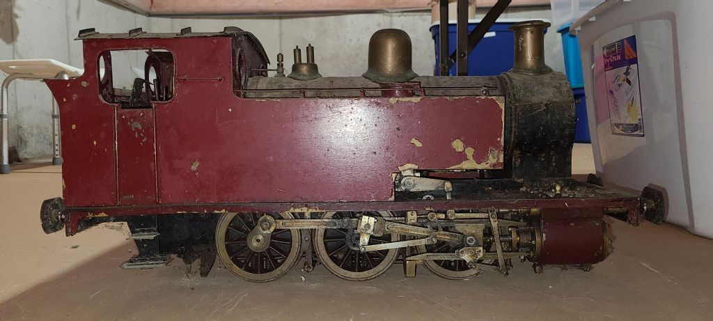

I inherited Butch years ago from my uncle - who built it with his father in Kent. I shipped it to Canada and have brought it with me through several moves but I have never done anything with it.
It has obviously been fired in the past (there is soot in the smoke stack and ash in the pan etc) but not for at least 40 years and probably closer to 50!
I am a professional mechanical engineer, but a complete newbie at model engineering with no tools or equipment other than a decent work bench with standard tools. Is it possible to clean Butch up and bring it (him?) back to life? Am I crazy to even contemplate this as a project I could undertake? I do understand that a pressure test of the boiler and confirmation of the safety valve reliability and settings would be a pre-requisite to actually lighting a flame!
Any thoughts, advice or other comments will be gratefully received. Thanks, Philbutch.jpg

The Butch is a good, sturdy design and several are giving good service in the UK. Ideally, you will strip it down to the last nut and bolt, then rebuild to the standard you want.
The big question is whether the boiler was made to a reasonable standard in the first place, and there is a good chance it was. Over time, there will have been minimal corrosive effect on the copper or silver solder used in its manufacture. Bronze bushes and fittings will be fine, but if any brass was used anywhere that might have become porous from dezincification.
When stripped and plugged with screw in plugs and o-rings, the boiler should be filled with water and hydraulically pumped up to one and a half times its normal working pressure of 90psi. If there are no leaks you are clear to go on to the next stage which is to see how to get it registered and tested with a Canadian authority. I will leave a transatlantic cousin to explain that as I have no idea.

The Butch design has a good reputation.Your's looks to have been well constructed, with plenty of detail etc. so a fair guess is that she was a good runner in her day., and perhaps could be once again with plenty of TLC. With luck the motion-work will still be in reasonable fettle but cleaning and adjustment will be required. Your main task will be examining and testing the boiler. It looks a bit shabby, probably really needs to be taken off the chassis for a proper look, given its age.
All in all, quite a task, but mainly hand-work rather than machining.
Best of luck, esp. with the boiler.

Butch is a good working design. They are almost always well built, perhaps because the design was not aimed at beginners. They steam well, and are powerful and easy to drive and fire. Perhaps lacking in adhesive weight, but on the other hand light enough for one person to lift. I wish I still had mine.
Clearly your boiler will have to be inspected and tested, and for this it has to come out of the chassis which is not a particularly difficult job.
Do not dismantle the chassis just for the sake of it. If it turns over freely, there probably isn't much wrong with it and you can test it on compressed air. Many locos end their lives taken to pieces for an overhaul that never happens. .
