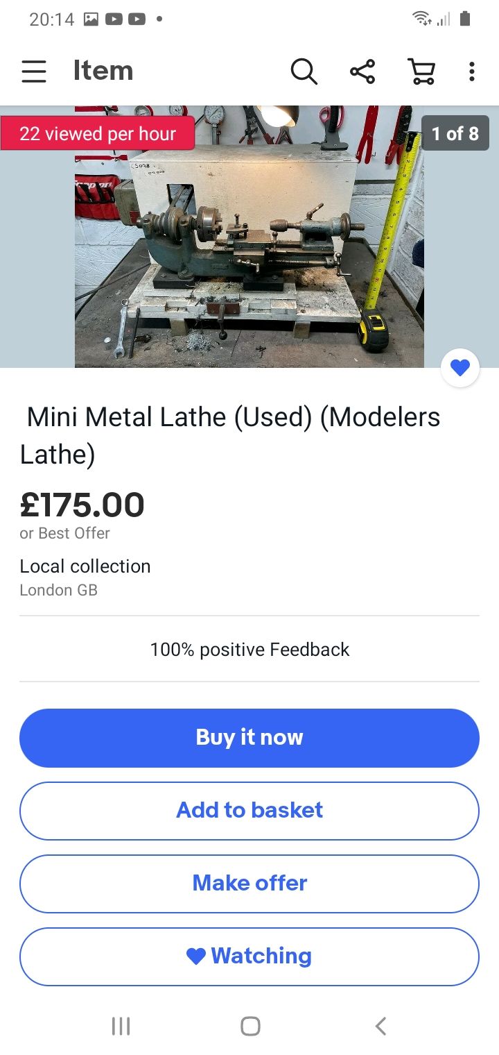

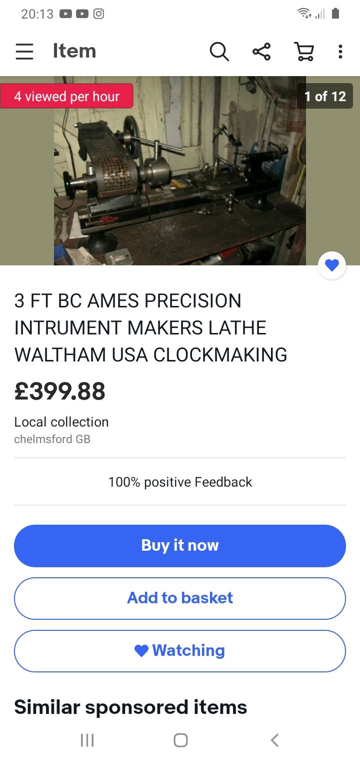

I've seen a couple of local to me items I'm interested in having a look at and wondered if any members could give me some pointers if there are clear issues with them...
I can't figure out how to add screen shots to the thread or the Ebay links but they are titled as;
Mini metal lathe used for £175 in leytonstone london listing number 303837932861
And
3ft bc ames precision for £399 in chelmsford essex listing number 264991693192
Many thanks and I know it's a lot of asks...my thinking was neither are a lot of money and can always move them on if I advance or don't take to it...

The mini metal lathe looks like a york in the pictures and there is a thread on here about a restored one that I think is beautiful...

Both interesting antique machines, but in my opinion not really suitable for a beginner.

Both obsolete, rare, and difficult to get parts for, and if they don't come with a complete set of chucks and tooling, or need rectification work, that will be a problem, and any major repairs will need another lathe to do them on, plus the skills...
The York looks reasonable value assuming it is not worn out - impossible to tell just from pictures - but it is a very small lathe so may not suit your requirements. It only appears to have one chuck, and I would guess that it has a direct drive from a motor behind the back board and no countershaft, so it will run rather too fast for some model engineering jobs. Not too difficult to put that right, and chucks and so on can be found, but it will be a steep learning curve and may get expensive for a very basic lathe. It depends what sort of work you want to do.
If you are a beginner it is difficult to assess a used machine. I think it would be preferable to spend a bit more money and start with a new mini lathe from, for example, Arc, Chester or Warco - perhaps not perfect machines but good value, not worn out before you start, and they have a good knowledge base, and readily available spares and accessories. Also, try and find someone who can show you some basic techniques, and how to use it safely.
I'm going to leave it there, as others will no doubt like to comment.

Both of these lathes are overpriced as always witnessed by the number of watchers on buy it now items. It's a good measure of how many people can't quite believe the asking price.
The advantage of old stuff like this is you won't blow a circuit board or smash a plastic gear by being heavy handed.
The Ames is worth £150, the York is too small to do much with plus the headstock bearings are crude

The Ames is just a very over priced peach, the York also has no means of making a measured cut. There are no graduated collars to be seen on the lead screws.
You can tell a lot from photos, look carefully.
