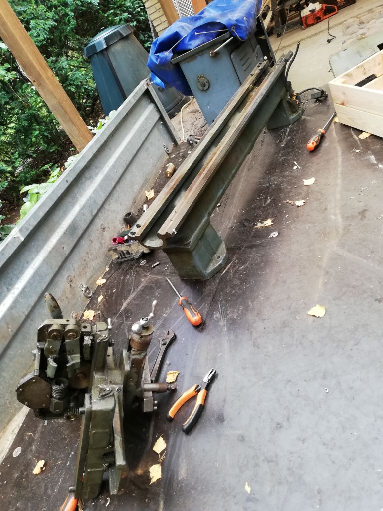

The lathe had been dismantled by the previous owner, and this should prove beneficial to me, since I could handle it on my own.
Here you see it on the trailer, just arrived.

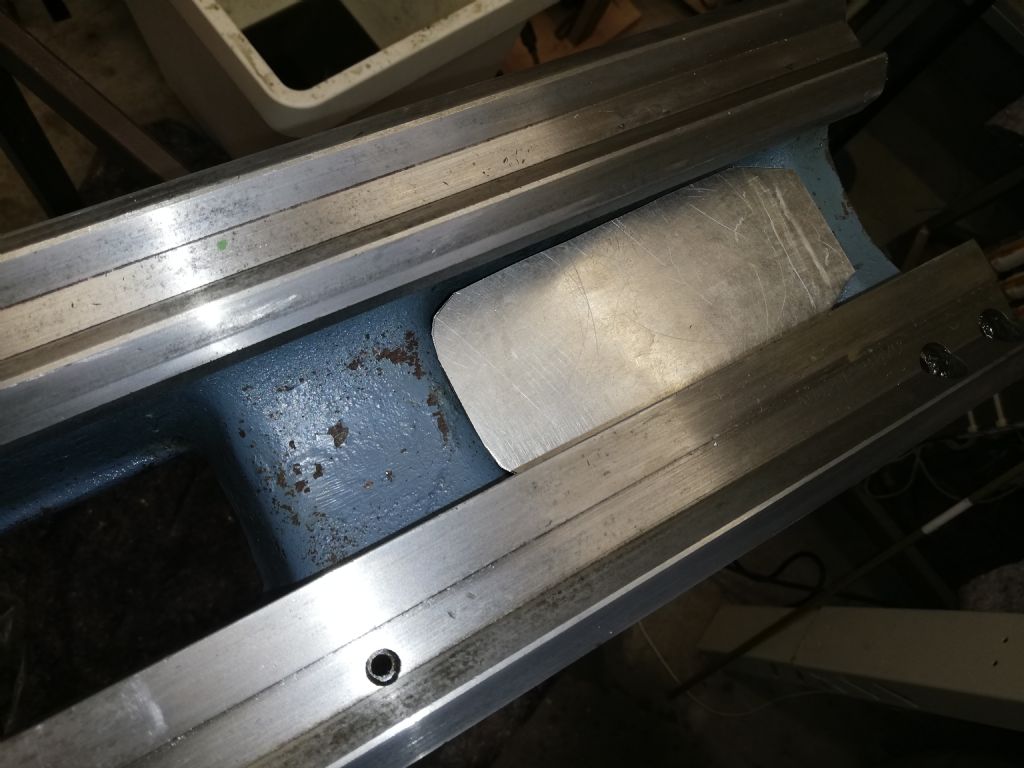

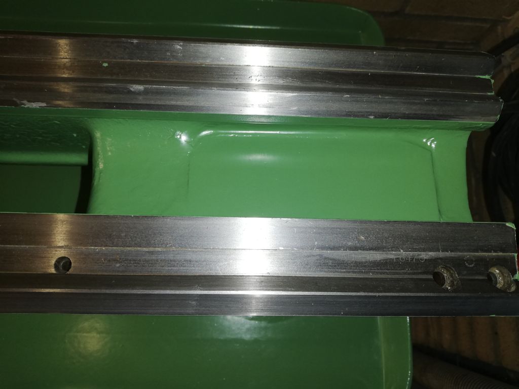

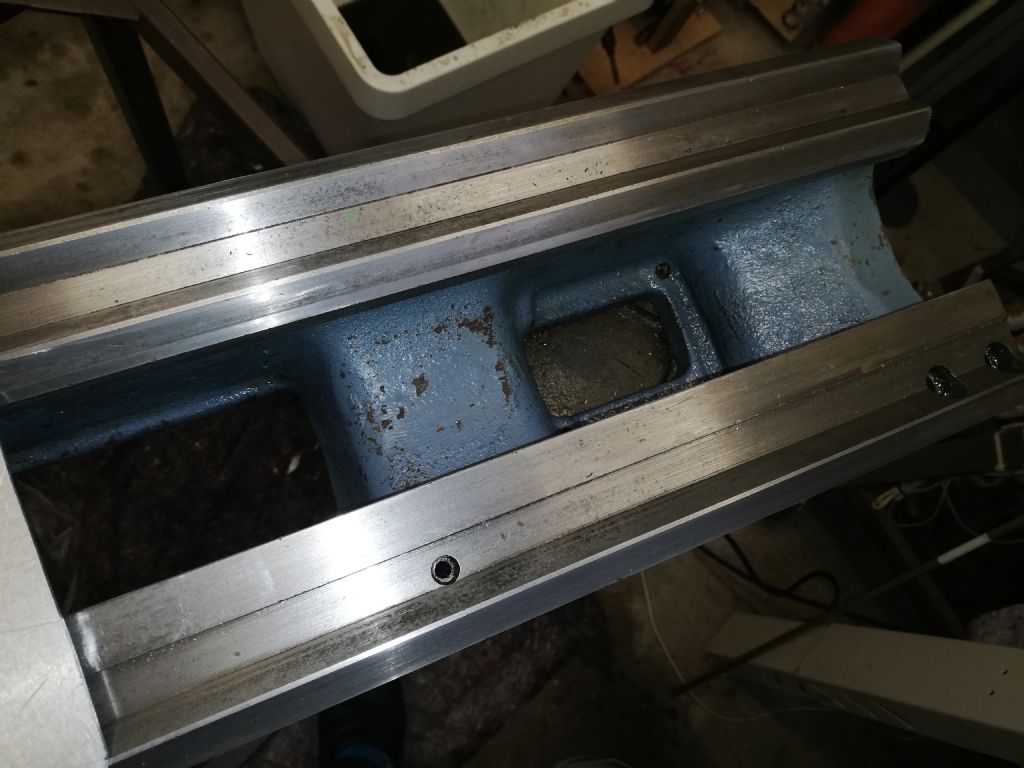

There are a couple of goofs on the bed of a boxford, the first is the pit for swarf and coolant right under the parking space of the tailstock, at the far end of the bed.
I sealed it off with a aluminium plate
And that should take care of an otherwise annoying cleaning task.

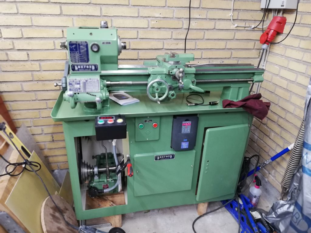

I sent the stand to sand blasting and priming, and this saved me a lot of time and effort, and produced a wonderfull finish.

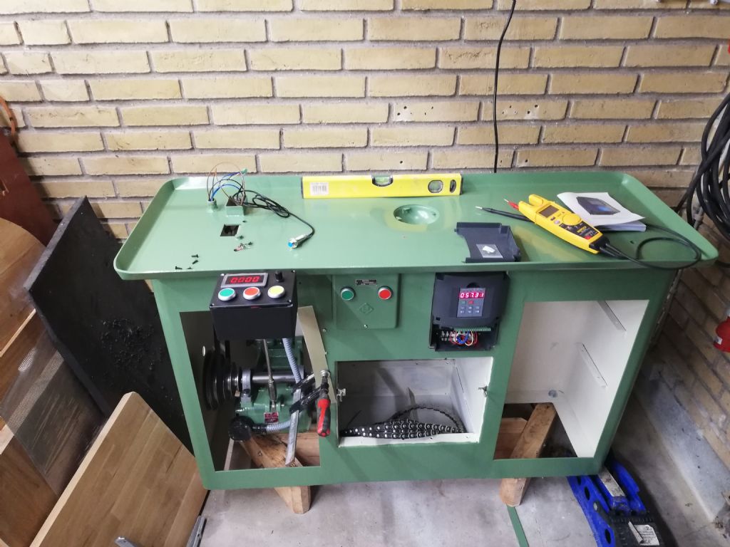

You can see that I added a VFD to the machine, a 4kW unit, which can stop the motor in ¼ of a secont without going into overvolt tripping. This VFD has an annoyingly loud fan, which got replaced.

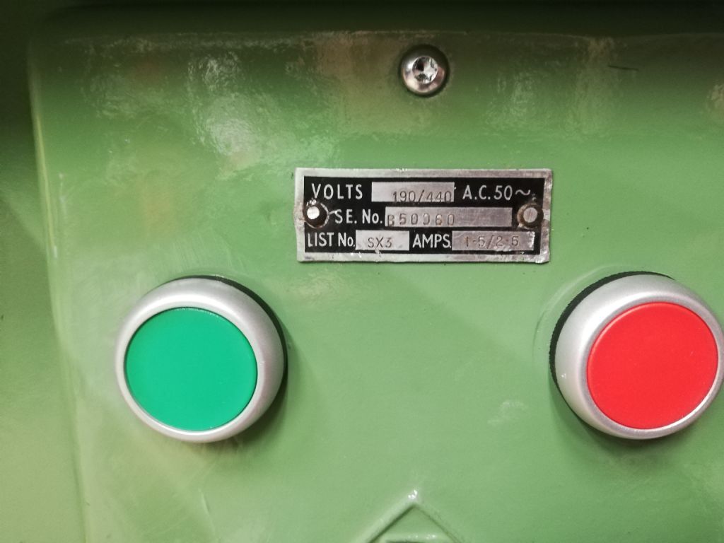

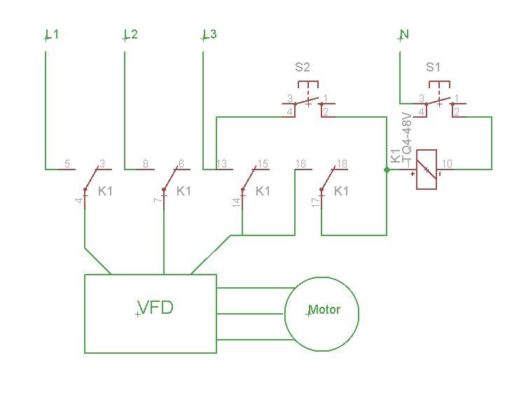

The stock contactor was always noisy, hummm, buzzzz, you get the picture, so out it went, and here is the wiring diagram for the standard 4 pole contactor I replaced it with.
I am sensitive to sound. here is the wiring diagram of the new contactor:

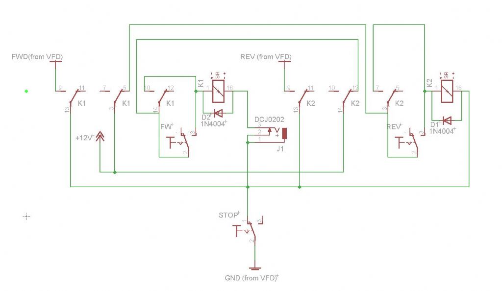

The box with stop, fwd. and rev. buttons contains some relay logic, to keep the VFD turned on by a press on a button, and also disable the opposite button.
It also contains the option of adding an external stop switch, which can come in handy, when threading into a bottom hole.
The wiring diagram is here:

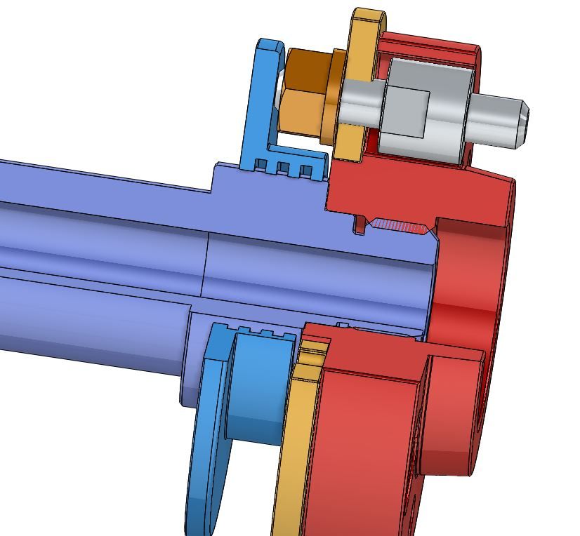

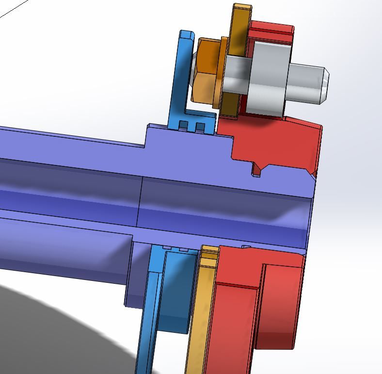

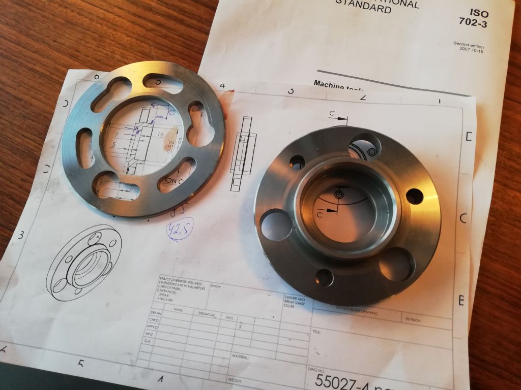

There is one decision coming up rapidly now, choise of spindle nose.
If I keep the stock 1-1/2"x 8 TPI nose, I will have to machine 3 backplates for the tooling I intend to purchase: a 160mm scroll chusk, a 200mm 4jaw independent chuck and a faceplate. (the latter will be waterjet cut and mounted on a ready made adapter plate for the spindle nose of my choise, the ISO 902-3/DIN 55027. I bought the standard PDF.
My main concern here is the extra added overhang that will inevitable be the result of this setup.
If I turn the adaptor according to the standard, this will be the outcome, and I even have to trim the labyrinth faceplate to make way for the 3 nuts:
I don't feel too comfortable with adding almost 25mm of extra overhang, so I propose to slim the adapter slightly:
The flange is 20mm thick, which seems reasonable on a spindle with a 40mm bore, but the Boxford is tiny in that conparison, so I will trim 8 mm off the flange, to make it 12mm thich
The bayonet plate is 6mm, I will make it 5mm instead.
Lastly, by trimming the nuts down to 8mm length instead of the original 12, I will reduce the extra added overhang by 13mm.
I am not at all sure this will matter, seems like I am rapidly entering the territory af the diminishing returns, I will see what you guys have to say about this.

Did you notice that in the 'lathe improvements' thread Niels was initially thinking of modifications to a Boxford spindle?
old mart27/11/2020 20:01:54
4655 forum posts
304 photos
There may be more than one drawback to changing the standard backplate for your ISO/DIN adaptor. When you produce the 1 1/2" register and thread in the adaptor and fit it to the spindle, the front will require machining to get it to run true. All backplates fitted to threaded spindles are machined in situ. The only advantage of your adaptor that I can see is being able during assembly, to provide a positive locking to the thread to ensure the lathe is safe to use in reverse. The locking could be permanent as long as it did not interfere with removal of the spindle from the headstock.
160MM chucks are much bigger than 5" / 125mm chucks, in weight as well as length. There will be a sacrifice in overall length between centres as well as a small stiffness loss.

Boxford? Screwed-on chuck? You are going to arrest the spindle from high speed, to rest, in a 1/4 second? I do hope you have nothing screwed to the spindle, or it may well unscrew in about the same time, or less. Wear your toe-tectors and don’t stand in line with the workpiece/chuck is my advice if you try that trick too often!
Seriously - don’t do it. It is dangerous.

I thank you for your safety considerations regarding the possible unscrewing of the chuck while reversing the spindle, or by simply bringing it to an abrupt stop.
And please excuse me for not stating the obvious: That the DIN 55027 adapter will of course be secured to the spindle with locktite.
Old Mart:
You say that the 160mm scroll chuck is much bigger in length.
Hardly, I would say: The standard P&B 130mm chuck measures 76mm from backplate seating face to the front face of the chuck, whereas the total length of the Zentra chuck I am going to buy is only 68 mm. This places the front face of both options on the same line, therefore no recuction in stiffness .

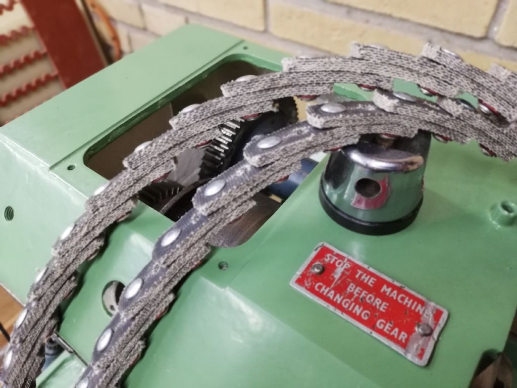

The belt that I have is a disaster, however:
This belt keeps getting longer by the minute, and I wonder what you guys do, it is a hard job to join it inside the motor cage of the support, and I have to take links out all the time. No option to tighten it either.
What do you guys do????

AJAX05/01/2021 23:10:24
433 forum posts
42 photos
You can buy those link belts on eBay - no need to purchase 7.6m
They cost about £18 per metre.
I bought some for my Denford lathe and they work just fine.
Alan Charleston06/01/2021 05:16:27
157 forum posts
26 photos
Hi Finn,
I bought a new T Link drive belt when I restored my AUD from here:
http://www.lathes.co.uk/page4.html
Tony quotes 60 pounds for a 1.4 meter length which is required for a Boxford. This seems a lot more expensive than the 18 pounds/meter from eBay but on the other hand, mine hasn't stretched since I put it in a couple of years ago.

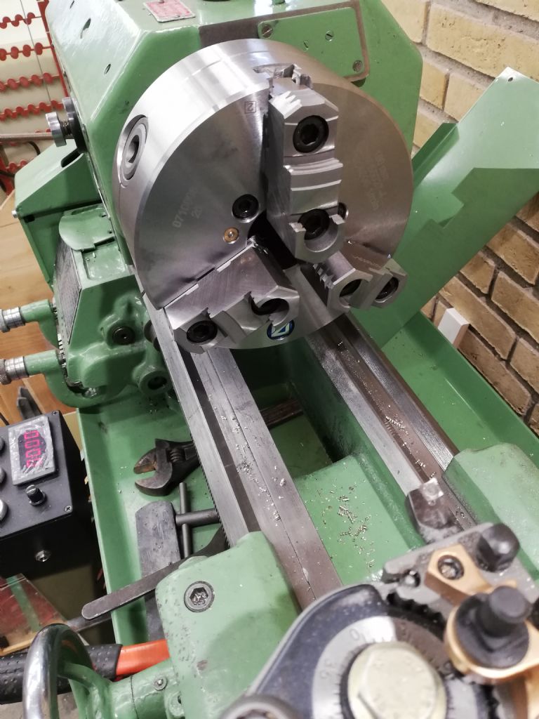

Since the steel I made the nose off is already much harder than the steel the scroll chucks are made of, I decided to cansel the hardening and grinding, and instead rely on a turned finish.
Not bad at all, the nose is now turned in situ, and thus there is no runout at all.

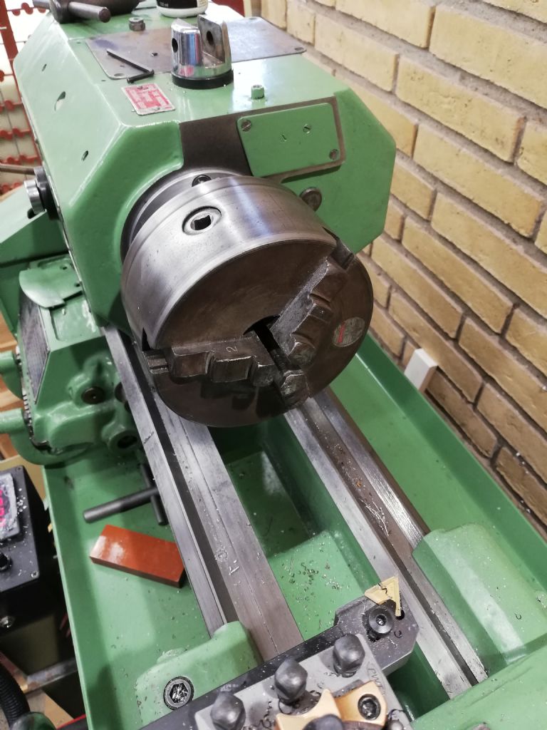

What you will see here is a Boxford that thinks it is a Weiler, which is very far from reality, so I guess it is a very sad thing indeed, but I am happy, so who cares.
Image with the old Pratt and Burnered 130mm chuck:
Not a pretty sight
here is the new DIN55027 short taper nose
and here is the new Zentra 160mm chuck in place
I like this, because it gives me the opportunity to quickly change from 3 jaw to 4 jaw to faceplate, as I originally intended.
Cheers, Finn Hammer
