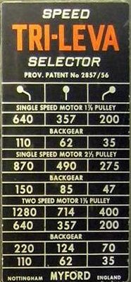

Wonder if anyone could point me at a source for a fair image (or actual artwork) of the speed selector decal on the front of a Tri-Leva unit. Trying to eliminate the 'void' on the front of latest toy. Images from internet are all slightly skewed so aren't really ideal for print. I am trying to avoid having to recreate artwork if I can.

If you can get a high resolution photo then it can be corrected for lens distortion and perspective in a bitmap manipulation program such as Paintshop Pro:

tri leva 2.jpgDid a quick mock-up in Coreldraw. If anyone wants a eletronic copy PM me, Coreldraw supports most vector and raster formats. I have been using it since version 2!

Posted by Adam Mara on 13/11/2020 15:46:46:
That is good. I get the feeling that the OP wants a facsimile copy of the original rather than something that has the same information on it.
Is it possible in CD to over- or under-lay the photo above onto your own and adjust fonts, letter proportions and spacing to more closely match the original (e.g. look at the right hand lever - its 'stalk' is between the 'U' and 'L' of pulley)?

For those interested the original decal/label is 55mmx108mm.
The fonts are unknown to me. In the "Speed" & "Selector" words the O has a sort of square aspect - I have no font like that. The remaining text is of a different font again but a few close matches. I imagine that the original artwork probably hails from pre computer composition practices and perhaps no exact typeface match exists.
The colour of the 'Tri_Leva", in the above image, is a sort of orange but from an aggregate of images on the web I would guess its "Myford Red".
Andrew suggested a hires photo - would anyone be in a position to provide same? All I have is a black rectangle and images from every angle but dead on - from the internet. I have put about 2 hours into the 'Tri_Leva' logo part so it looks like this so its going to be a long slog.
As DC31k says I aiming for a facsimile as otherwise I'm doomed to eternal wandering in search of ..... on the other hand never mind.

This thread on Myford fonts might make interesting reading for you, particularly the comments by Nick Clarke 3:
https://www.model-engineer.co.uk/forums/postings.asp?th=157921
To make a facsimile copy is very time consuming. I would estimate 8+ hours for the above.
I have had most success importing the photo (the deskewed one above is more than adequate) into a CAD (Turbo-, Auto-, Intelli-, etc.) program and drawing each letter individually.
On this plate, it is quite good as each digit only needs drawing once, there is a lot of duplication of 'speed', 'motor' and 'pulley', and 'speed' 'selector' at the top share a lot of common letters.
