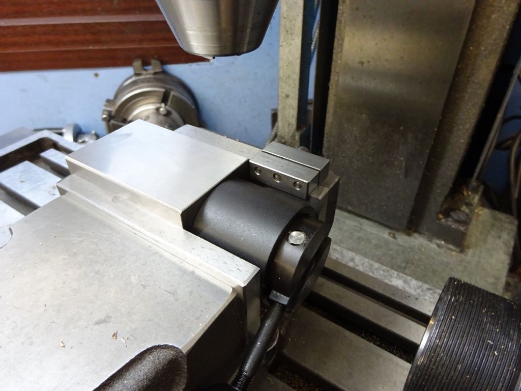

Clive, don't you have any vice stops
As for a spin indexer I use the Stevenson one with it's 5C to ER32 converter and special nut. Or you can just put a standard 5C to ER32 converter into any 5C tooling

The VJ400 vices I use don't really suit simple vice stops. Also jaw overhang from the sides of the base is 3/4" or so which is perhaps more than ideal when you need to get the block re-seated really flat. Something like your bottom picture would work OK but I just don't use the collet blocks enough. A flat magnet about 2 x 1 x 3/16 inches does similar duties well enough when needed.
